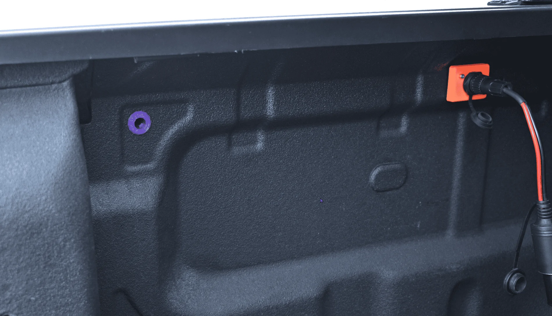

So, here's what I've been up to...
With the help of my brother, we've been working on a 3D printed insert for that hole that will allow you to use a standard 12MM "Anti Vandal" switch without having to deal with anything "behind" the wall of the bed. (E.g. APIELE (Pcs of 2) 12mm Latching Push Button Switch High Round Head Stainless Steel 1 Normally Open with Ring Led (Blue): Amazon.com: Industrial & Scientific )
On that note, the 16MM switches MAY fit if you don't have any spray in bedliner, and even then you might need to slightly enlarge the hole. The 12mm is way too small, when used by itself.

Any update to this project? I’m really looking forward to a plug and play solution for bed lights.
Slowly. The switch adapter is pretty good now, and takes any "long" 12mm pushbutton style switch (the anti vandal type). Working on the LED adapters, and those should take any 11mm bolt style LED.
