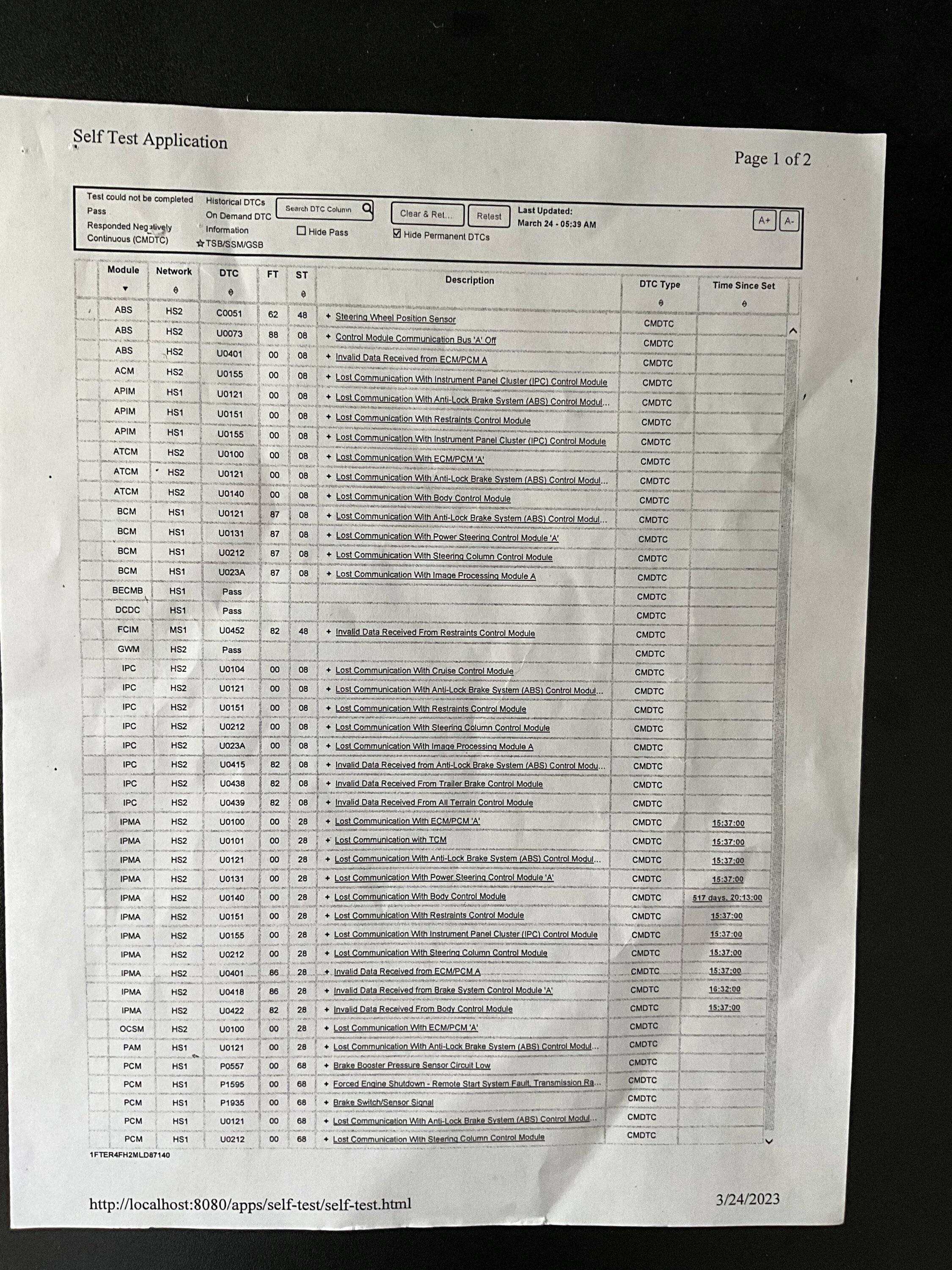

And 99% are communication codesthats a long list of codes lol

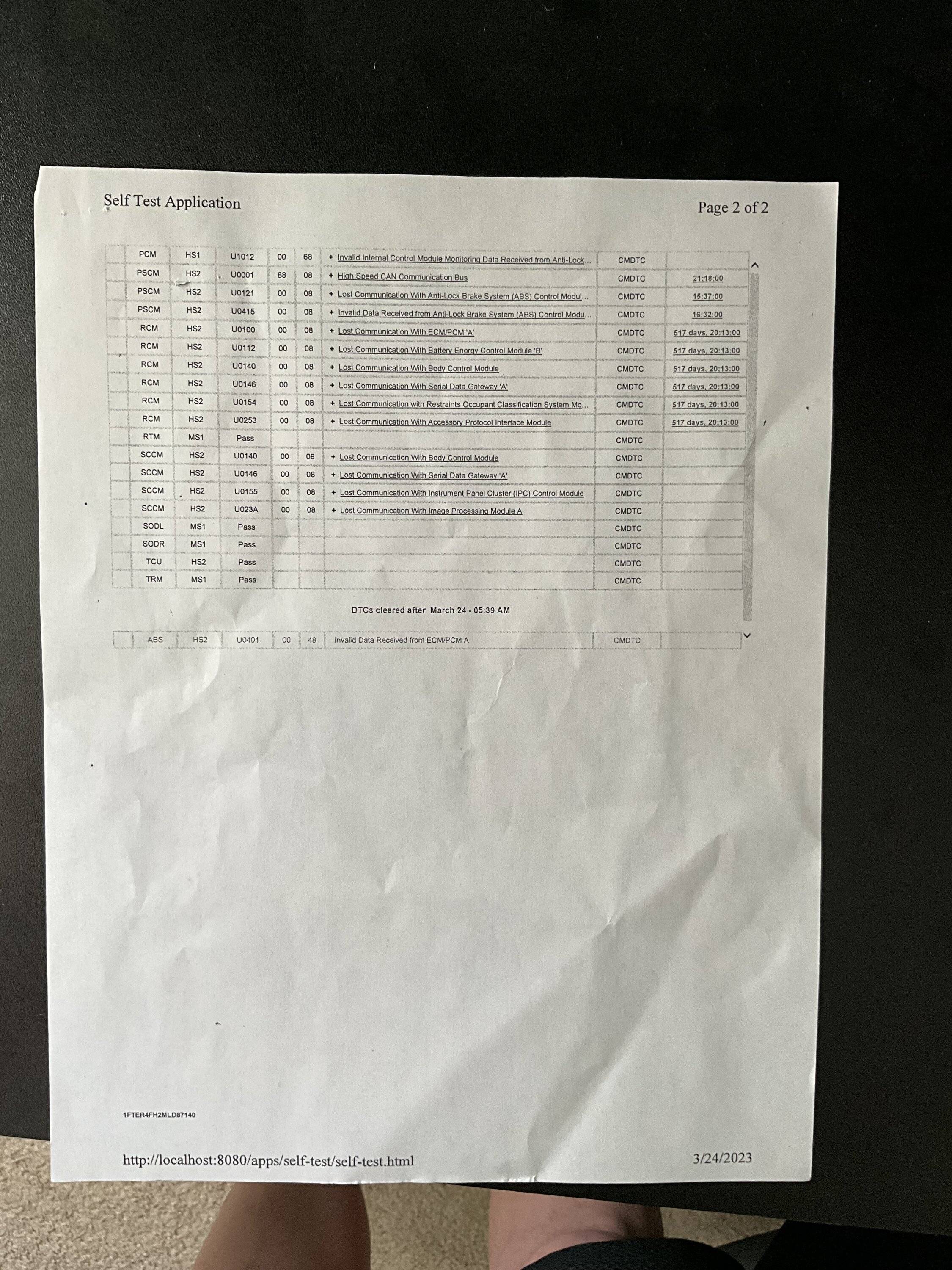

Codes as requested
Just curious why you think it can't be fixed? It's a network issue and I'm betting there is only one real problem causing OP's issue. The problem is going to be able to find a Tech that knows how to trouble shoot these kind of problems.You know you HAVE TO get rid of that truck. It will NEVER be right, reliable. Sorry to say.
THIS - 1000% this - You just need a good diagnostic tech and I'm almost positive all the issues will go away. It is probably something REALLY stupid and REALLY cheap to fix I'll bet.Just curious why you think it can't be fixed? It's a network issue and I'm betting there is only one real problem causing OP's issue. The problem is going to be able to find a Tech that knows how to trouble shoot these kind of problems.
OP ask Ford if you found someone who specializes in automotive network diag if they would refund you the money since your under warranty still. It's fixable your just going to need a tech with the knowledge for these kind of problems.
TOTALLY agree. Another appropriate use of caps lock.THIS - 1000% this - You just need a good diagnostic tech and I'm almost positive all the issues will go away. It is probably something REALLY stupid and REALLY cheap to fix I'll bet.

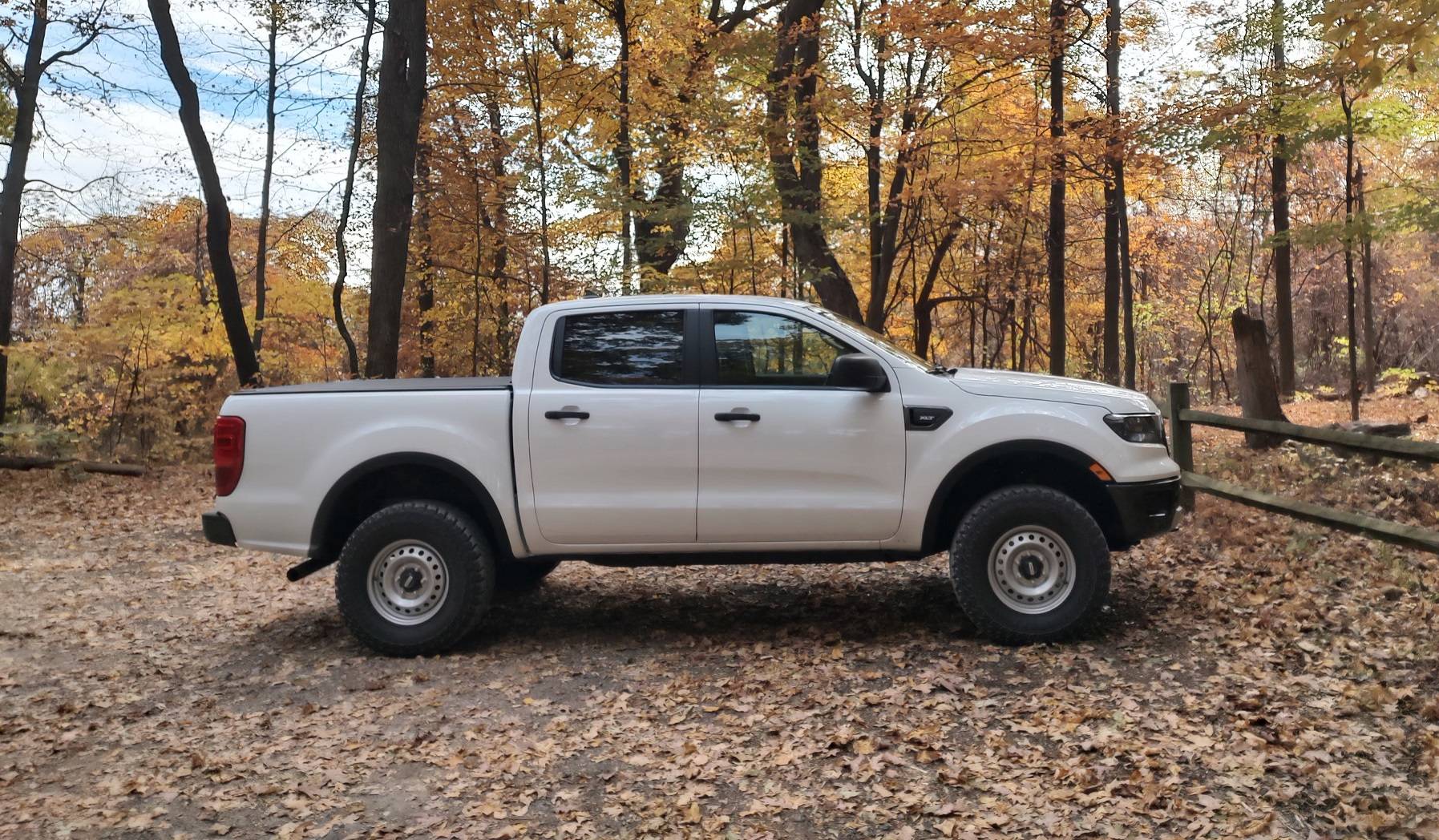

Truck is all stock short of a LED tremor 4 light grill bar I bought from stage 3.
