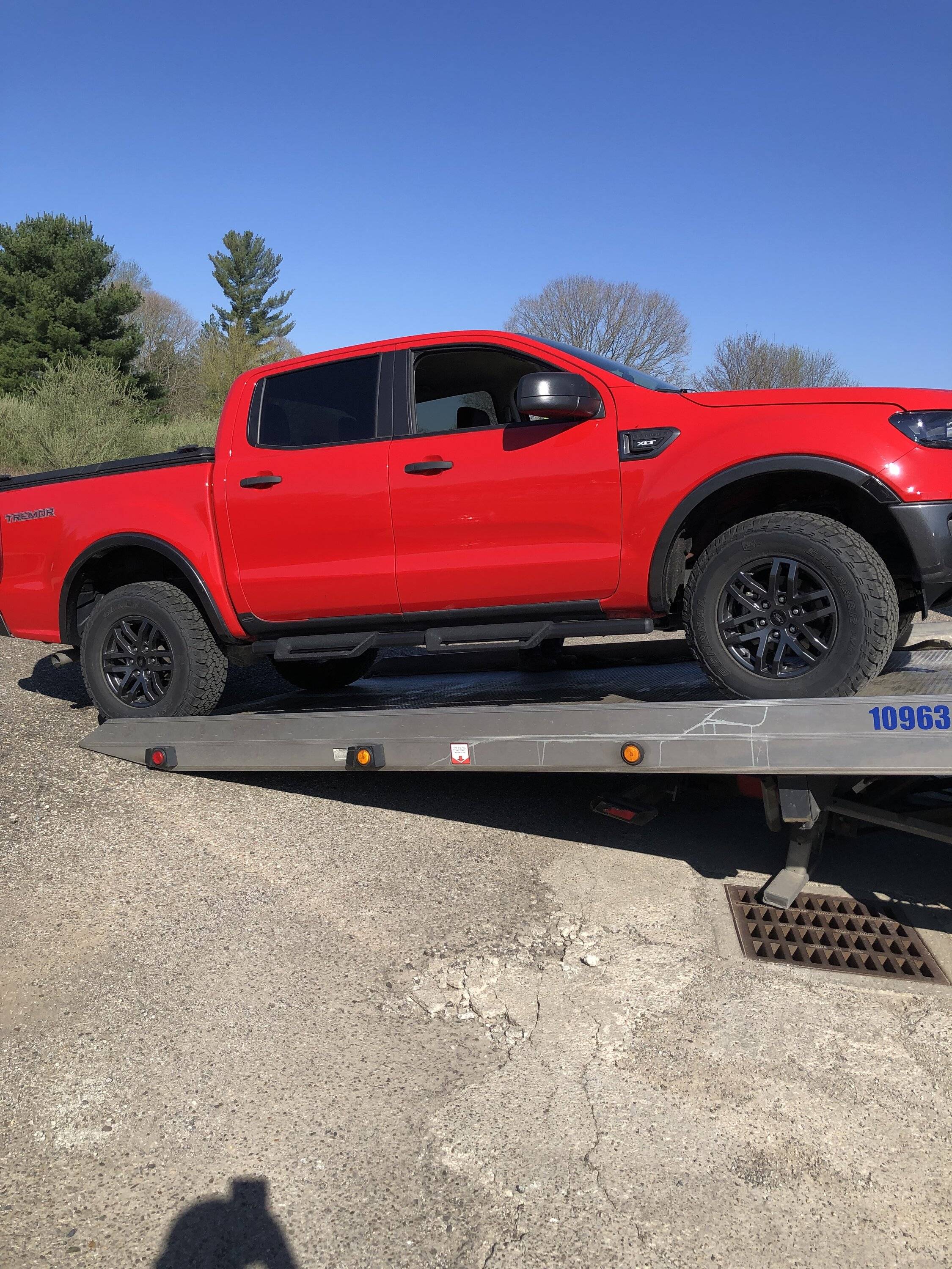

So for 2 days it would not start with the key or remote (key fob)
This morning it started with the key fob, key turn to run and then shift the transmission and it died numerous times.
Would not start with the key, just the key fob.
Had it hauled out
ppfd
Mar 1, 2021
721
1,603
WV
2021 Tremor
RN/Paramedic
Me and the tow operator were cranking the hell out of it. Maybe I'll get a new battery this time
Now to see if I can get a loaner car. Enough's enough
