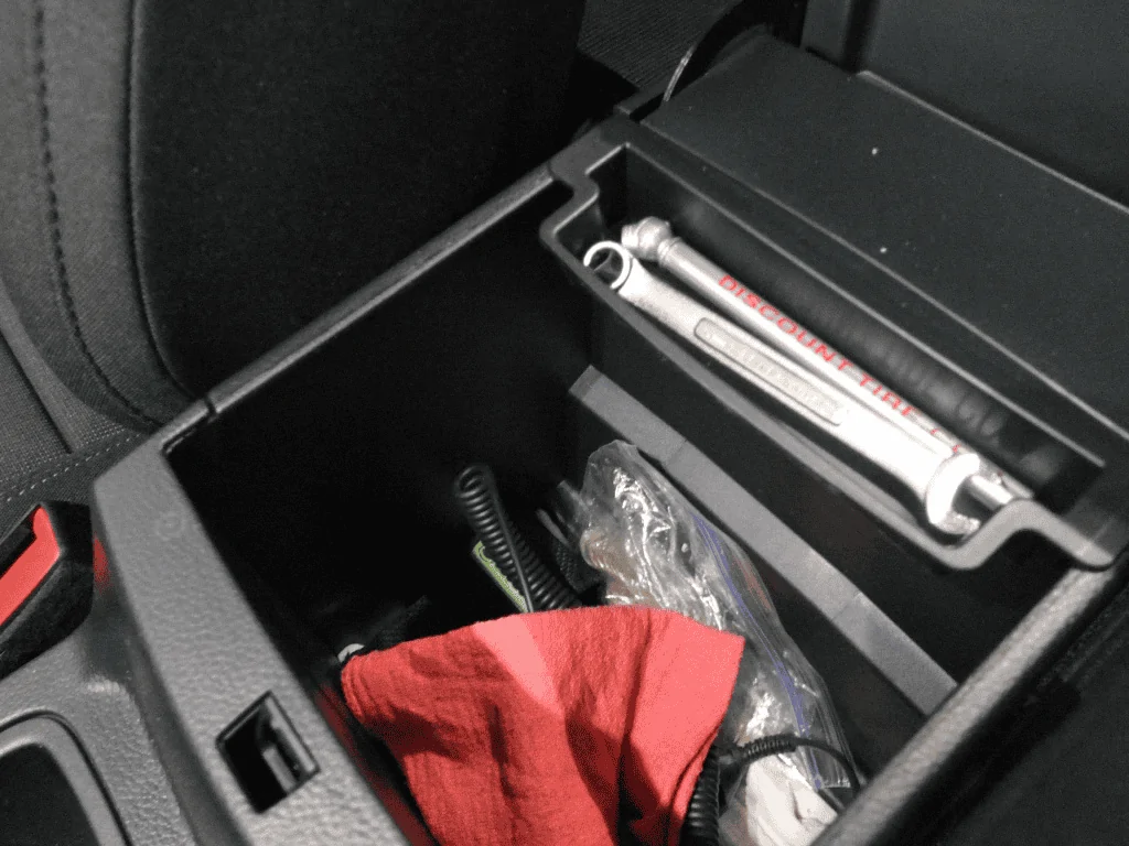

Based on others having this same thing happen ^^^^ I carry a 10 mm wrench in my console.
If this happens, pop the hood, take the wrench and unhook the negative battery cable. Wait a couple minutes then hook it back up.
It's like rebooting your laptop computer when it does stupid shit... so to say.
