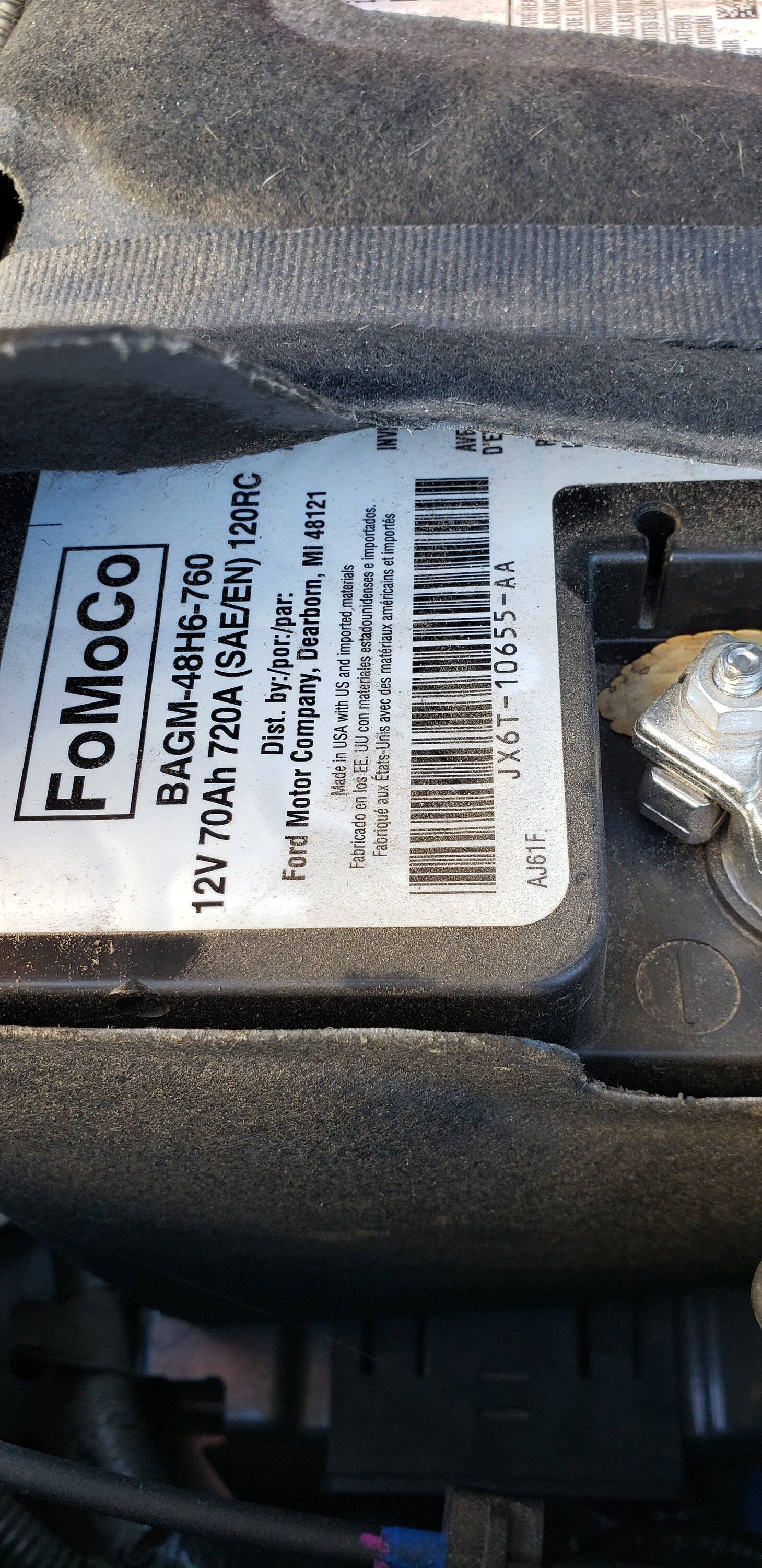

Anyone know the CCA of the stock battery? I went to get it tested at an auto parts store and they had two different battery options for the 2019 ranger. Couldn't find CCA on the battery. Photo below.
Just replaced mine and they should be 760 or 800, the higher capacity is for the Lariat, would advise getting that one. Yours is showing as the 760.

Will the lariat battery fit and work in the xlt? I'm assuming it would. Always a fan of having a larger battery if I can, especially knowing it doesn't get charged to 100%
Yes what I have seen the H6 and H7 are the same size. You will see different cca ratings on different brands Motorcraft generally being lower.
