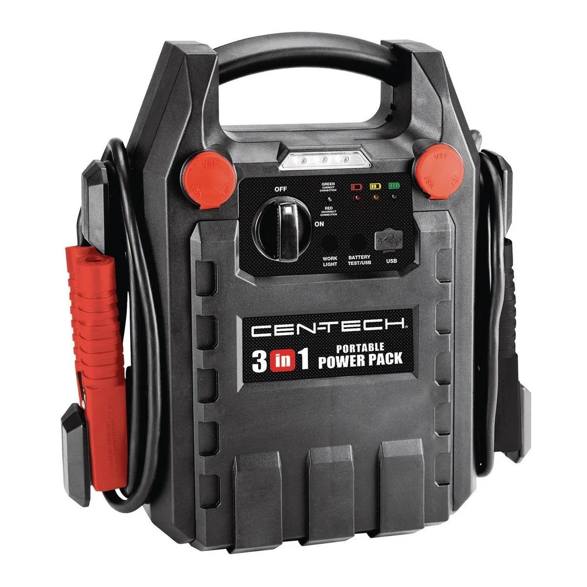

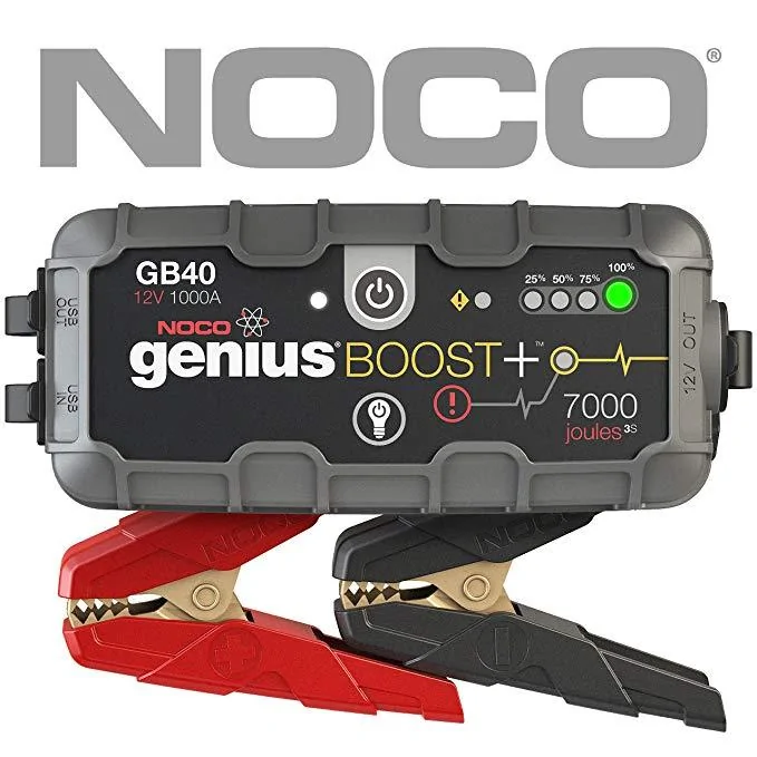

Never leave home without this...small price for great insurance...always in my truck...

I have the Harbor Freight version of this. I was a little skeptical at first but I've used it probably 3 times in the last year and loaned it out and it works every time. Very convenient very handy very small. I'd recommend one. A little pricey but worth it. I think I paid around $60. On sale.

I have the same NOCO stored under the rear seat. :)

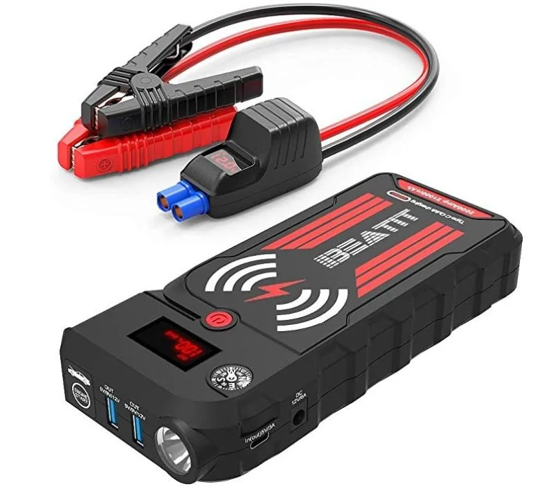

I got this one from Amazon. I like the built in volt meter, USB ports, flashlight, and wireless phone charging. It even has a compass which I hope I will never need. I've only used it once so I can't say it is better than any of the others on the market. I am surprised that something so small can jump start a vehicle with a dead battery. I also have one of the monster ones that seem to weigh a ton that I got at Harbor Freight. I bought the big one before I saw someone use the smaller version and was blown away that it worked so well.
