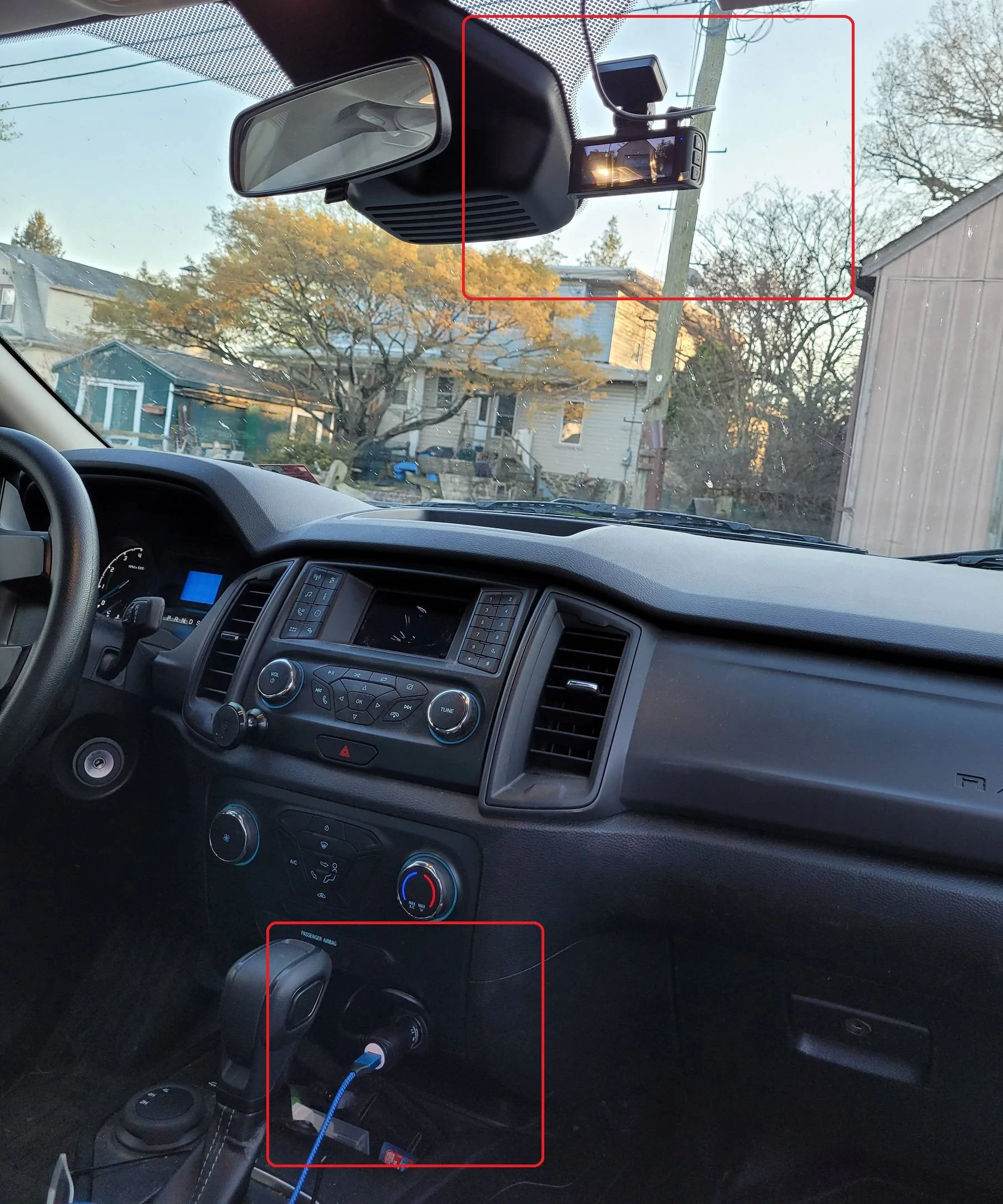

Little late but this is what it looks like. I ran the power along the pass-side A pillar, behind the glove box and poked a hole out by the 12v supply.
That s where I was hoping so wouldn't obstruct my view. Should be here end of the week. Thanks of rite picture that really clarifies.

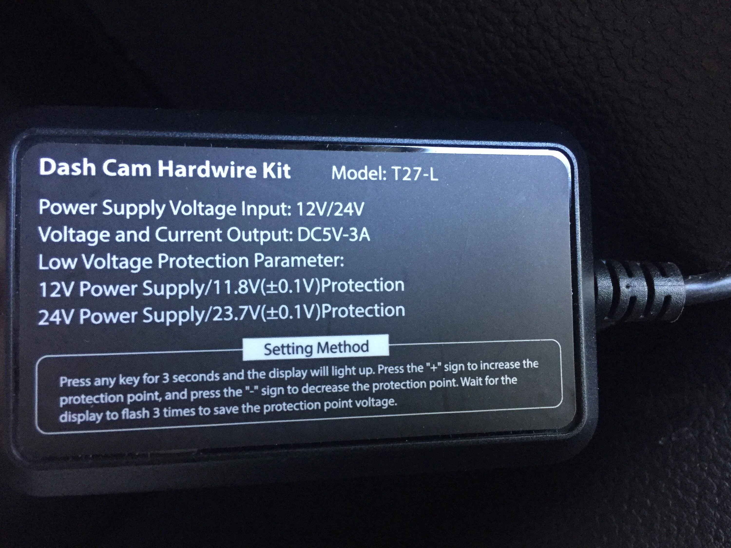

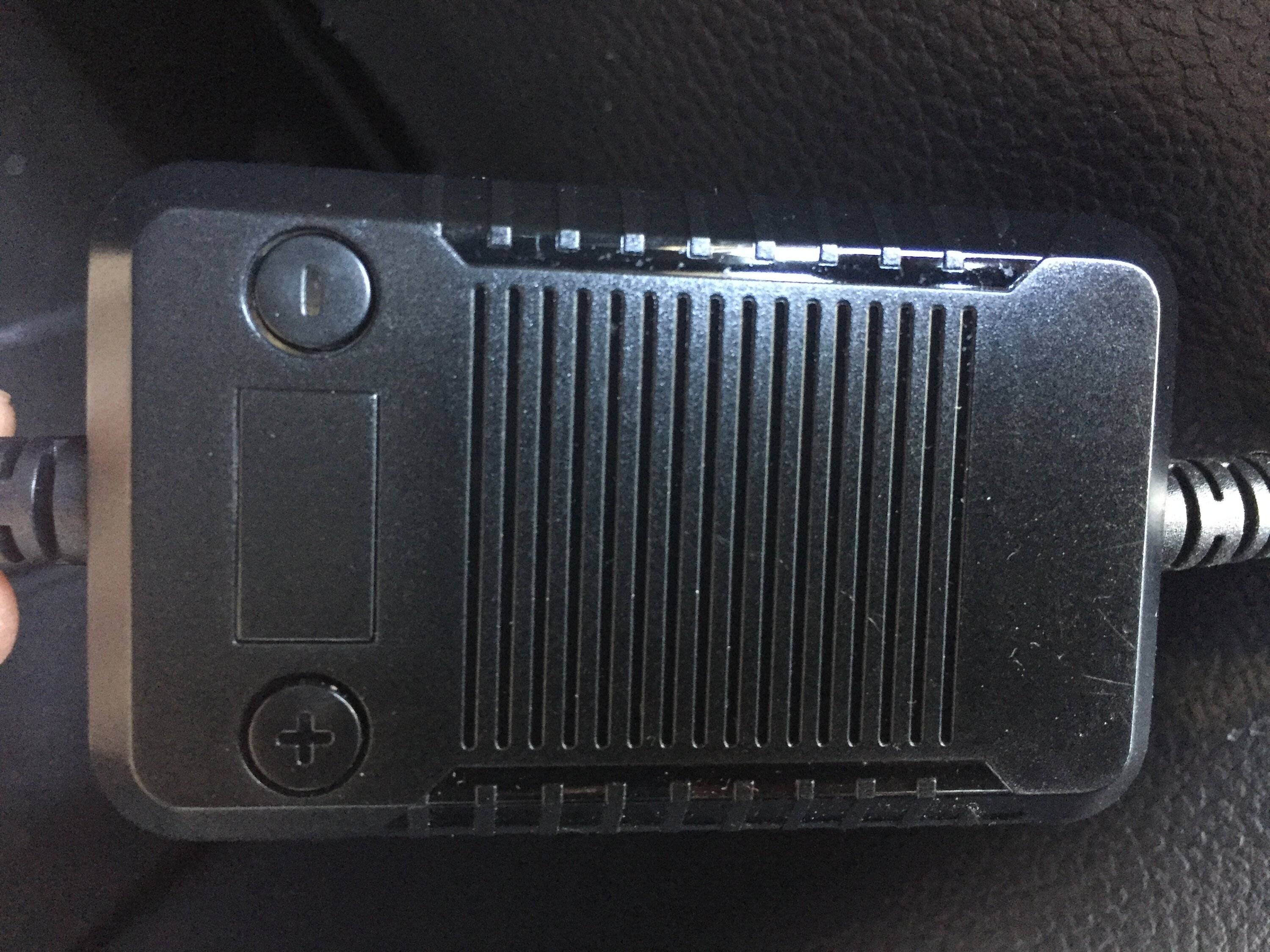

Anyone made adjustment on the G850's voltage protection point module? What "any keys" are they referring to? I've asked Wolfbox but they don't know what I'm asking...
That's where my Garmin is mounted too...
I'm late on this reply - I also have a standard mirror, so no tapping any power up there (I also have the 4" unProductivity screen).
Were you able to just shove the wiring in or did you have to fully remove the pillar trim? I'm worried about busting clips ...
I'm also thinking of a longer cable so I can connect to my Scab's behind-the-center-console 12V (no one rides back there and it's fully covered by my dog's bed - not that he has the good life or anything!). And maybe also have a rear cam.
Any advice is greatly appreciated (especially from a fellow Scab Ranger!). =)
I unscrewed the 'ohh shit' handle on the pass-side and removed the A-pillar trim. Went back together fine. Ran the wire behind the glove box and out the back of the 12v power connectors.
