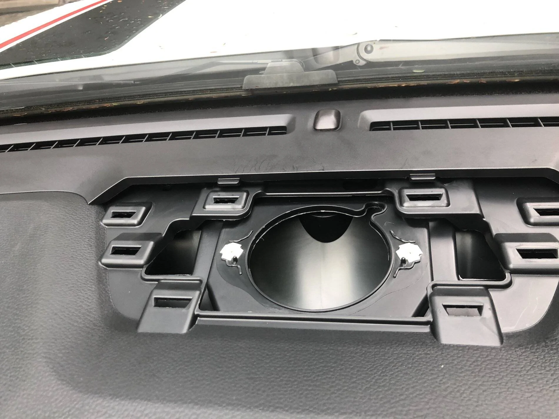

Looking at the spot where the speakers go, i think it would be possible to fabricate something to hold two speakers. Would have to cut out where the speaker is supposed to mount

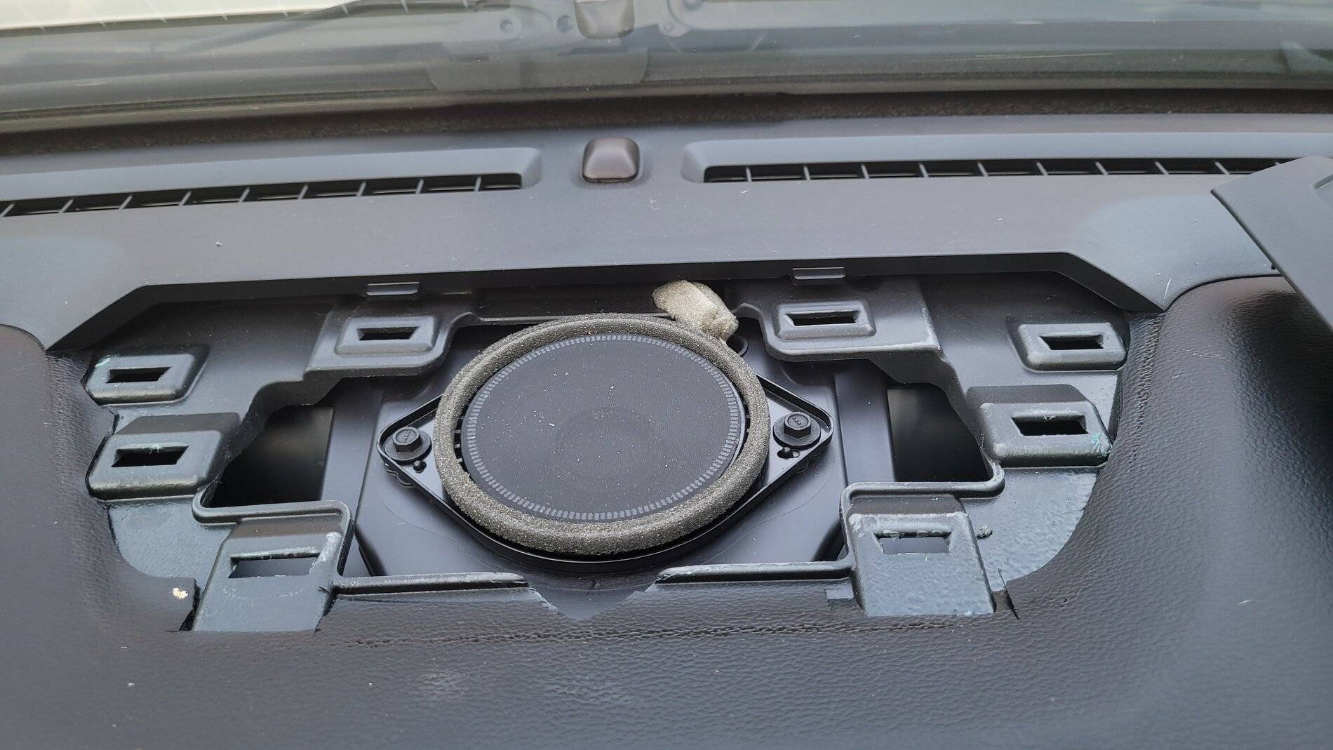

I have the B&O, that's the stock speaker. I have some SI M3 Carbons, I plan on putting one in at some point.

I installed dash speaker today. Used 1 infinity speaker as recommended. Put Dynamat under speaker. Pulled dash tray out. Ran speaker wire forward to tray then down. Lowered glove box like changing cabin filter. Pulled rug and side panel. Unplugged plug going into door. Looked up wire colors On chart that is posted earlier in thread. Orange/yellow is positive. Green and brown is right next to orange/yellow. Skinned wires are soldered. well worth the effort. XLT has no amp. Truck has navigation.

No it has its own screw holes located in dash. Grill is stand alone function only.
I pulled the cover out and see the place on my XLT to put speaker. But need the 2 bolts to attach does anyone have the Ford part # for screws/bolt required? I checked diagrams and cannot locate one.
7,256
44,328
Living The Dream
It looks like those are the plastic retainers designed for self-tapping screws.
If so, any sufficient gauge sheetmetal screw at Home Depot/Tractor Supply will work fine.

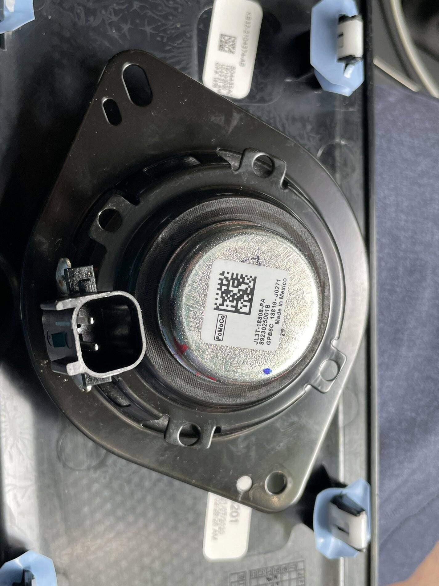

Does anyone know how to attach the speaker cable to the factory speaker? XLT didn't have speaker harness in place.
BladeRanger
Bladimir
May 16, 2020
907
2,262
Escondido Ca
Ranger 2020 XLT FX4
Electronic Engineer
Does the Radio has a plug in for center channel speaker? You might be able to find a mating connector on Amazon.
