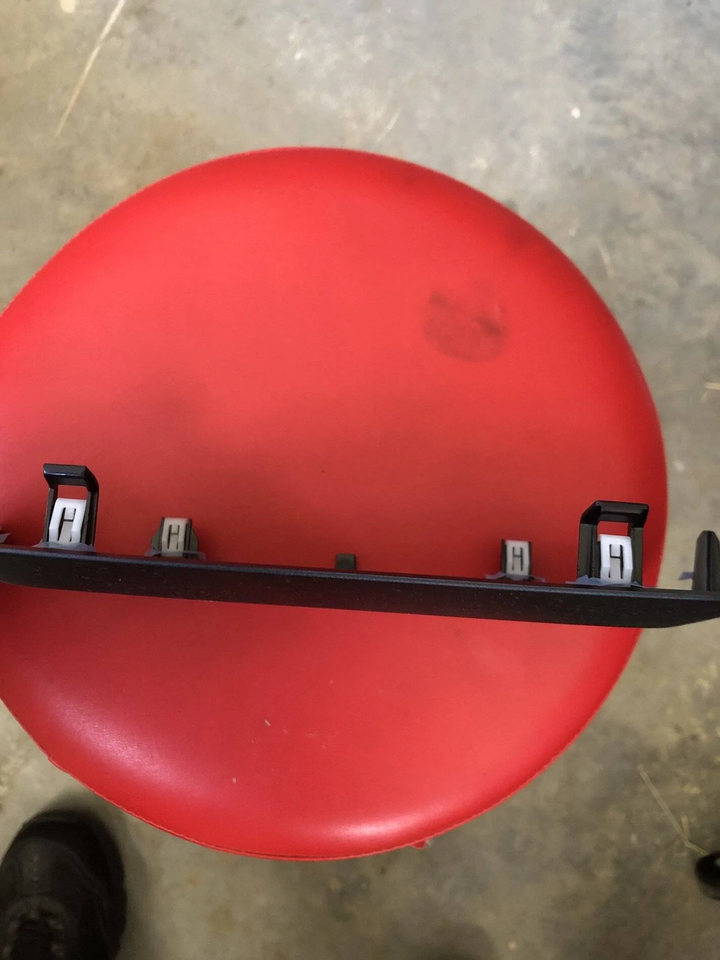

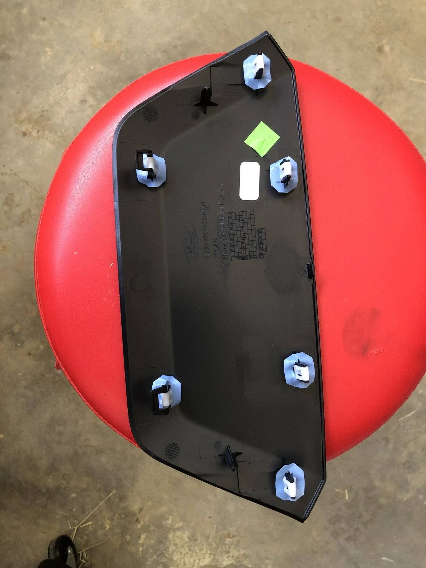

How is it fastened? How do you get it out? Does the new one come with required fasteners?

held in place by clips, new one comes with clips attached for easy swap.
