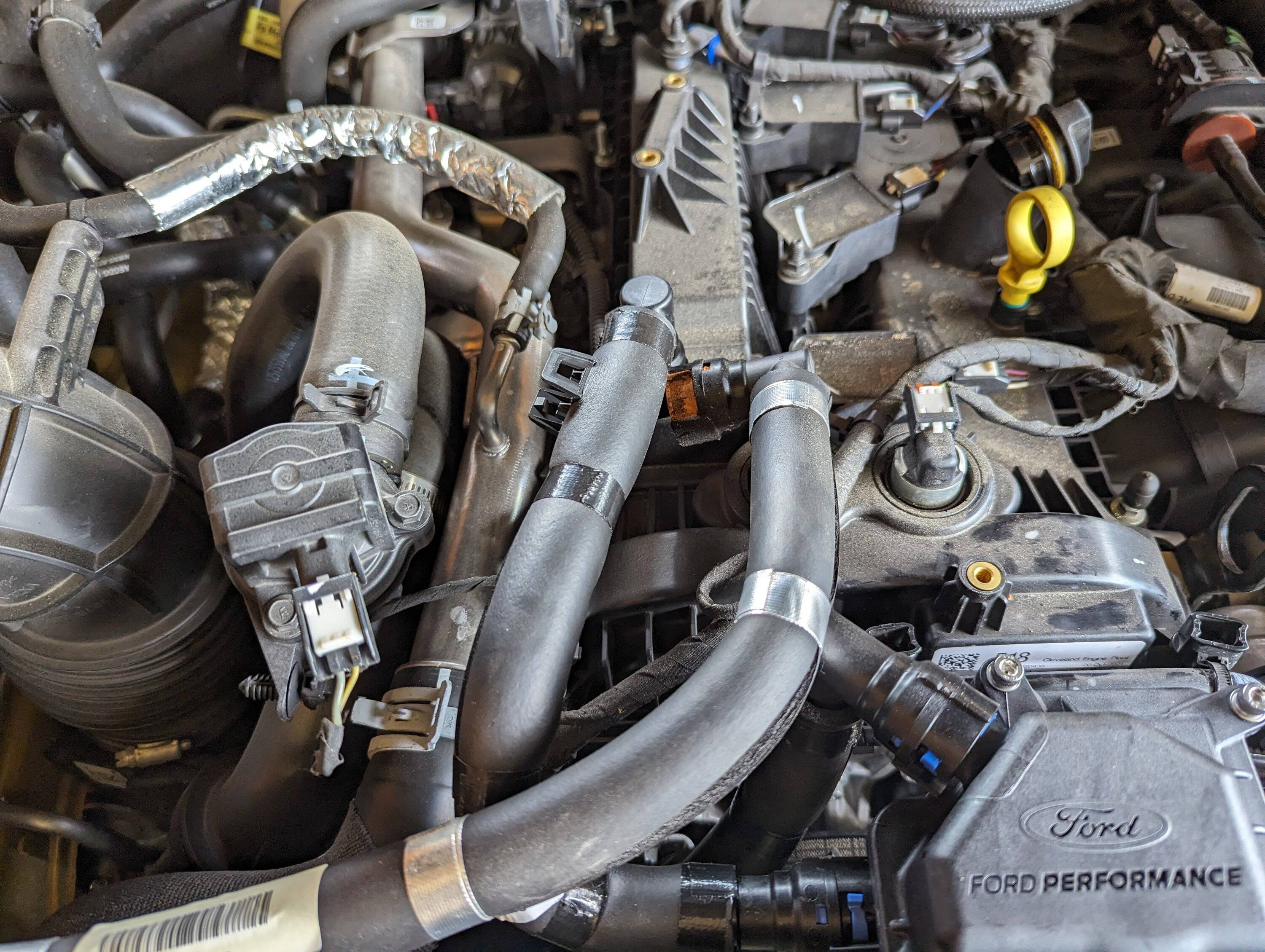

Fuuuuuuudge. I ordered the kit, for 2019-2023 Ranger (as listed on CJ Pony, an authorized FP dealer), the VC to catch can hose is wrong, guess when I noticed.... of course after braking the clips on the old hose. I guess the 2019 Ranger was the only year to have a sensor on the PCV hose (add that to the deleted parts list?). So, Ranger is offline until I get the right hose, or that 2019 sensor to fill the hole in my hose.

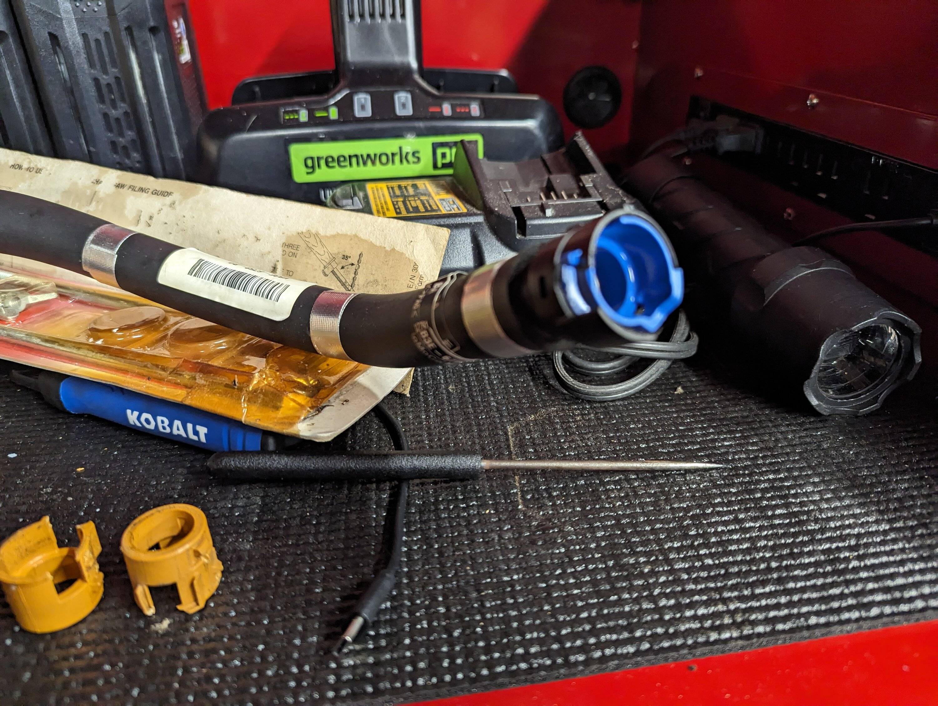

Well, I need my truck and got to really looking at those PCV hose ends, the only difference I could see was the orange one time use clips and the blue reusable clips. Well, those clips can be extracted and swapped. so now I have a reusable OE PCV hose. The Thunder rolls again!!

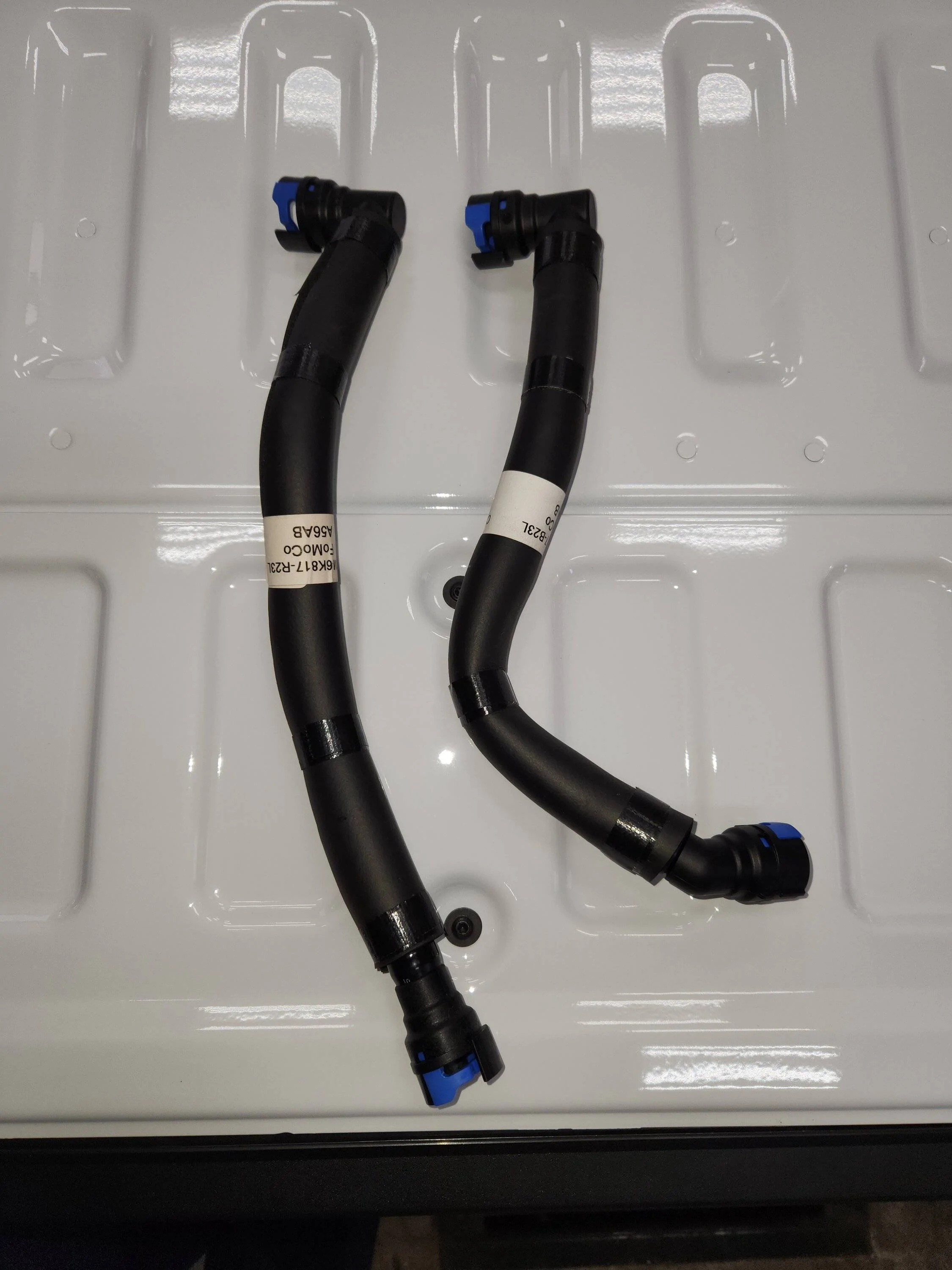

Purchased the B23 kit for my '22 Ranger. Found that the supplied hose, CM-6K817-B23L inlet, was not going to make it.
After going through photos of both kits, realized the CM-6K817-R23L inlet from the '19 Ranger kit would be needed. Contacted FP and the send it out. Received yesterday and it fit like a glove.
luckily I was able to twist the connectors and manipulate hose enough to connect (very tight stretch) and could use until the correct part came. I had the Orange connection both sides of original, so no re use there.
Hopefully the 20+ Ranger kit is updated for not many others to have the issue.
Here's them both side by side.
