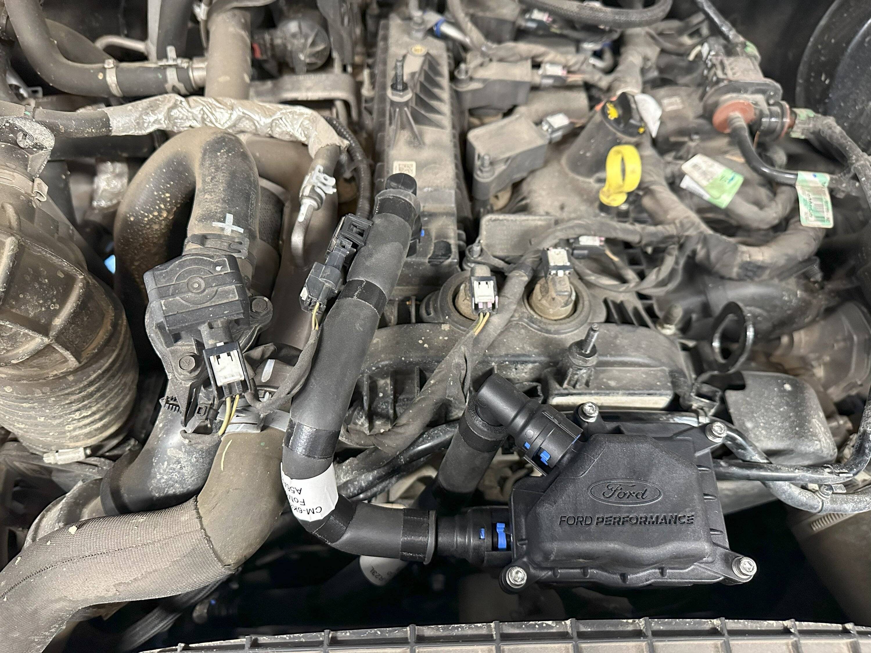

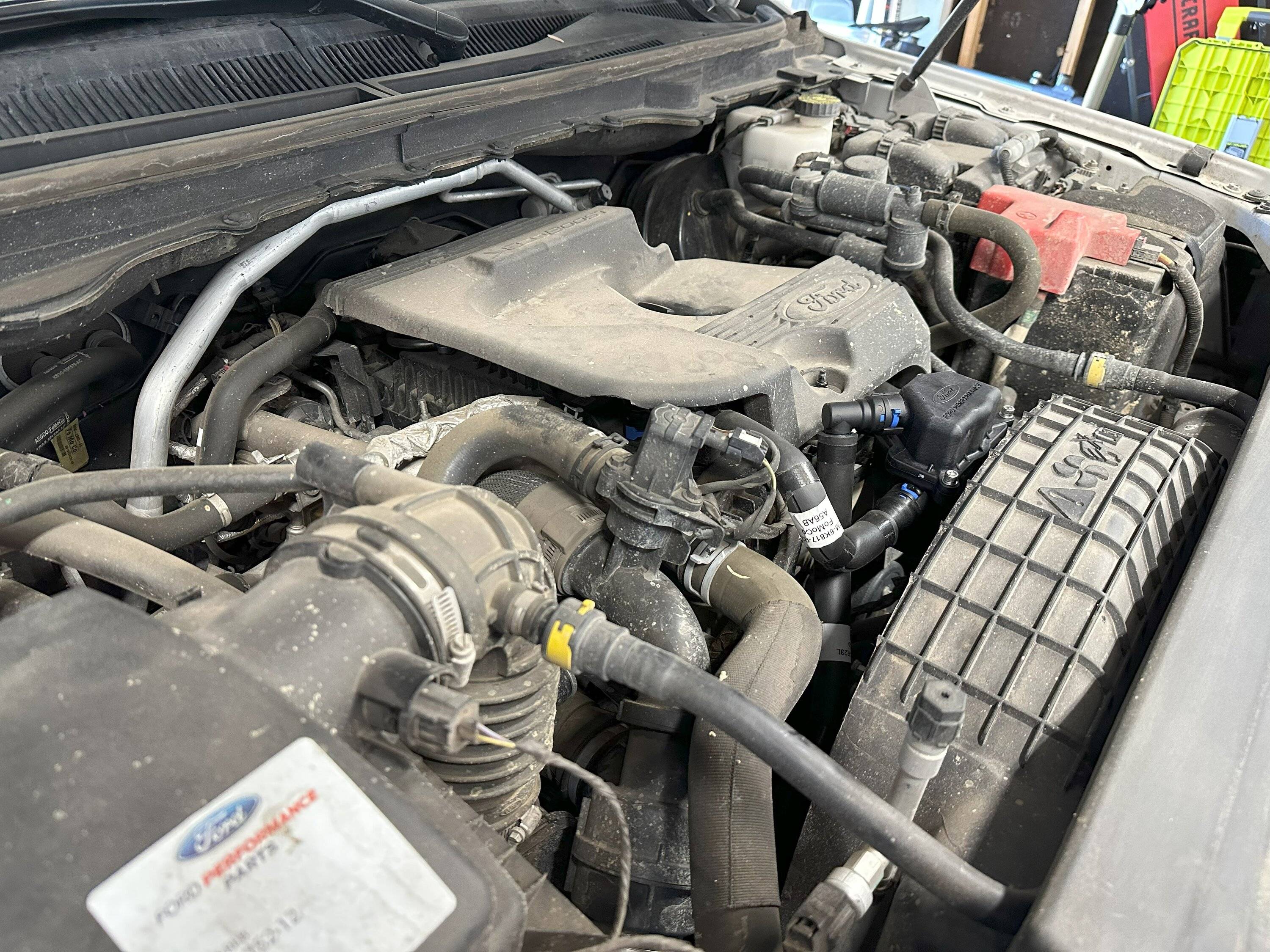

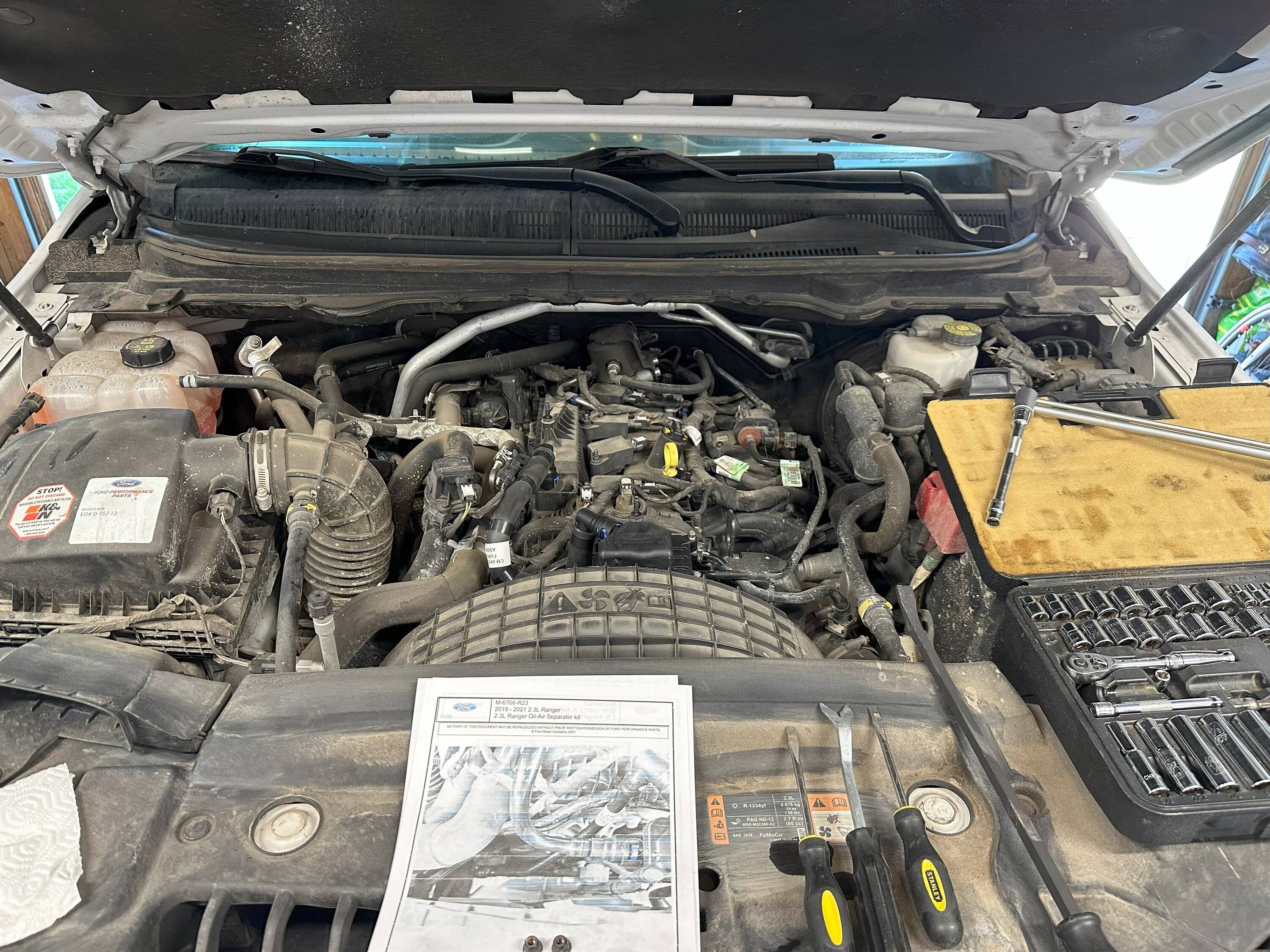

Installed today on my '19, piece of cake really. The hardest part is getting the connection off and back on the relatively floppy intake pipe.

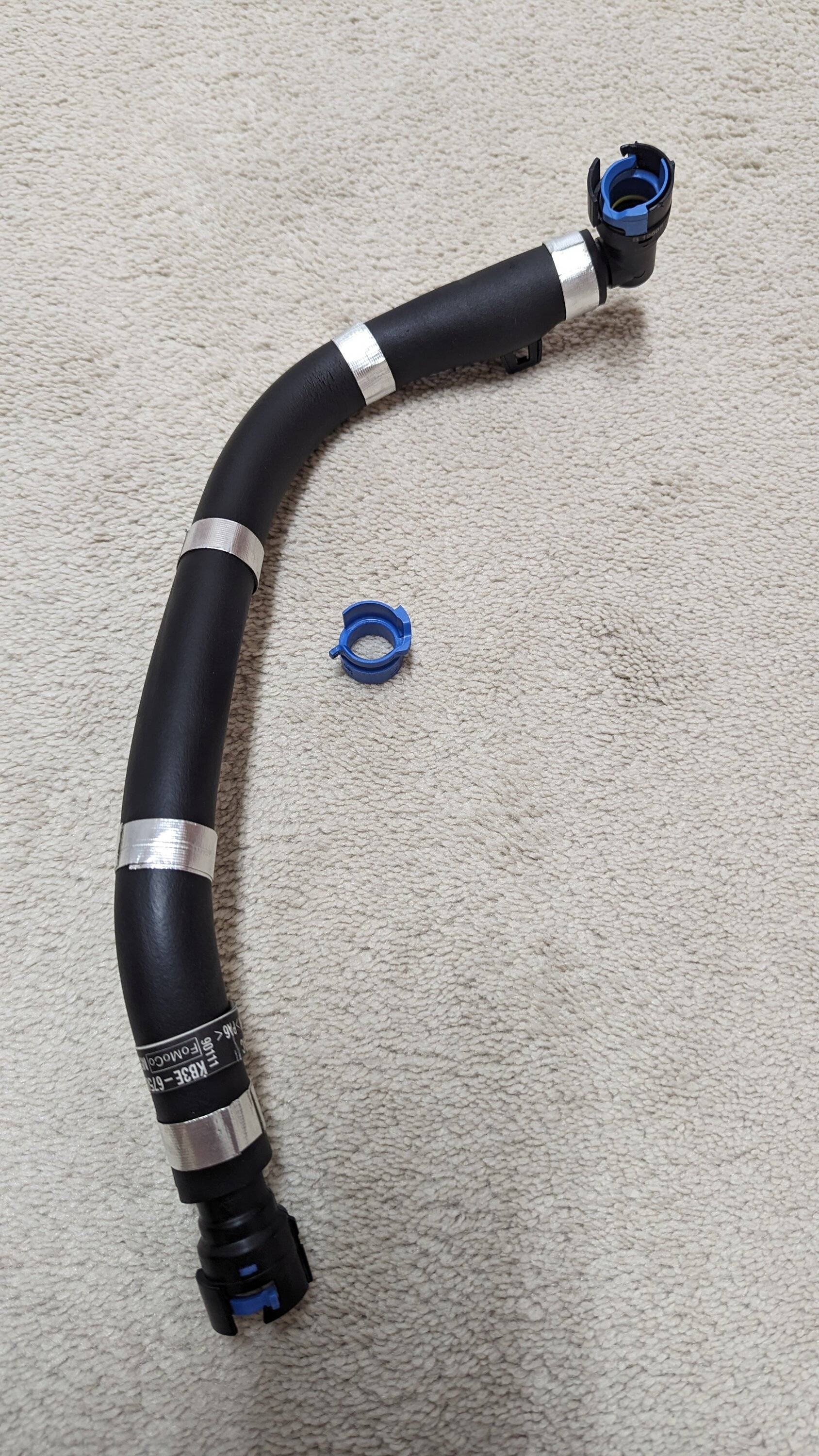

Thanks for posting that. I was about to toss out my OEM PCV hose. I can now save it in case I have to put it back on. No telling if an inspection station will fail my vehicle since the PCV is altered.
Is there a part number for the blue clips, if yes that would be well appreciated, thx
