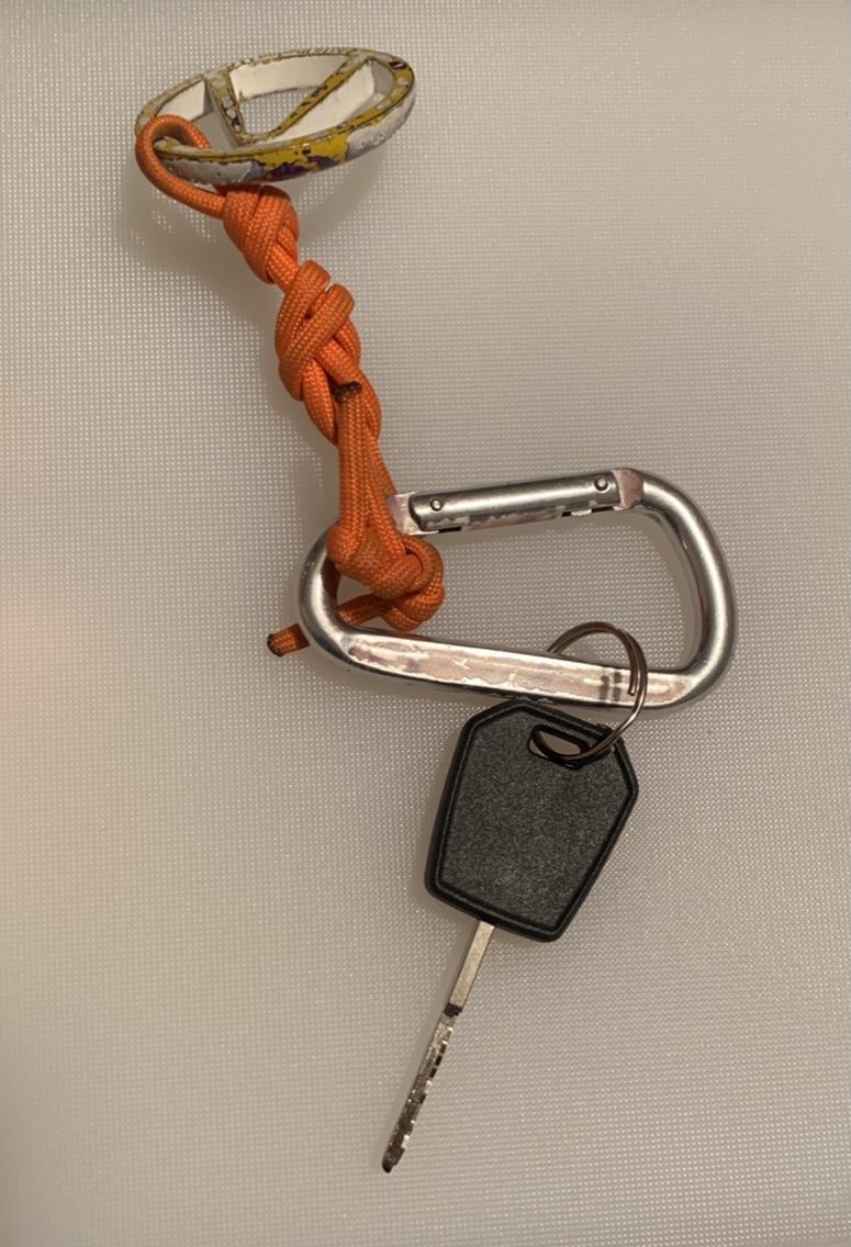

Today, I did it!!!!! TOTAL Cost $27.
Bought Transponder key new (online) for $20, plus tax and shipping.
Walked in an hour before closing asked if they cut keys. They did it for free!
Then they told me how to program. You need both keys came w/ the truck. I have the switch blade style. With the door unlocked, place #1 original key in, turn to on, allow 2 dings.....switch off, pull out. Place #2 O. key in, turn to on, allow 2 dings, switch off, pull out.
Place new key in, same process, then doors lock and unlock by itself, showing new key has been processed.
Boom!

this sounds great. can you tell me more?
where did you buy your key?
who can cut it? (has to be ford dealer, or you can get it done elsewhere?)

I JUST SEARCHED ONLINE FOR FORD TRANSPONDER KEY RANGER 2020, I FOUND A COUPLE DIFFERENT SITES. I BOUGHT SOME OTHER THINGS, SO I CAN'T RECALL THE EXACT SITE I GOT IT FROM. BUT I FOUND IT WITH A GOOGLE SEARCH, THAT'S ALL I CAN REMEMBER. AS FAR AS WHO CAN CUT IT.....TODAY IT WAS MY LOCAL FORD DEALER CLOSE TO MY HOUSE. I ORIGINALLY WENT TO THE FORD DEALER I BOUGHT MY TRK FROM, THAT'S WHERE THEY UPSET ME WITH THEIR RESPONSE. I WENT THERE TRYING TO MAKE A VALET KEY, AND THEY WOULD ONLY ATTEMPT TO SELL ME ON ANOTHER FLIP KEY, WHICH WAS $130 PLUS $80 PROGRAM FEE. I WAS JUST SEARCHING FOR A WAY TO LOCK MY KEYS INSIDE, WHILE I WENT KAYAKING, THEN I COULD OPEN IT UP AND GET THE REAL KEY, SO I DIDN'T EVEN CARE ABOUT IT GETTING PROGRAMMED. ANYWAYS......I SAY TRY ANY LOCAL AUTO DEALER, CLOSE TO YOUR HOUSE, I WAS GOING TO TRY THE LOCAL HONDA DEALER NEXT IF TODAY'S LOCATION COULDN'T DO IT. IN THE PAST, IT WAS $15 TO GET VALLET KEY MADE....PAST MEANING, LAST 2 YEARS. SORRY FOR ALL CAPS, I CAN'T FIND MY GLASSES. OH YEAH, PLS DON'T THINK FORDPASS WILL NEVER LET YOU DOWN. I JUST GOT LUCKY!!!! WENT OUT AT 0730 HRS, APP DIDN'T WORK UNTIL THEY GOT BACK ONLINE AT 0900 HRS.

Hey Moe
I am trying to program my key and cant get it to take. Trying to figure out what is different between my truck and those who have succeeded. Only trend is they don't have remote start and I do. Not sure why that would matter, but Do you have remote start?
