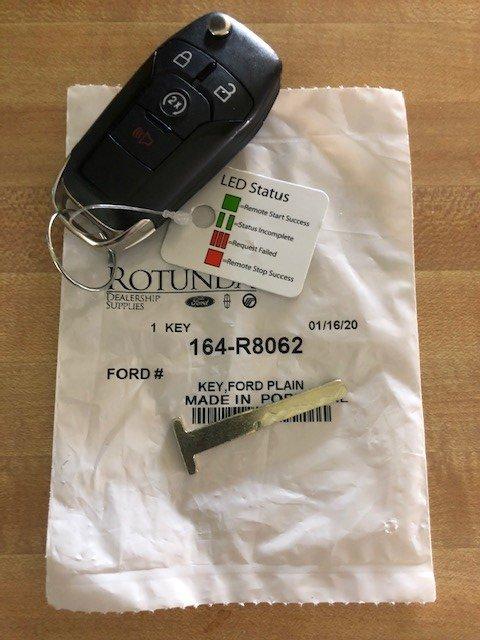

Purchased a spare key blade to hide somewhere (unlocks door and tailgate only)
The package is for the blade only.
Plus I purchased a spare key fob.
I have a history of keys running away and hiding from me.
The spare key blade was 25$
I had called 8 dealerships about replacement keys and no one mentioned the blade only to open the truck option. Only when I showed up to buy the remote fob/key did the parts guy mention it.
CALL NUMEROUS DEALERSHIPS, THE PRICE FOR MY REPLACEMENT KEY FOB varied from $129 to $229 and labor to program from $55 to $125
