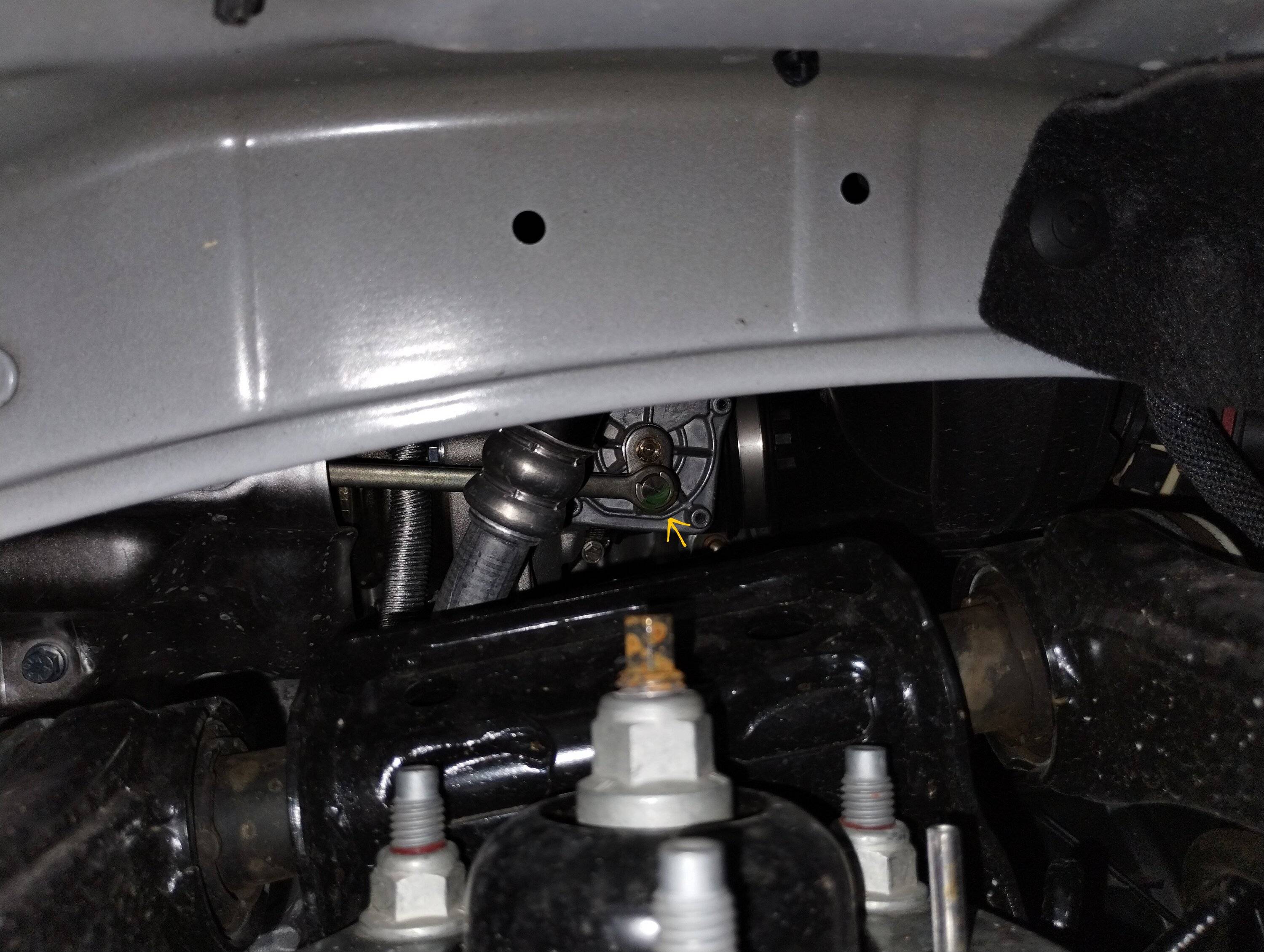

Update!!!!!
so the dealership in AK forgot the cotter pin causing the bolt to back out and eventually getting lodged in the turbine. They are fixing it under warranty.
Good news. What bolt has a cotter pin in the exhaust stream?

No idea I didn’t think the turbine had a cotter pin holding it together??
There is a c-clip on the actuator rod ends. One visible from passenger side wheel well. Could be what they were referring to?
