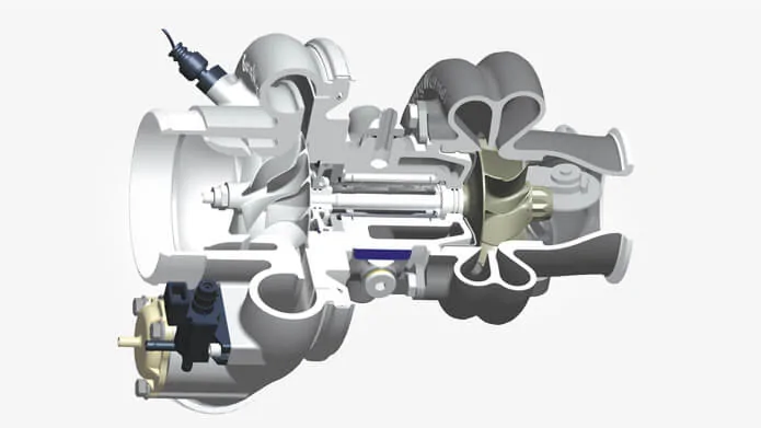

They told me it was the bolt holding on the turbine.
Here’s a good cutaway of what the internal’s of our turbos look like. The nut for the cold wheel is on the left and the turbine shaft and wheel are one piece with the wheel part being on the left. There’s no bolt or cotter pin internally as you can see. Just a good visual reference
