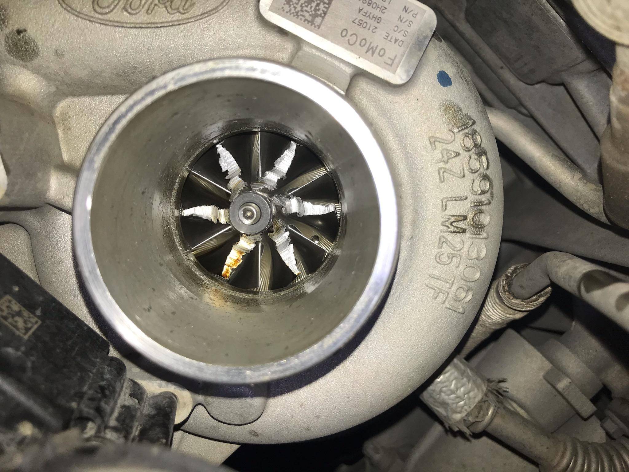

I found out by talking to the mechanic, they found a nut, the nut that mounts the turbo. He said when they replaced the turbo they probably dropped it in the airbox and instead of looking they probably got lazy and got another one. Anyway Here is a pic of the damage.

Picture matches techs story exactly. Technically called foreign object damage. Crazy how something like a nut can be stuck in an intake track and dislodge so much later. But have seen it multiple times. Hopefully they went through the intake system and got everything out. I suspecting they did after their findings. Thanks for posting the pic, it answered many questions.

The carnage of that scroll is intense.
I would love to see the size of the "object" that did this and it's ultimate condition in the end.
A small nut would have low enough mass to be lifted by airflow, but not enough mass to cause that, as it would likely pass between the vanes after a couple hits.
A large nut would be difficult to move with airflow initially, but if its like a square peg in a round hole, it could bounce around for some time. I would then be curious if this noise was audible in the cab.

That wheel will rotate between 50,000 and 150,000 rpm. No such thing as passing between with just a couple of hits. Depending on what type of material the object is a pea sized object can do close to this type of damage. Seen it multiple times

It was a nut, the tech couldn't find it when I was there. He’s gonna send a pic if he finds it.

yeah with blades spinning at that speed one could readily see the nut hitting a blade, bouncing back, airstream sucking it back hitting another blade, a repetitive cycle until turbo is put down, stevedbvik1 knows turbos, I've only rebuilt a half doz of them, a video of me in action :sunglasses:
