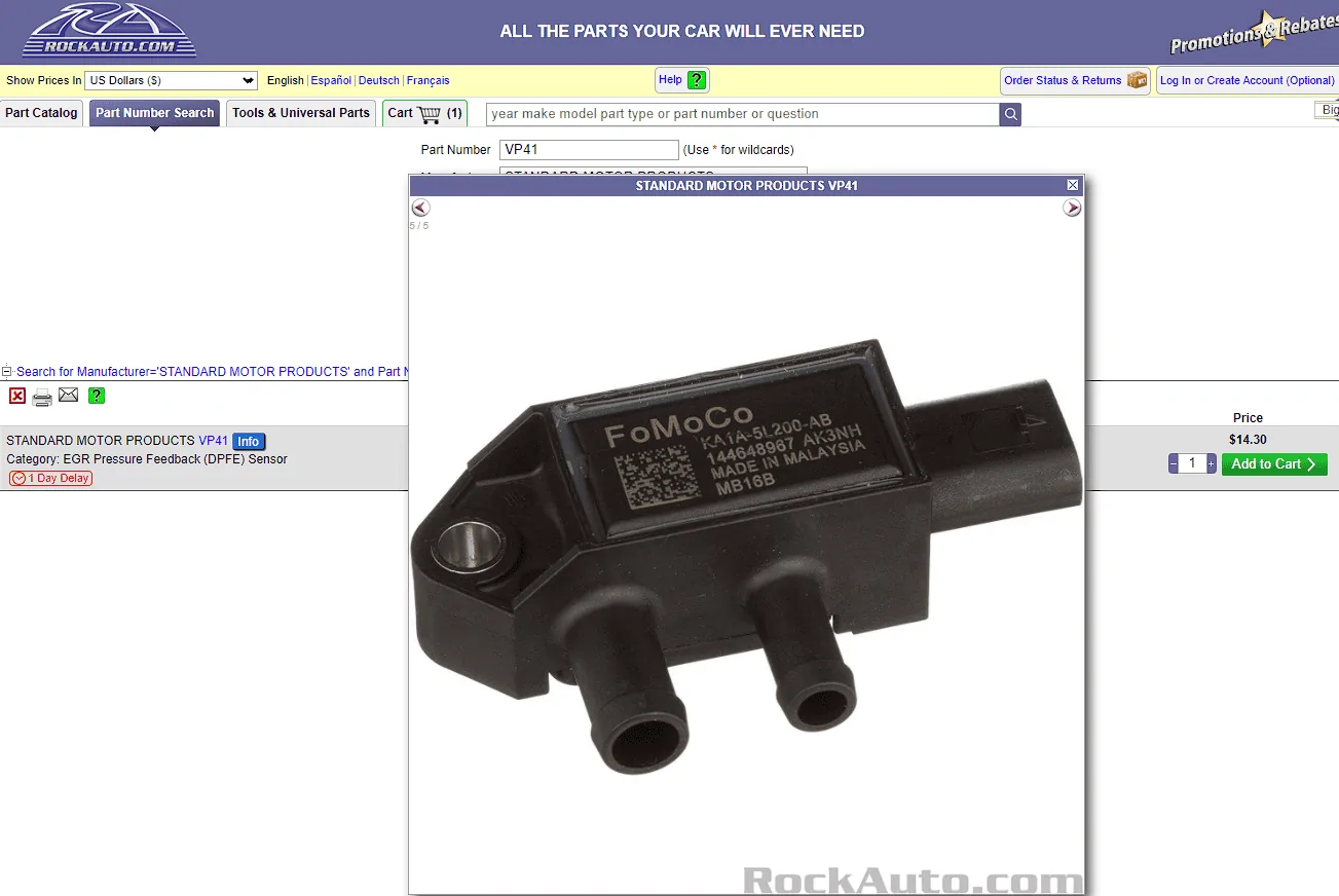

Rockauto has the Standard Motor Products sensor back in stock for $14.
Zoomed in photo:
5% off code that should work until 9/1: 239377047212908193

Just to clarify here - the problem part is a DPFE sensor, it is not the EGR valve. The EGR Valve is a separate part. Not being an A$$ just don't want others to be confused and tripped up on part names. The EGR valve is a $110 part, vs the DPFE sensor at $58.00 for complete assy
