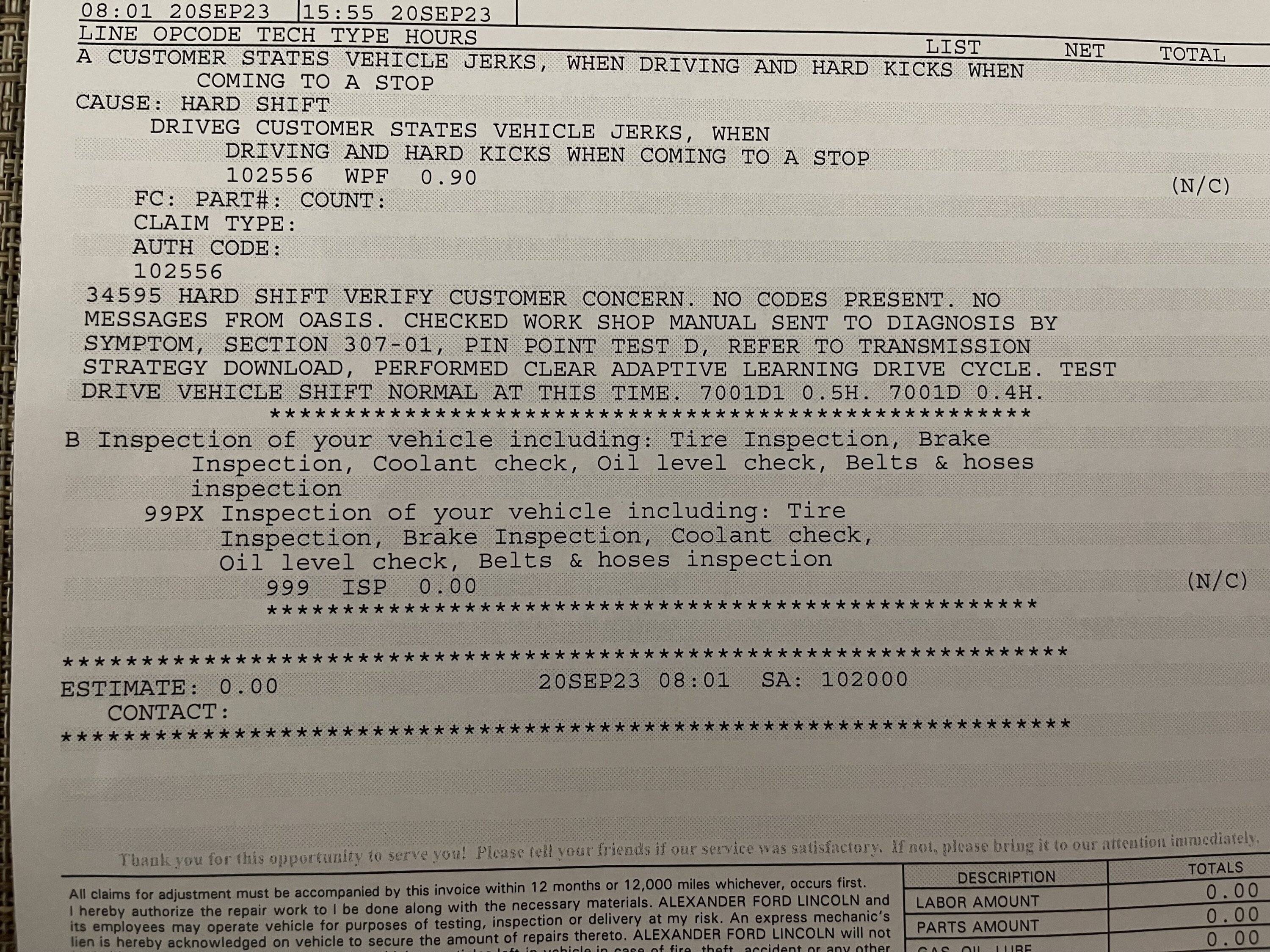

Unfortunately, this issue is mainly a no-code issue for most owners. For a dealer technician no-code = no problem, unless he / she decides to dig deeper and actually test the system and most importantly what to look for and that is the DPFE sensor PID reading being out of spec but not bad enough to code.
I would love to see a TSB or at a minimum a SSM on this issue, this will at least get a tech's attention and dig deeper, instead of the owner is an idiot and imagining an issue.
For when it does code P139C, (the most reported code) it directs the tech to inspect the DPFE for moisture and replace if moisture is found.

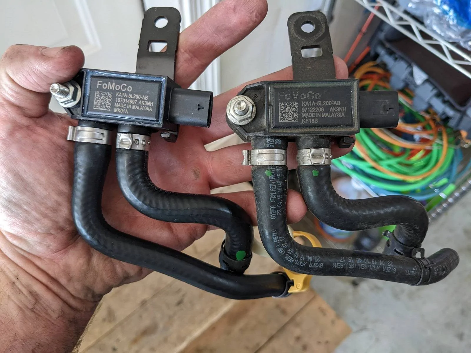

Yes, it is a bit confusing on the part name- as it is listed as Vacuum Control and Sensor, and some list is as a valve.
Borrowed Pic
Sensor Only - KA1Z-5L200-AB - Comes without the hoses, you will need to use side cutters to cut the silver clamps off of the old sensor and replace with worm clamps (5/16)
Current Price: $59.26 - Varies by Source
Note: I see varying dash numbers for this (-A) and (-AB) with searching for the sensor only, such as (-A) will be the listed P/N but the pic of part shows (-AB).
It is the same part though.
Kit - LB5Z-9J433-B - Sensor and Hoses - You have to have a small pair of needle nose pliers to get the clamps off of the tube ends, the new one comes with little plastic (finger) rings to ease with re-install - Access to these ends is limited, but doable.
Current Price: $78.62 - Varies by Source
Below is a pic of Old and New - DPFE Sensor - (Differential Pressure Feedback)
For Reference Only:

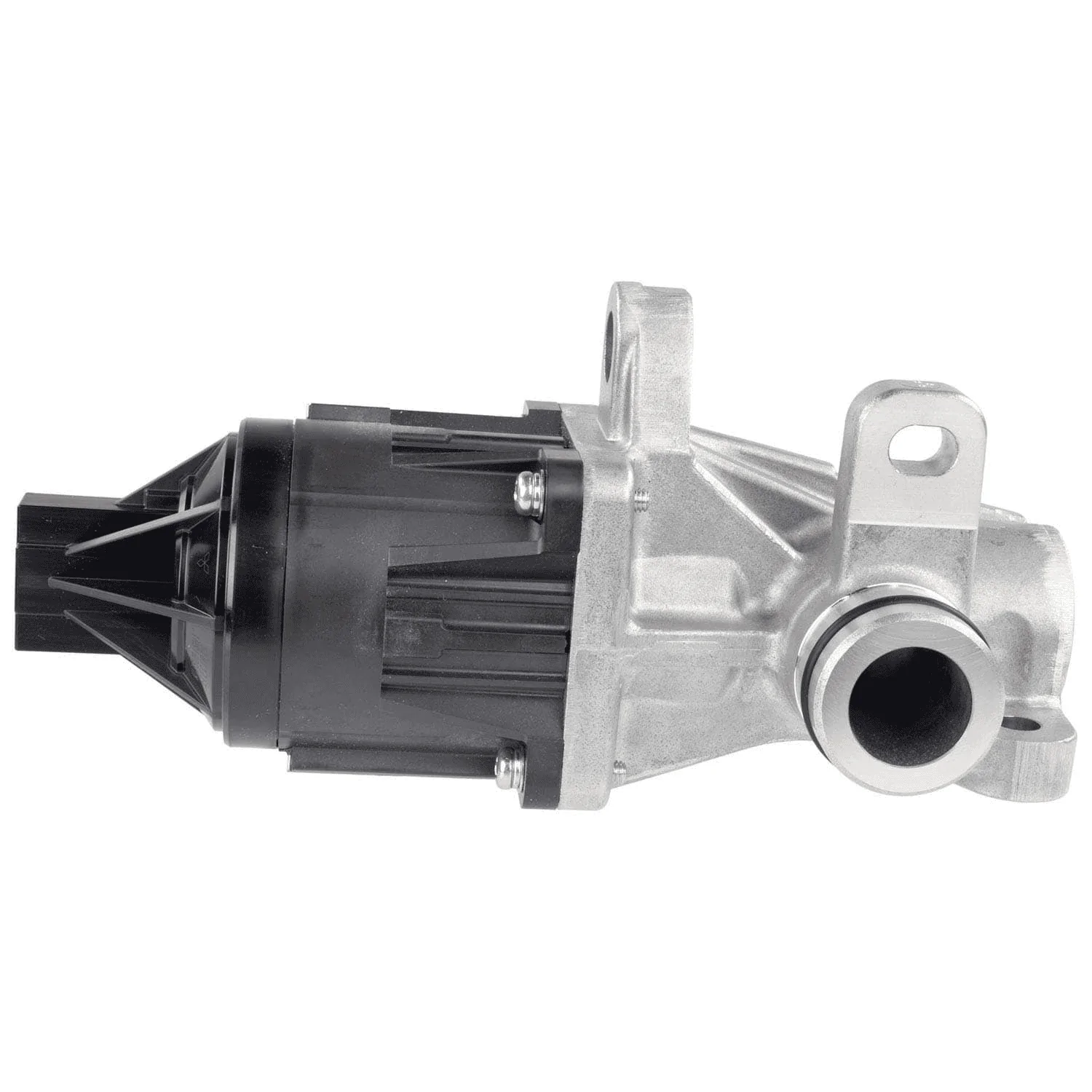

The below part: EGR Valve - P/N- LB5Z-9D475-B is the only VALVE in the EGR system, this part is Current Priced at $111.62.
Now the EGR valve itself will generate different codes; it is rare for them to fail.
This is the valve that is actually opening and causing the buck / surge drivability issues.
But it is receiving false readings from the DPFE sensor, and it is doing what the PCM is commanding from those false readings.
So, opening the valve when it should be closed, allowing unwanted EGR flow into the intake manifold. (at Idle and low RPM & Load conditions), this is the Buck/Surge.
Once you are at speed (cruise) you are overcoming this condition and not as noticeable
As the vacuum differential between the Upstream and Downstream flow (DPFE Sensor) has changed
Borrowed Pic
For Reference Only:

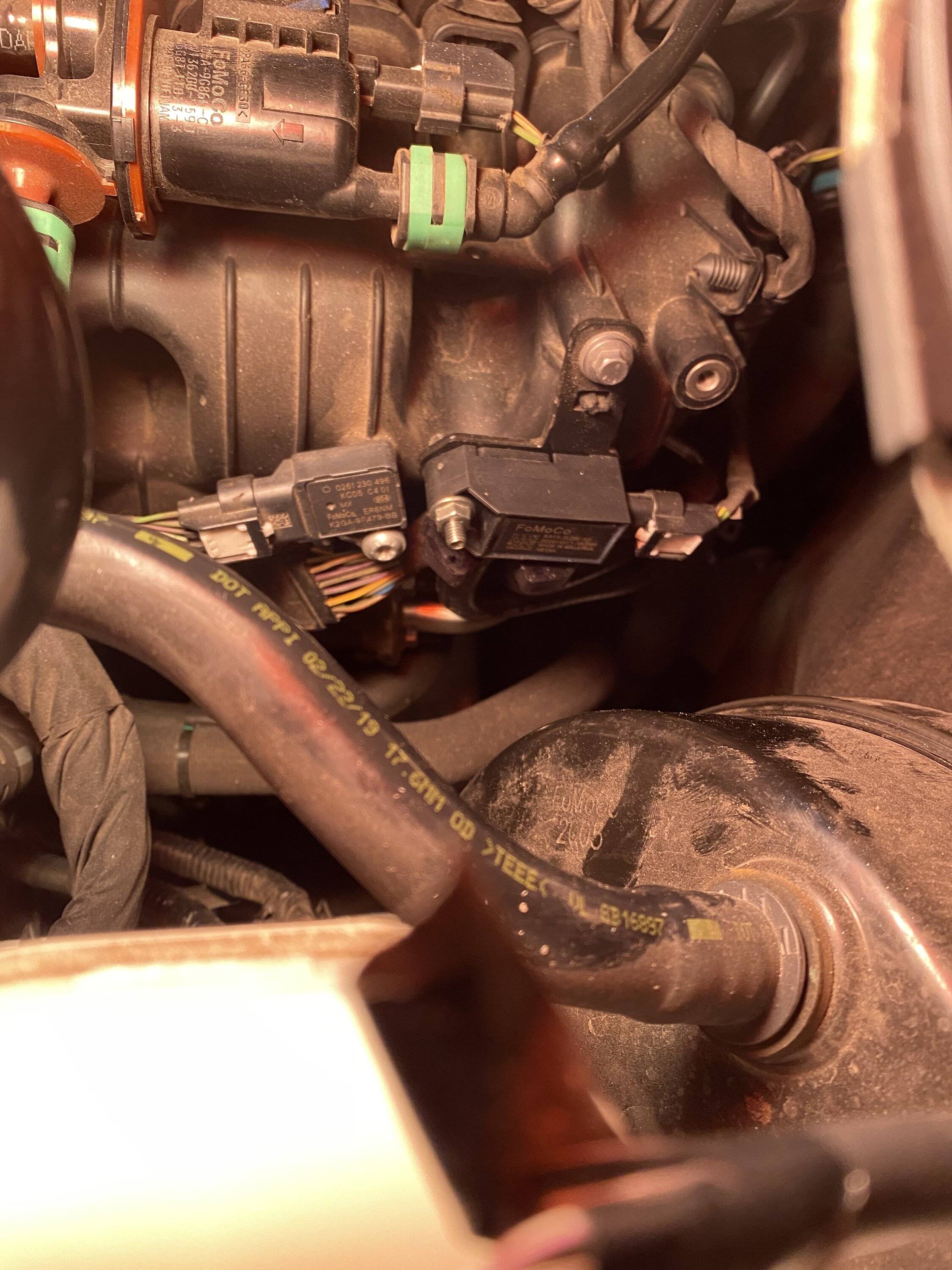

Drivers Side:
By the Brake Booster, the sensor to the left of the DPFE is the MAPT Sensor, you can see a glimpse of the rigid tubing near the firewall that the DPFE hoses connect to.
This is one of those parts where you have to head dive into the engine bay to get to it.

Drivers Side:
Thank you again - that is very helpful. I can't say I'm looking forward to replacing this, but I'm pretty sure I need to. I only noticed it when I was in rush hour traffic - normally I don't drive in stop and go traffic so I don't notice it, but I really did notice it with the stop and go. Maybe I will just not drive in stop and go traffic. :LOL:
