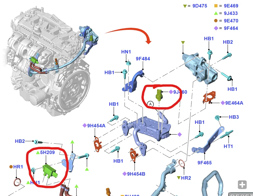

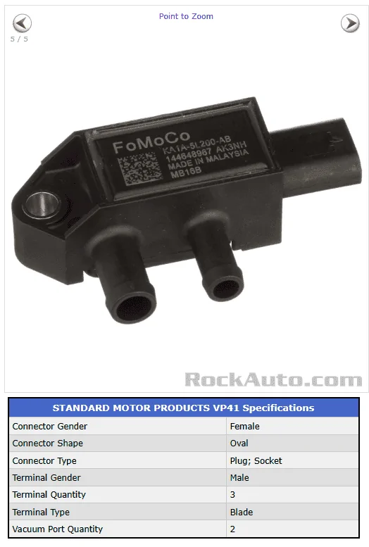

I've been having issues with my truck lately as well. To be clear, you all are replacing this part:

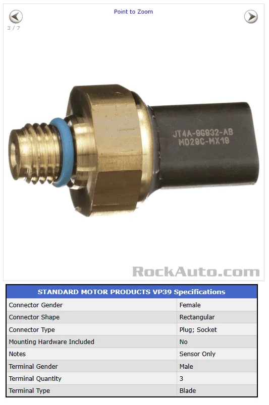

Does this sensor have any bearing on the situation? RockAuto and Ford Parts calls both of these a DPFE sensor.
I've also been having trouble for ages with the truck setting P061B and U0401. It only happens when the truck is first started when cold and if I take off from a stop with light throttle pressure. Those two codes will set, and the truck will suddenly act like it has no idea what to do. The engine will miss and stumble up to about 3000 RPM and then the transmission has no clue what gear to be in. It will shift as high as 9th gear at 30 mph.

The first part that you show (the Ford part) is the one that many times fixes the stumbling engine problem.

That sensor is stand alone piece and cost $12...but you'll need to remove the assembly, and install this back onto the mount and reuse the hoses as well as new clamps of your choice...the more expensive option is the entire assembly $80 and includes new hoses connected to the sensor and new clamps for the connecting tubes...pick your challenge...the cheap option is harder to install...
And YES! This 100% fixes the stumbling/hesitation issues...

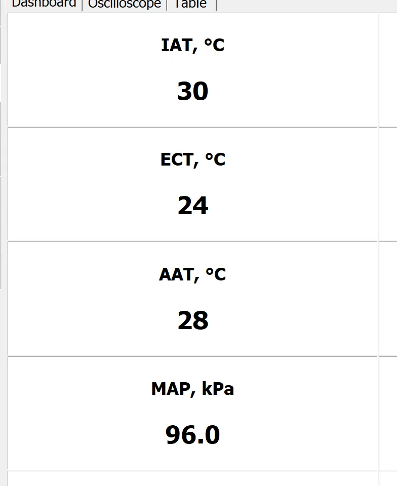

P061b , Kind of generic code, but Pin-Pont tests lead you down to the Throttle Body / Air Induction Leak, other notes are possible crank sensor and or re-program PCM
U0401 - (-86) - Ties to Invalid Data from PCM
So, the only thing electrical (data wise) in that intake ducting is the IAT Sensor, so if it is still installed it may be bad.
A quick check would be before you start in AM, hook up Forscan and check what the sensor is reading. The IAT and ECT temps should match with a cold engine.
But with no other codes then I think the Air Induction Tubing is the issue.
The IAT (Intake Air Temp), is a important parameter for Fuel Delivery and Spark Advance
Plus, since the Ranger does not have a MAF and uses the MAP instead the MAP sensor ties into the DPFE sensor and EGR system.
I think I would tackle the known codes first, then if still issue, then throw a DPFE at it.

Thanks for this info. I wasn't able to get out and try this first thing this morning, but I am doing it now early afternoon. IAT looks to be accurate and is fairly close to ECT and ambient air temp.
