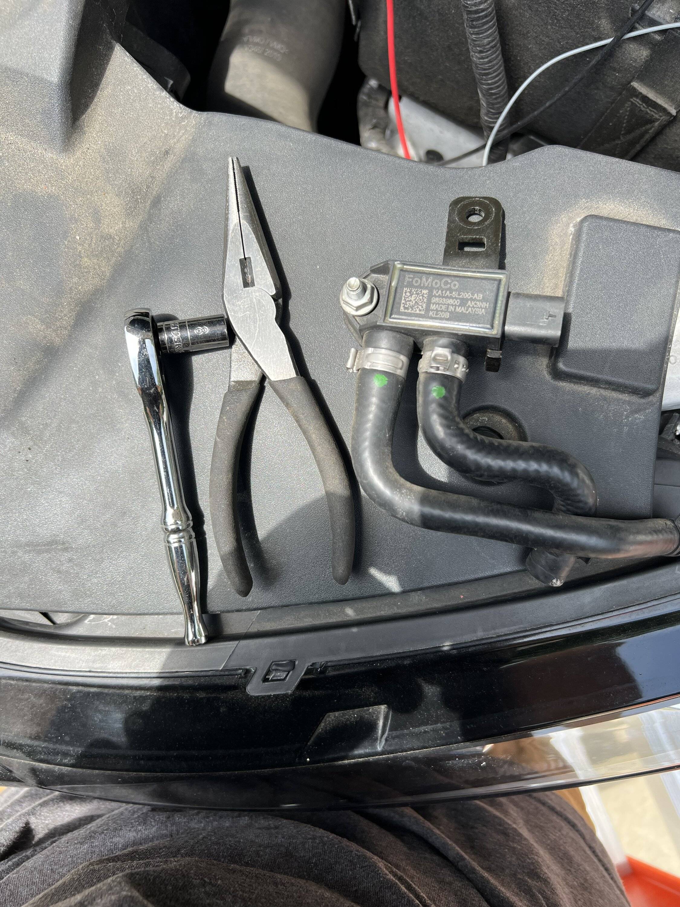

After reading here I realized I had this problem as well. I have 60,500 miles on my truck and I don’t know how long it’s been going on. I just new to hit the gas if it started acting up. So I ordered a new one from Levitown Ford, installed it today and did a little 10 mile test drive and no more issue.
Took me 20 minutes, only needed the tools in the photo and a little step ladder for easier access. Quick and easy fix.
Thanks for all the info.

The pics are a great assist for newbies to this... :like:

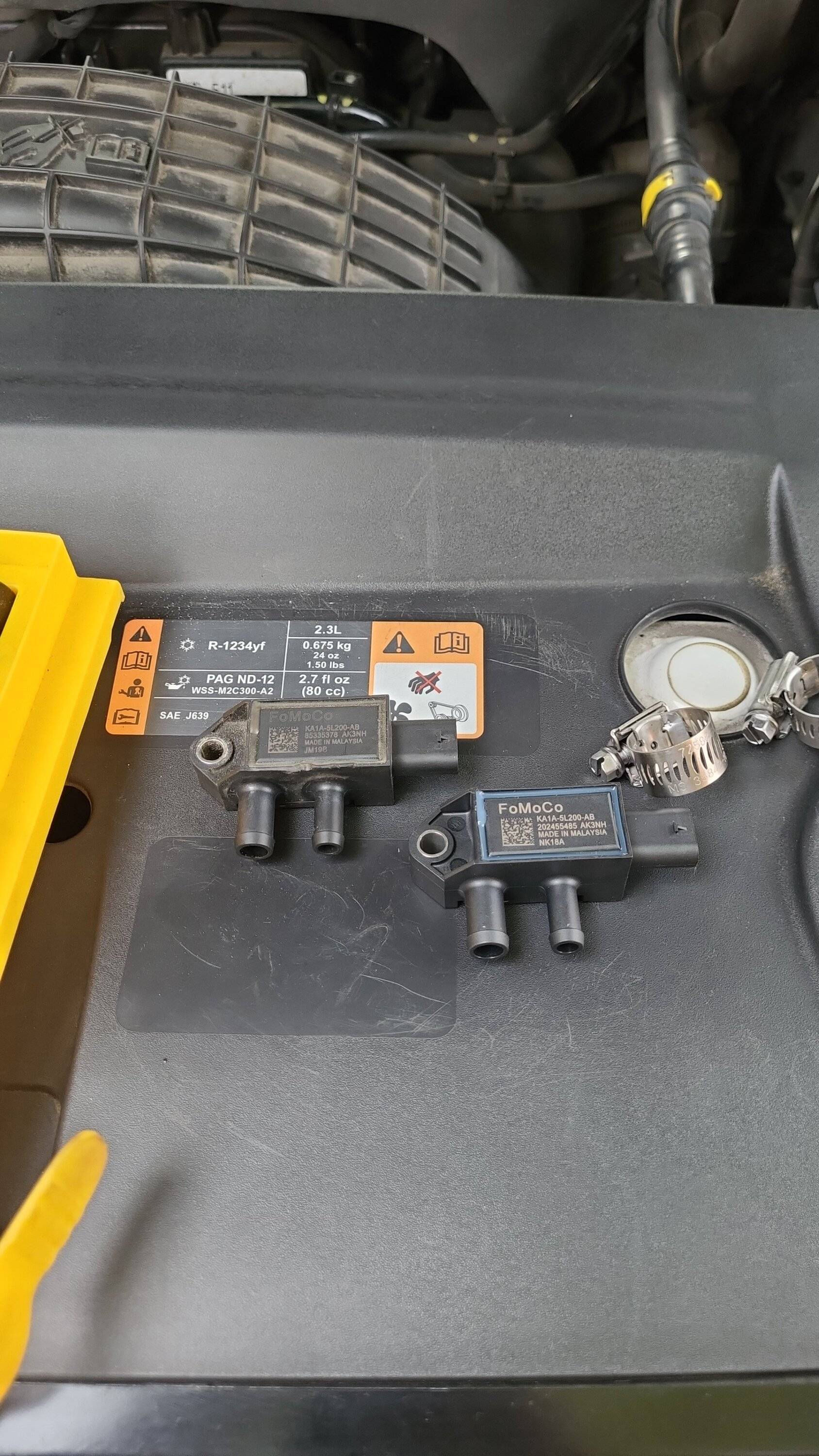

Huge thanks to everyone in this thread, replaced my sensor as well and no more low speed bouncing around and my rough 1st gear idle went away too. The old sensor had noticeable moisture inside it. Saved me a ton of money because who knows if ford would of figured this out or not. Downside is price definitely jumped up - got mine for 126$ (Canada).
$94 USD for just the sensor?! That's high...the sensor alone in US is $12 plus shipping...the sensor assembly with new hose/bracket/clamps is $80 + shipping...
yeah pretty brutal, Probably should of ordered from the states and just waited for the shipping
