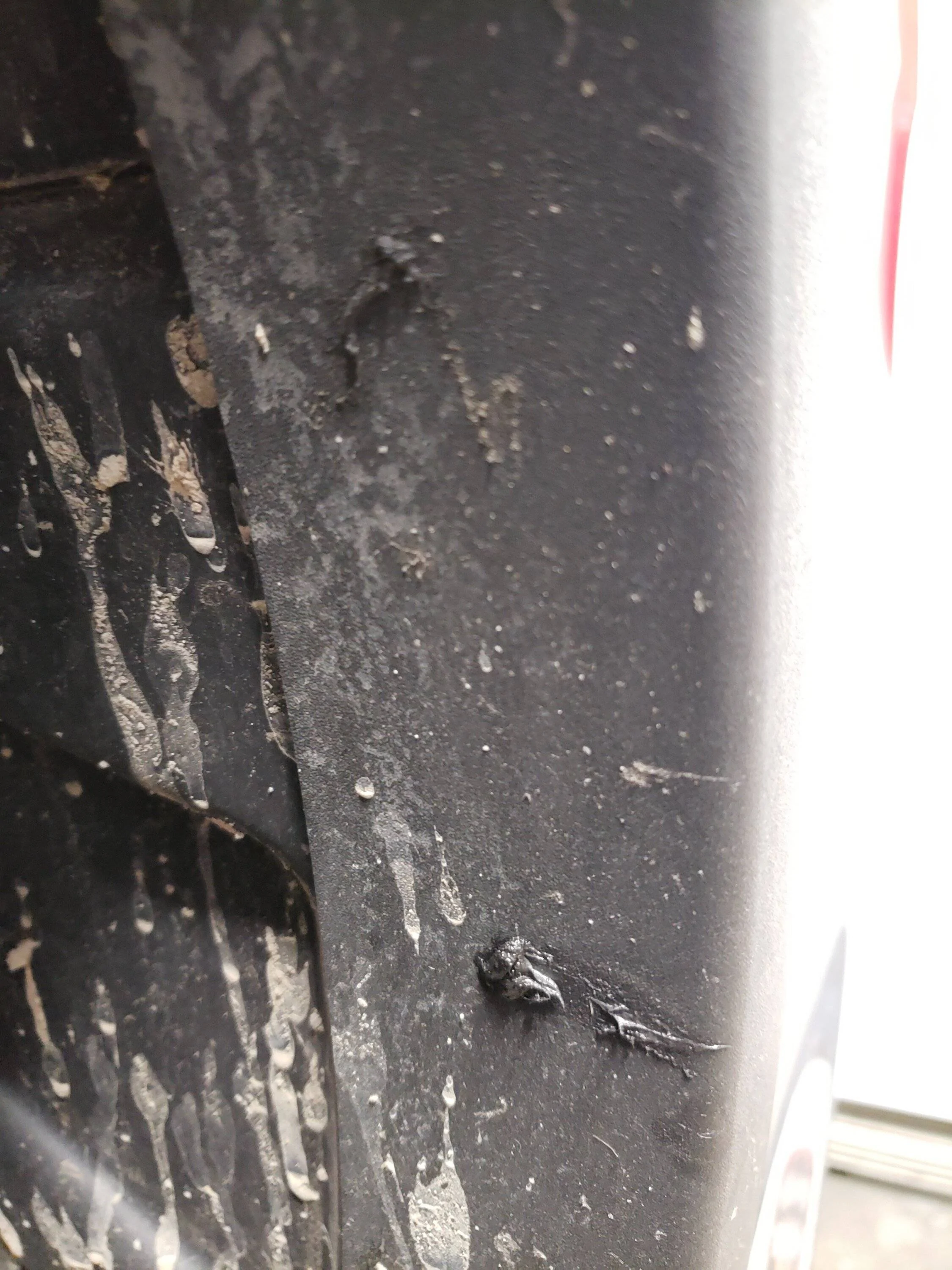

Hi there 5G friends, went to go target shooting with the neighbors (hope I'm not on some list now for saying that) and hit some NF gravel roads, nothing serious, was in 2wd the whole time.
Stop at a reservoir for lunch, notice black grease near the right rear bumper. Wipe it off, don't think too much of it. Get home, back into the driveway, hmm...that back end looks cock-eyed. Get out the tape, sure enough 6.5" from the rear tire to the wheel well on driver side, 9.25" on the other.
Will call Ford next week, no biggie, but kinda disappointing with only 1, 200 miles on the clock.

Okay folks, little update. First, want to thank everyone for their replies, thoughts and suggestions. This is what this community is for.
Backed into the garage to await a call to Ford, went back out an hour later and truck is sitting level. What's up? Any thoughts?
I will take it out tomorrow (have a home improvement run to do) and if the same occurs, I will include pics so you can see what I was talking about (I have attached a pic of the grease on the inner wheelwell).

Makes no sense. Shocks are a velocity device...they do not hold up the truck. Something here is wrong... Springs hold the truck up... and once broken the vehicle does not recover normally.
We need more info.
Blown shocks are coated with oil and when you bounce the truck they offer no damping at all.
The picture you posted tells me nothing....

They don't use that type of grease in shocks(it's oil), thats from something else.

I think there is a pretty good chance that which you see in your photo came from the road/trail.
As for the temporary lean? Just plain strange. You may have something binding in the suspension, creating an abnormal amount of stiction.
I think I would jounce the truck a bunch of times, see how the shock is working, hear any strange noises when you jounce it up and down, etc., see if anything is binding.

One of the shock valves could have been stuck shut and that “could” hold the truck down under certain circumstances. It’s plausible that you overheated the stock shock and it froze up temporarily, but I think that would take a lot of long term heavy dampening.

The shock does NOT have grease in it, it has a light grade of oil, what your photo shows is a much heavier grease, such as used in the wheel bearings and drive shafts. You have something else going on, better take it in and get it checked.
