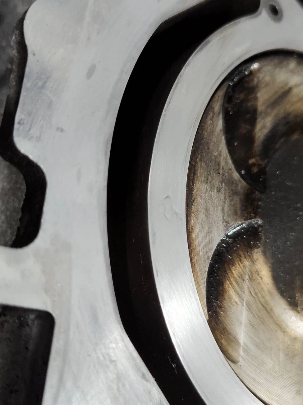

thought mine was the head gasket but turns out it was the block. kind of wish the head cracked instead, but alot more miles than you. oooph
