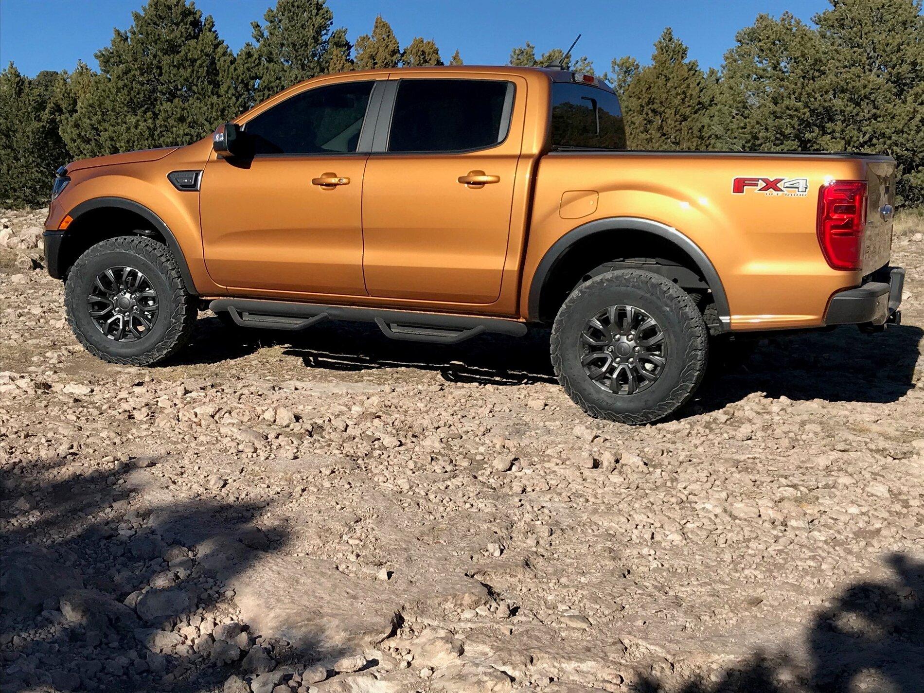

Put the 5100's on all four corners. Fronts at the top perch and added BDS 1" rear shackles on the rear. Looks great and rides even better. Slapped some 255/75R17's (32x10) on and went off-roading. I was amazed at what this truck can do!
Do you have some pictures? Did you install yourself or have a shop install?

Truck in pic is obviously pointing uphill. Still has about an inch of rake.

Looks great, I also like your side steps.

Those are NFAB Podiums. Yes they look good but I am afraid they hang a little low. Planning on replacing them with probably the Rocky Road Outfitter Rock Sliders.

I have always been a Jeep Rubicon owner and love the Colorado Trails. This Ranger with a little lift and taller tire like this is a very, very capable climber/off roader.

I assume that is because you use your Ranger off road and need to maintain more clearance?

Its my daily driver also, but yes. Those steps bolt to existing holes on the body and I'm concerned if one grabbed a big enough rock off-roading, there could be considerable body damage. Rock Rails bolt to the frame and I've read are stronger, reported to protect the body, and can be used as a jack point. Just a precaution.
