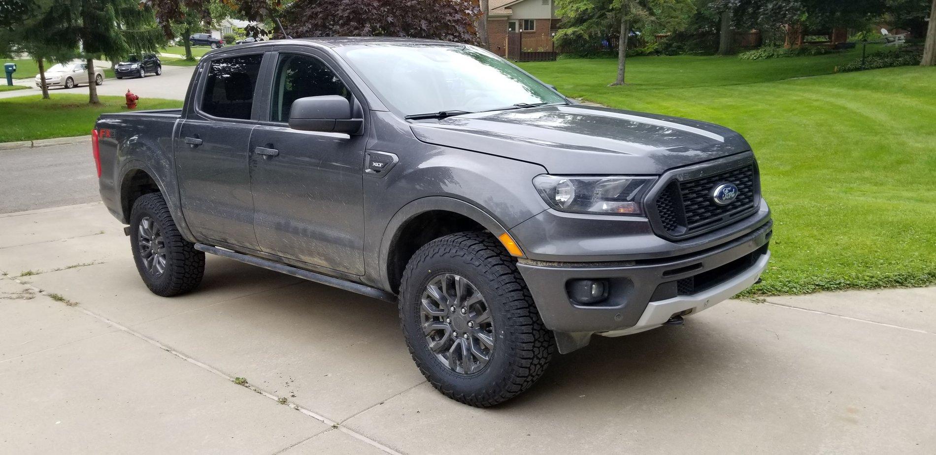

If you’re willing to upgrade to a 17”, my calculations show a 255/70r17 is .5” larger diameter than the factory size. It’s what I’m going to spec out to replace my 18” wheel/tire package as I’m going to a 17” wheel now
Just an update; this is what 255/70r17 looks like. Zero lift, zero rubbing under any conditions. 1” bigger than stock. Wheels are 17x7.5 et35
What tires are those? Falken?
And please report mpg change when you get some miles on em.
Looks great btw.

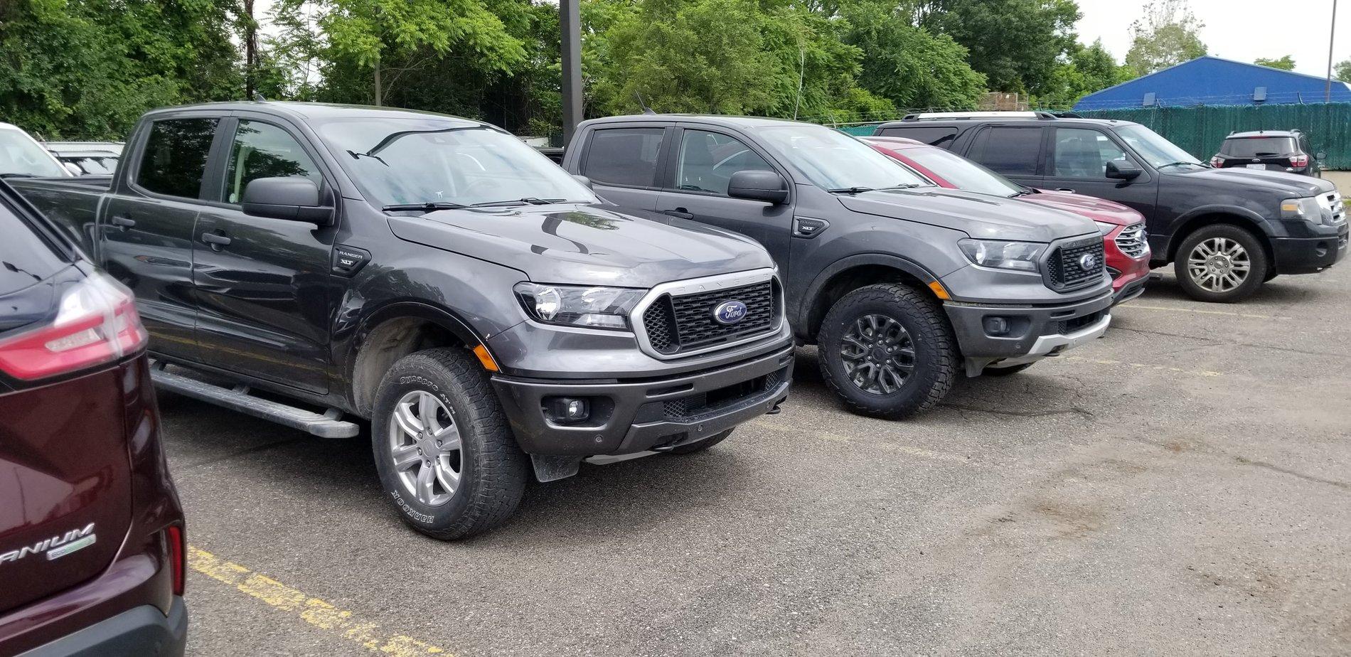

Another confirmation on fitment with 265/70/17 (just under 32") whereas OEM is 265/65/17 (30.6"). I went with Falken Wildpeak AT3W - with a set being $500, can't beat the value. There's no rubbing at full lock when static, but I will note that when I zipped into a parking space, I heard a little bit of rubbing when the suspension compressed a little bit. Not too worried but I wouldn't go bigger without a lift.
I'm also surprised at how much of a difference I felt on the road. Truck feels a little more sluggish with the heavier tires and I feel the extra inch of ride height when driving too. I also just went to the off road park a few weeks ago with the OEM Hankook's, and I'll be going again this weekend with the Falken's, so I'll update with a comparison!

Update: sorry guys don't mean to spam the thread, but here's a side by side pic that I just got between a stock FX4 XLT Ranger and my FX4 XLT Ranger with the 31.6" Falkens. The size difference is so evident side by side!
That's a great comparison photo. Gives a better idea of the difference and just how much the new tires fill in the wheel well.
