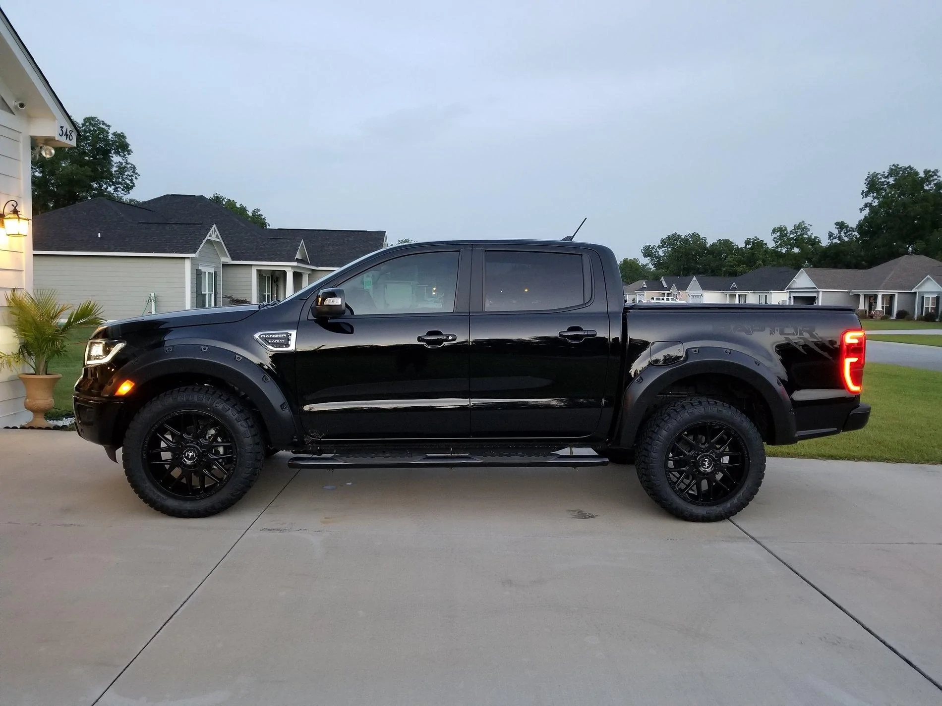

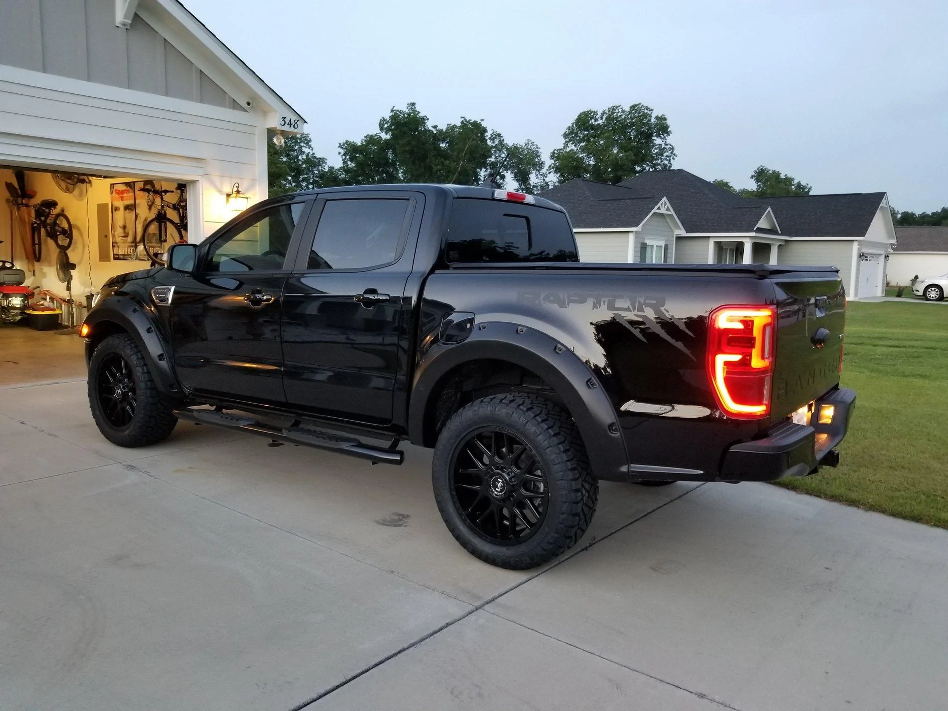

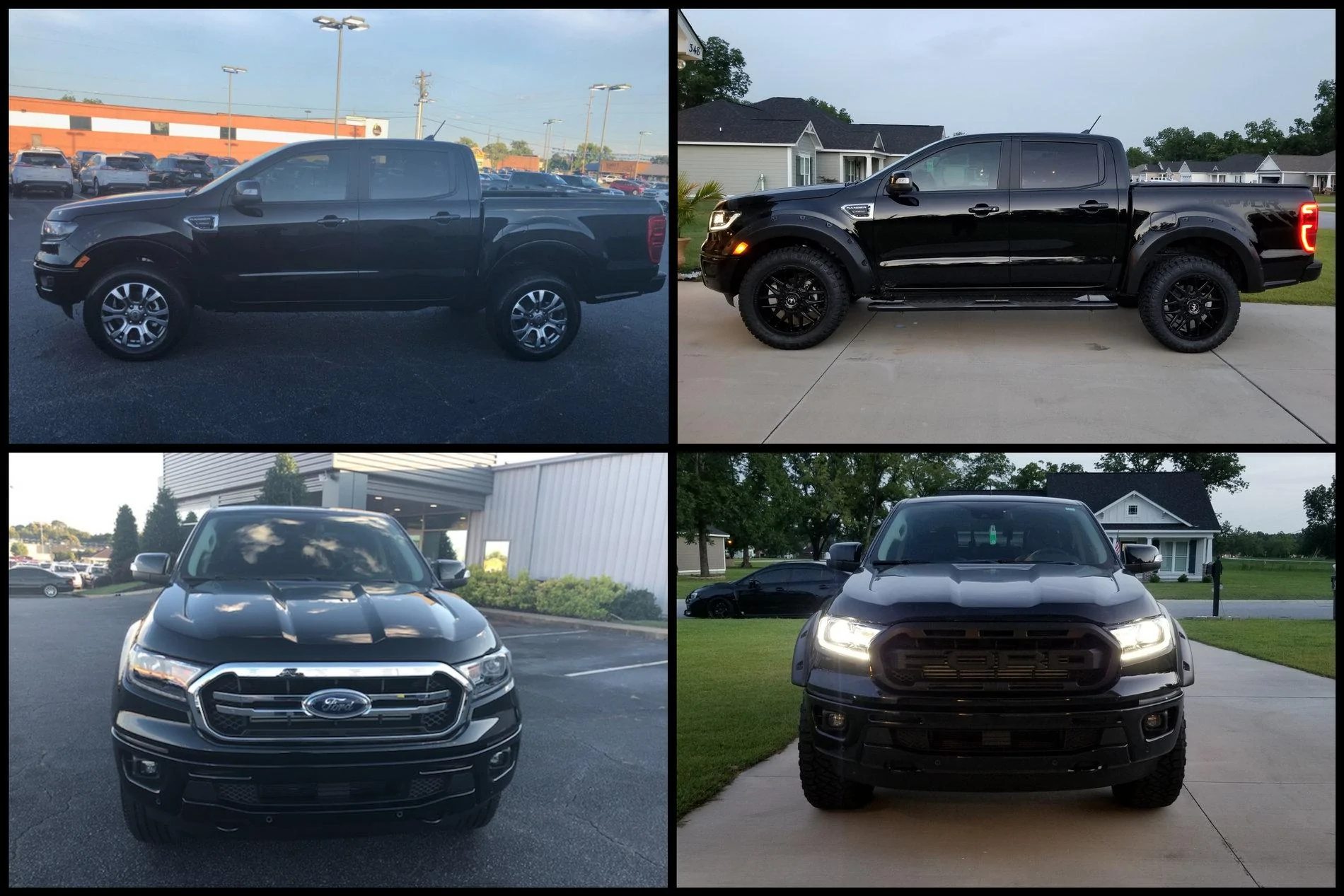

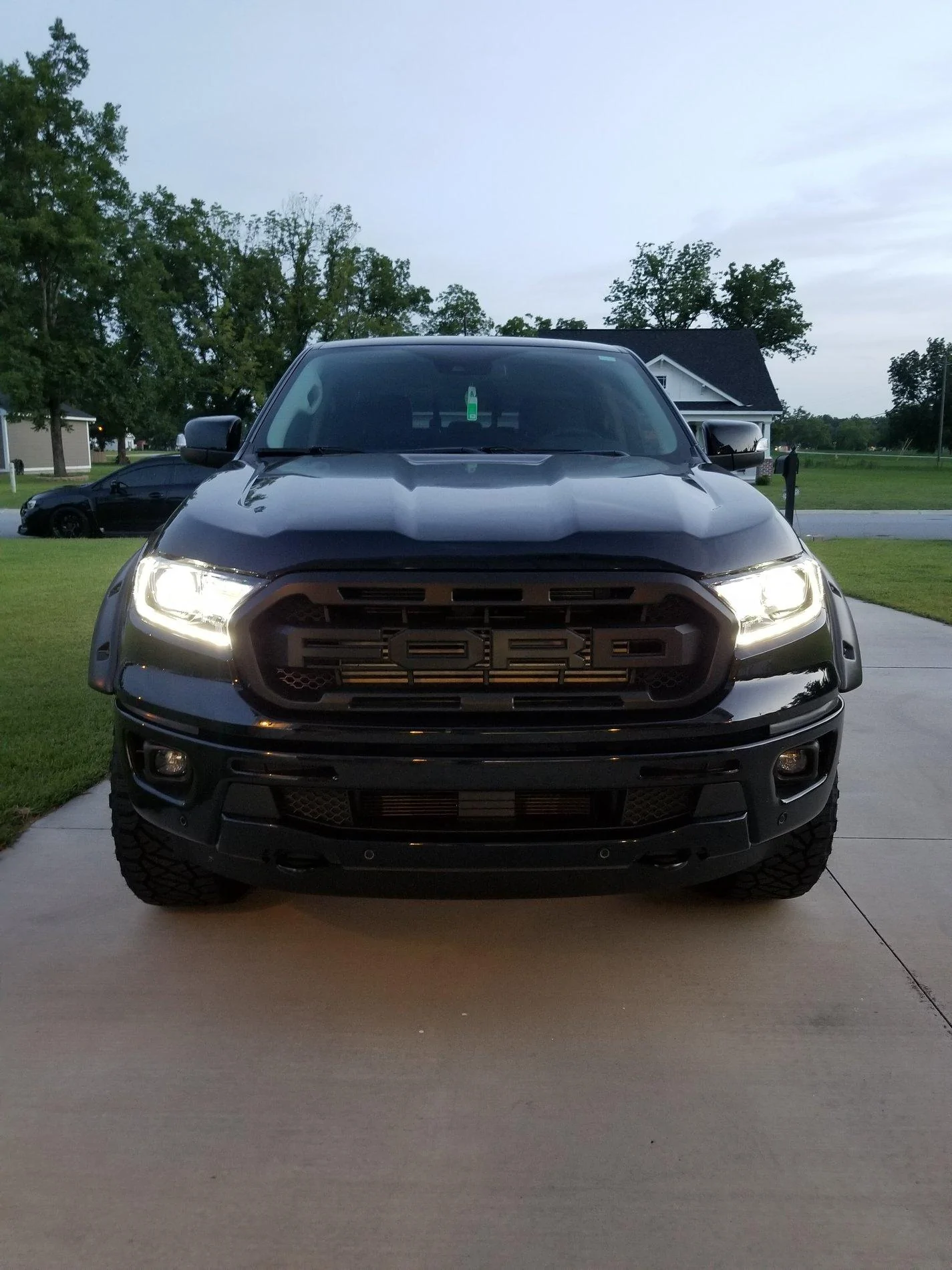

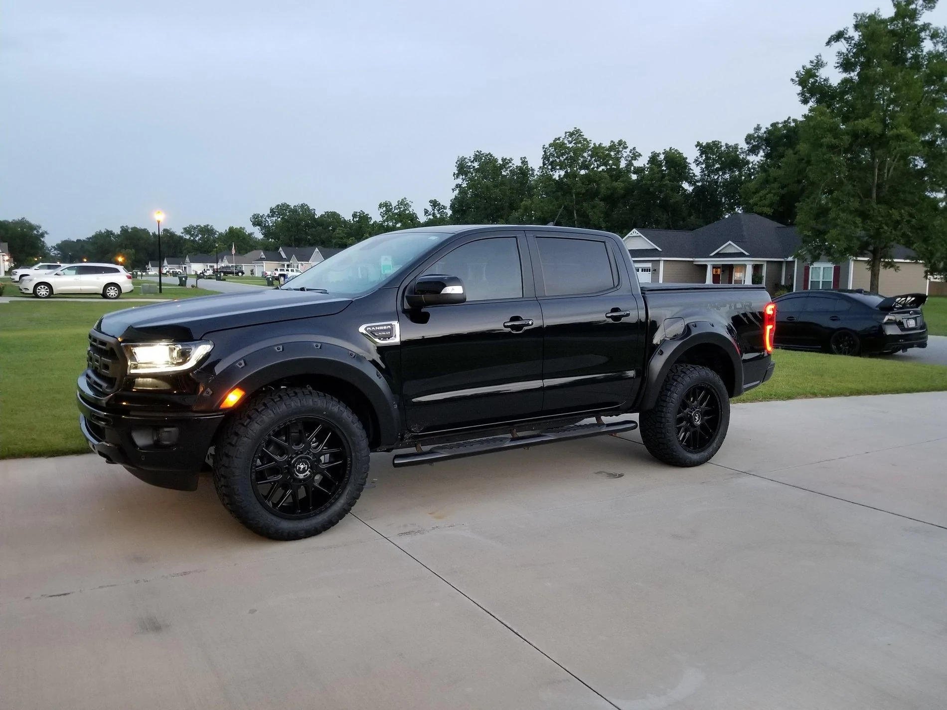

Just installed some Motiv Offroad Magnus 20×9 +18 with the Nitto Ridge Grappler 275/55/20. Had to remove the front and rear crash bars due to rubbing. Also put some fender flares, grille, nerf bars, and trifold bed cover on this past weekend! Waiting to put some 1.5" spacers this weekend to sit flush.

For those wondering... I searched forever online for a "how to" to remove the front bumper to get the front crash bars out without cutting since I didn't have the proper cutting tools... and I also heard they were a pain in the butt to cut off. Finally found this write up by ADD to install their front bumper. Followed steps A-G and skipped to step K. Took about 30 minutes and they slid right out.

Thanks for sharing the "how to", it's a great resource!

Also, please update with the spacers! Will be interested in seeing how it affects ride and handling. As well as bolt on procedures/modifications if necessary.

Will do. I plan to pt them on tomorrow God willing!

Also had to unbolt the bottom 2 fender bolts to pull back on them to slide out the rear crash bars. That and some other bolts for the fender inside liner along with a plastic block piece to be able to slide one of the rear crash bar bolts out. Pretty intuitive though. No instructions really needed for the rear. Took about 1hr for the rear. Rubbing 100% gone now!!

Nice looking truck.
