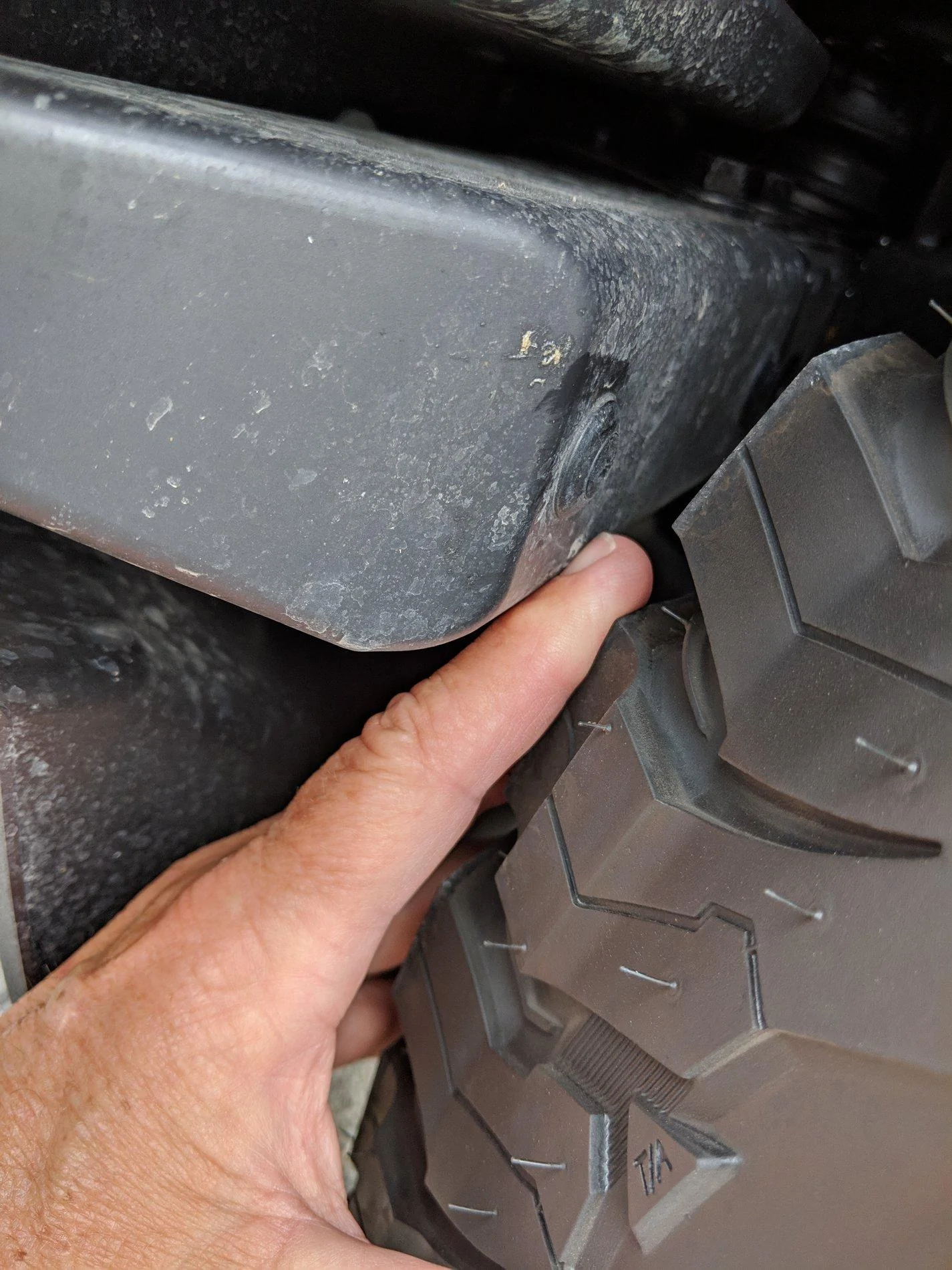

Yes. See post 42 on this thread. About a fingers clearance from front of tire to crash bar, but no rubbing.

Well we squeezed 255/80/17s in the front. Finger of clearance at full lock and mild compression. May rub at full compression, so we will see. I'll attach photos when I get home
This tells me that the 255/75/17 should fit with no issues.........
