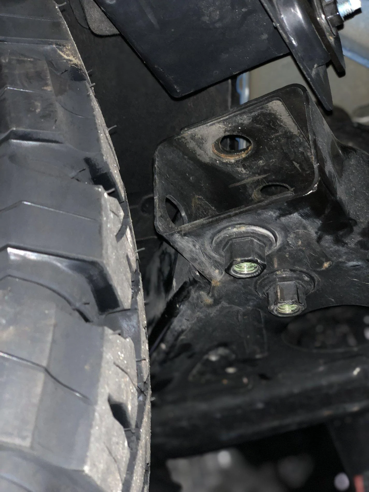

has anyone taken photos on the modification necessary to the crash bar? or how if possible to adjust/shorten it?

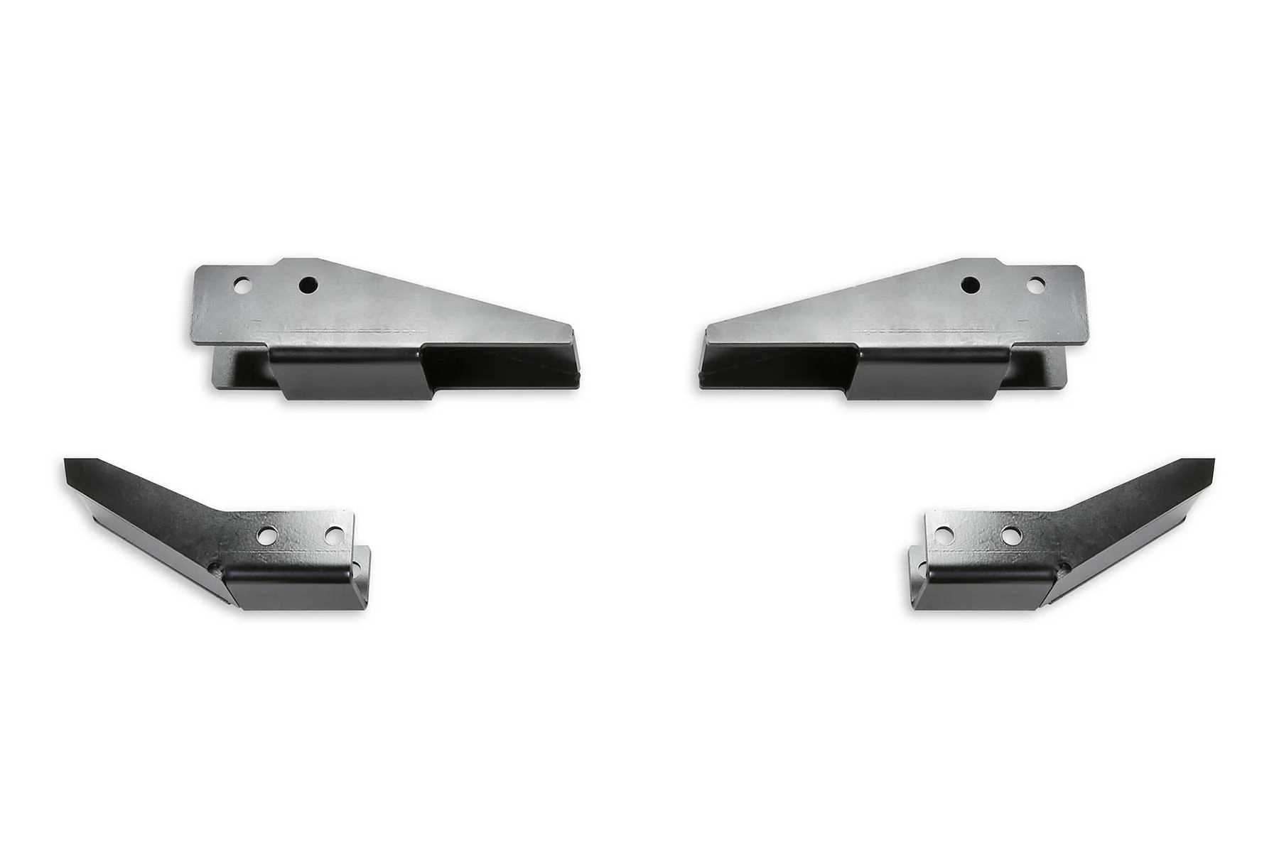

Based on Ready lift's modified beams, I think the stock beam can be cut similarly. The back piece might just be omitted in my case. But don't do as I do...I'm the kinda guy who replaces his airbag steering wheel for a proper 3 spoke racing wheel and a set of racing harness lol...

Well I decided to go ahead and pull the trigger on the Fabtech crash bards today. Once I get those, I'll pull the trigger and try to squeeze my 285-70 17's in there with stock height. I can't look at these wheels for any longer while I wait for my Icon lift to come.

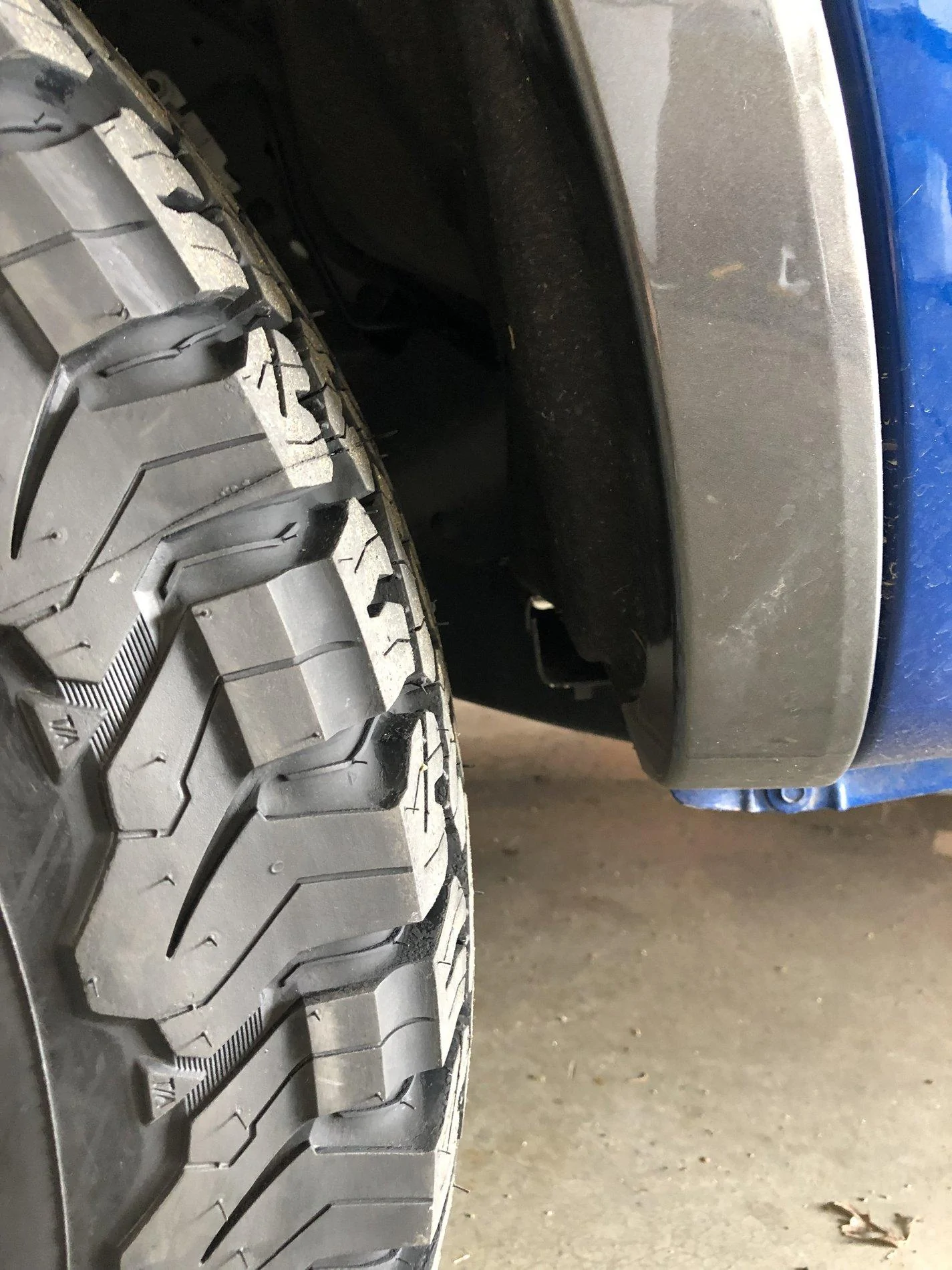

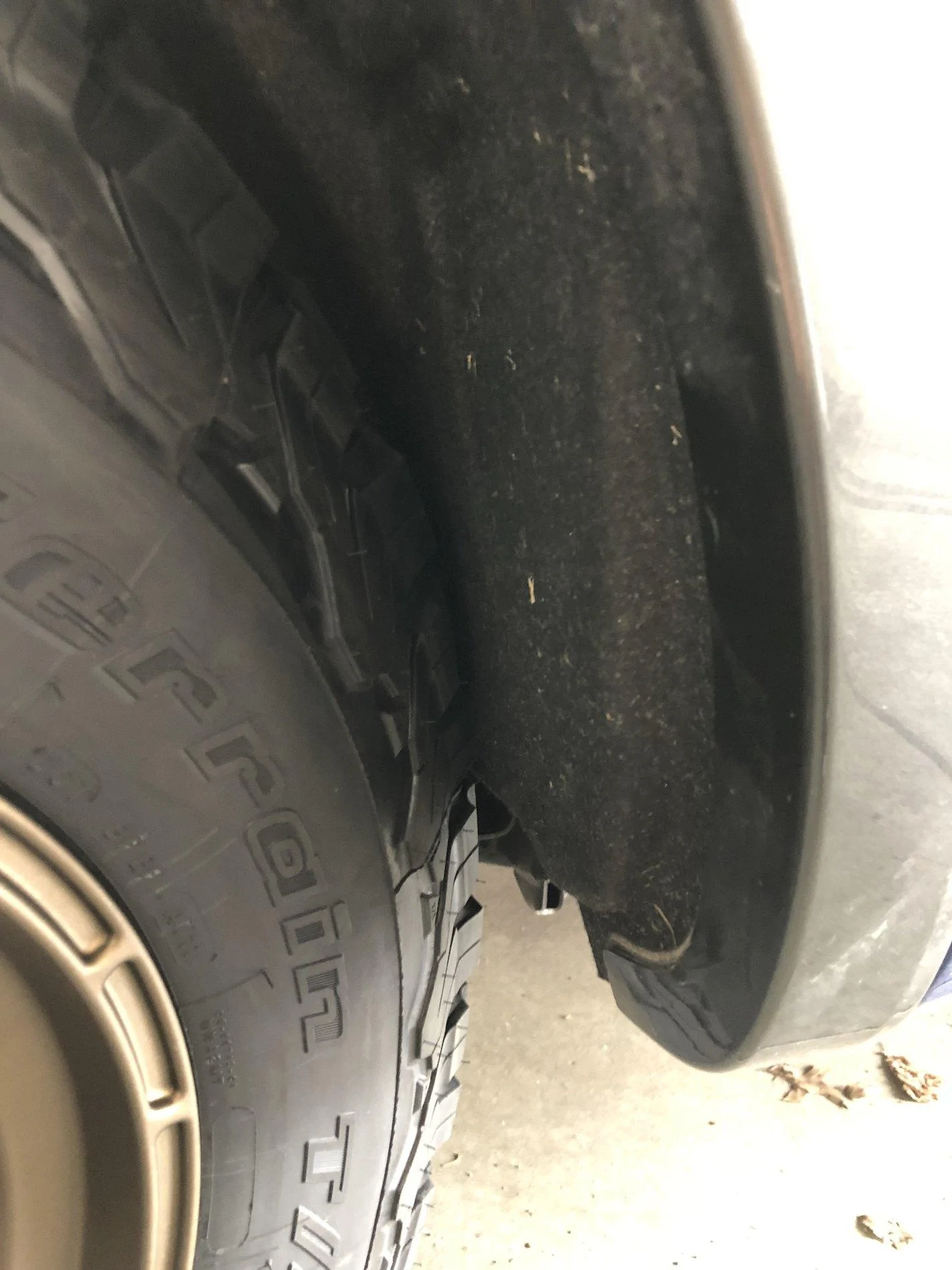

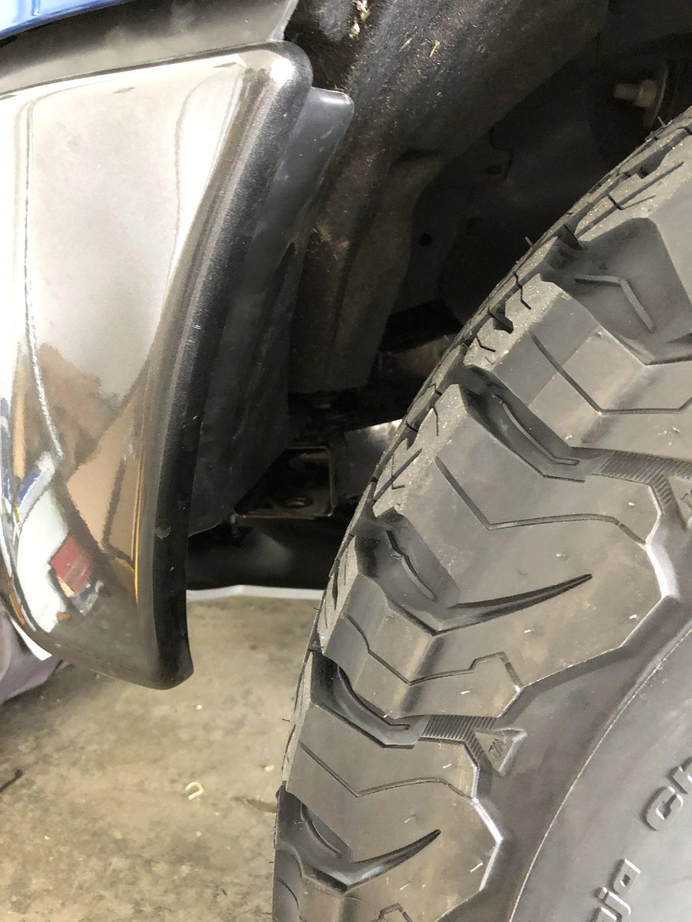

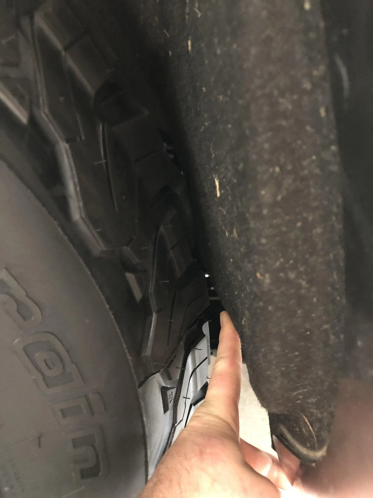

I know, I purchased Fuel Shoks at +20. They only rub at the rear at full lock, otherwise, no issues whatsoever at stock height. These are BFG KO2s at 285-70 17. Yes, I did remove the crash bars and the front brow.

Do you mean the crash bars (guess they are technically called beams)? If so, yes I removed them.

The rubbing behind the wheel is easily cured with a way to hold back the felt liner as you can see below. Otherwise, fit is good. Very close, but good.
