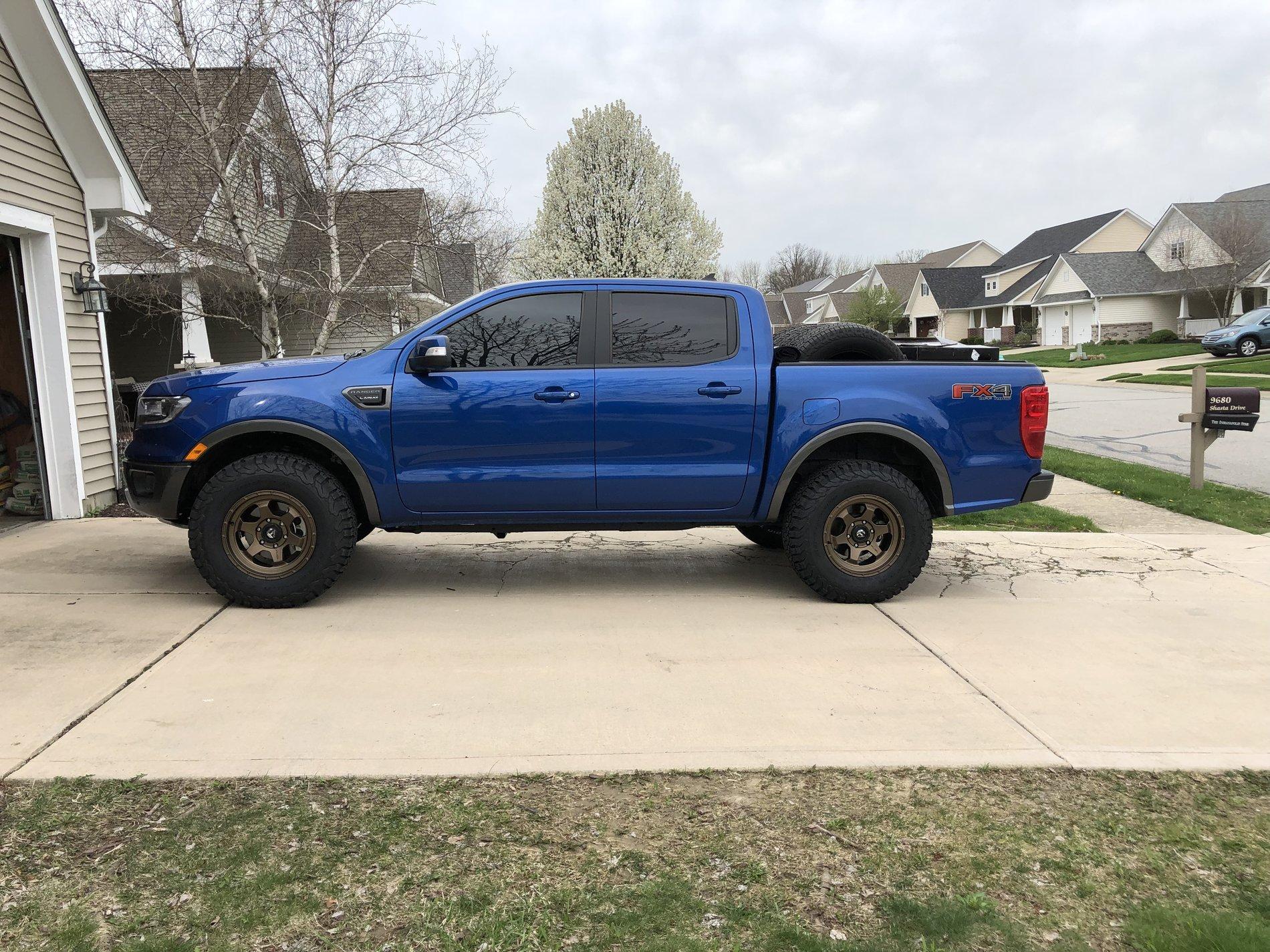

No, I chose to cut the crash bars then remove them. It was a PITA but worth it.

I’d still like to know what fits stock with no mods. I can’t find a shop that wants to test fit a larger size.

So your saying 33's fit stock, just have to remove (modify) crash bars. And do something about rubbing on the wheel liner (aka: zip ties)
What's the offset difference vs stock on those wheels?
Stock is +55, these are +20, which is really ideal. I believe less offset, like 0, would hit the fender or bumper without a lift.

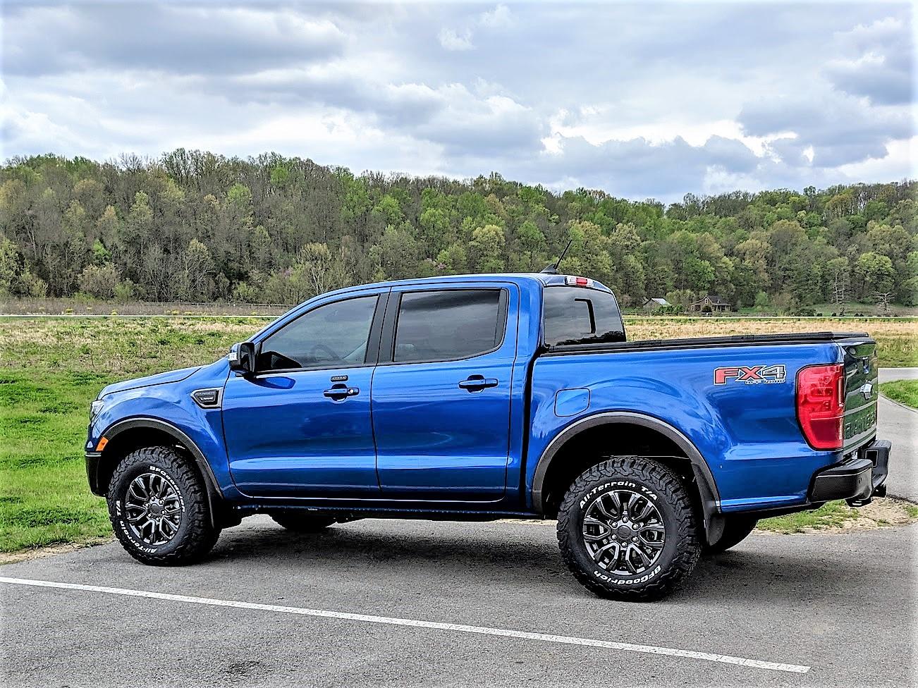

I can confirm the 265/70-17 Cooper AT3s fit an FX4 with zero issues:
Huge improvement. Very impressed with the truck's capabilities on those tires.

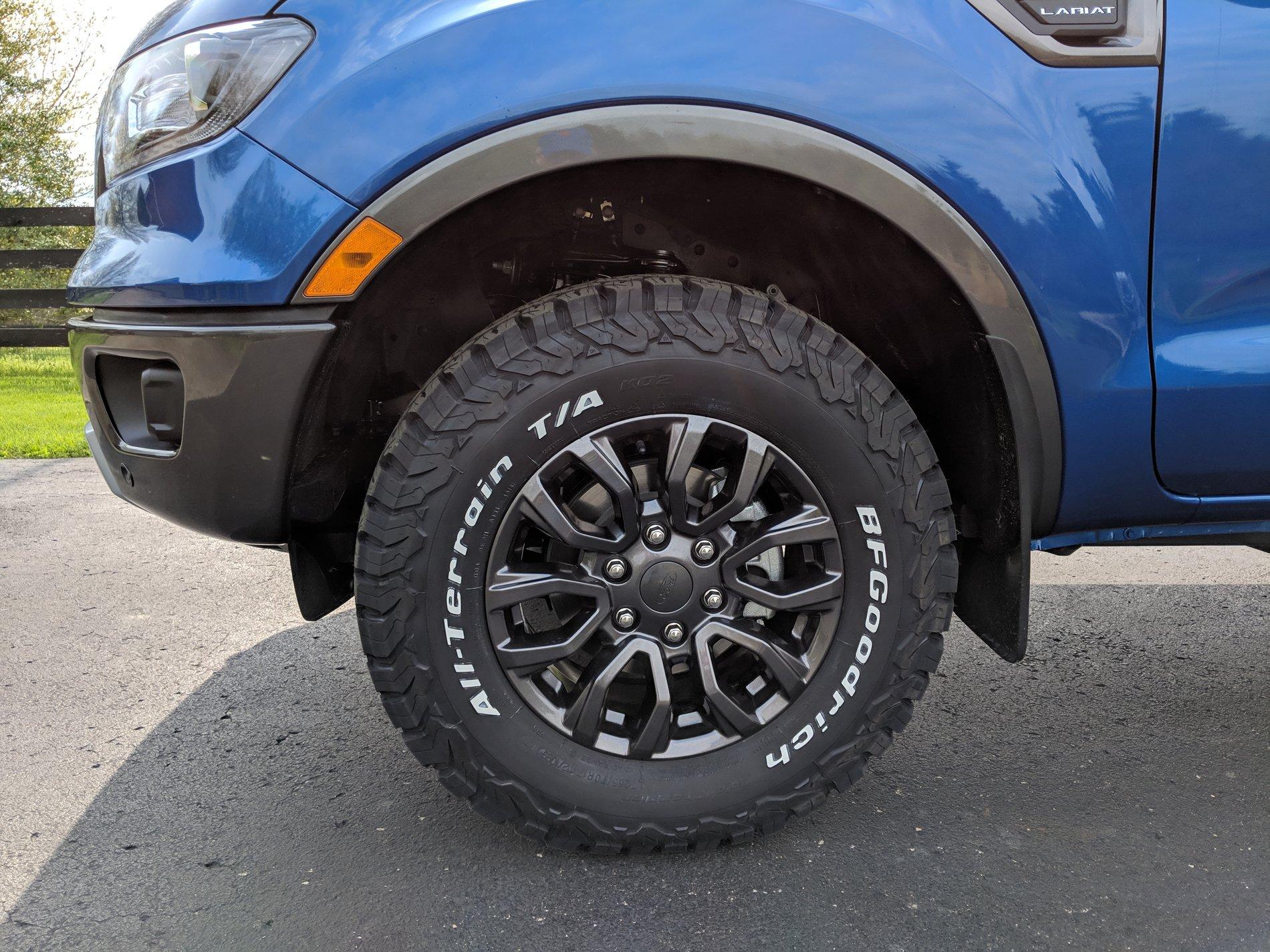

I also went with the 265/70R17 but I chose the BFGs.

No lift and no mods? Or did you have to do some work? Think they are ok at full lock and flex?
No lift, no mods. There is still about 1/2 inch clearance to front crash bar at full lock. No change in the small amount of clearance from the tire and the upright.
