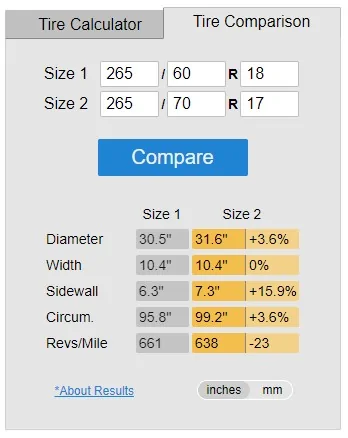

Great thread. I am trying to give my daughter the wheels off my bronco. Sounds like the tire size will work based on this thread. She has the 18" dynapros on her ranger right now. I did a bit of googling and it appears the lug pattern on the bronco and the ranger is the same. Anything I am not doing right here? She has to take the bronco wheels due to the rim size difference.
Bob902
Bob
May 6, 2021
3,748
20,766
St. Louis
2021 Ranger XLT
RETIRED!!!!
Bolt em on.

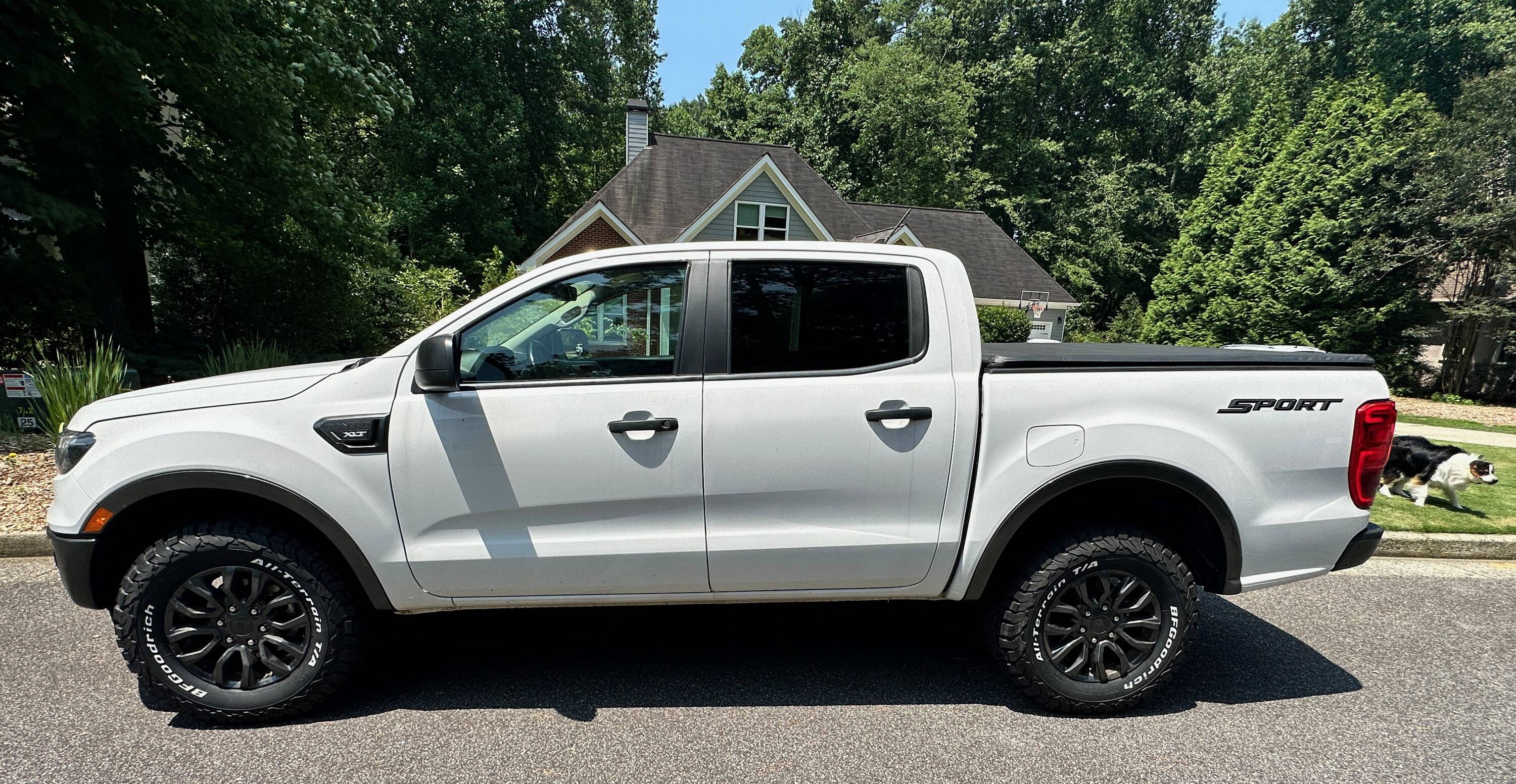

Thank you to everyone for the advice - went ahead and update my tires to BF Goodrich K02 265/70R17 - Really love the look and added height.
Nice!!

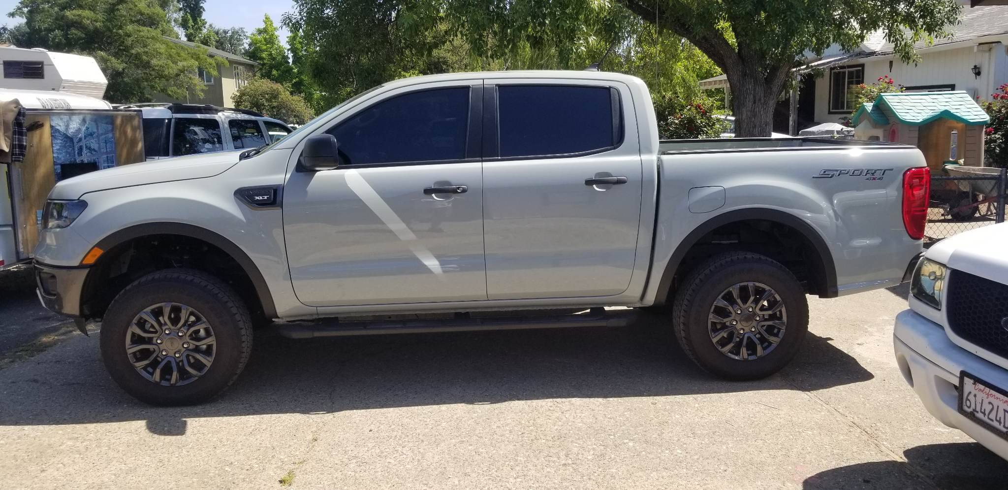

I fitted Yokohama Geolander GO15 285/60r18, standard wheels. Went on no problem.
I'm looking into tires as well, can you post a picture? any rub? and did you lift at all? I just have a level kit on my 23
Loweredon33s
Dec 13, 2022
748
1,806
Baltimore
2021 Ranger
Performance person
So what/how much did you have to cut, bend and remove?
because I don't think anyone can get a more perfect look, this is the size I'm gonna cram on my tuck from just seeing yours lol
I removed the crash bars, cut the brackets, stretched and trimmed the fender liners and bent the core support.
I no longer have those tires though. I now have 285/60/18 and they don’t hit anything at all and are so much lighter.
Those look really good also, I'm really fond of tires that fill the wheel well a lot.
I put the 2.5" leveling kit on my truck, I've just been trying to find a good fitting tire setup that I at least don't have to, uh bent the core support lol
