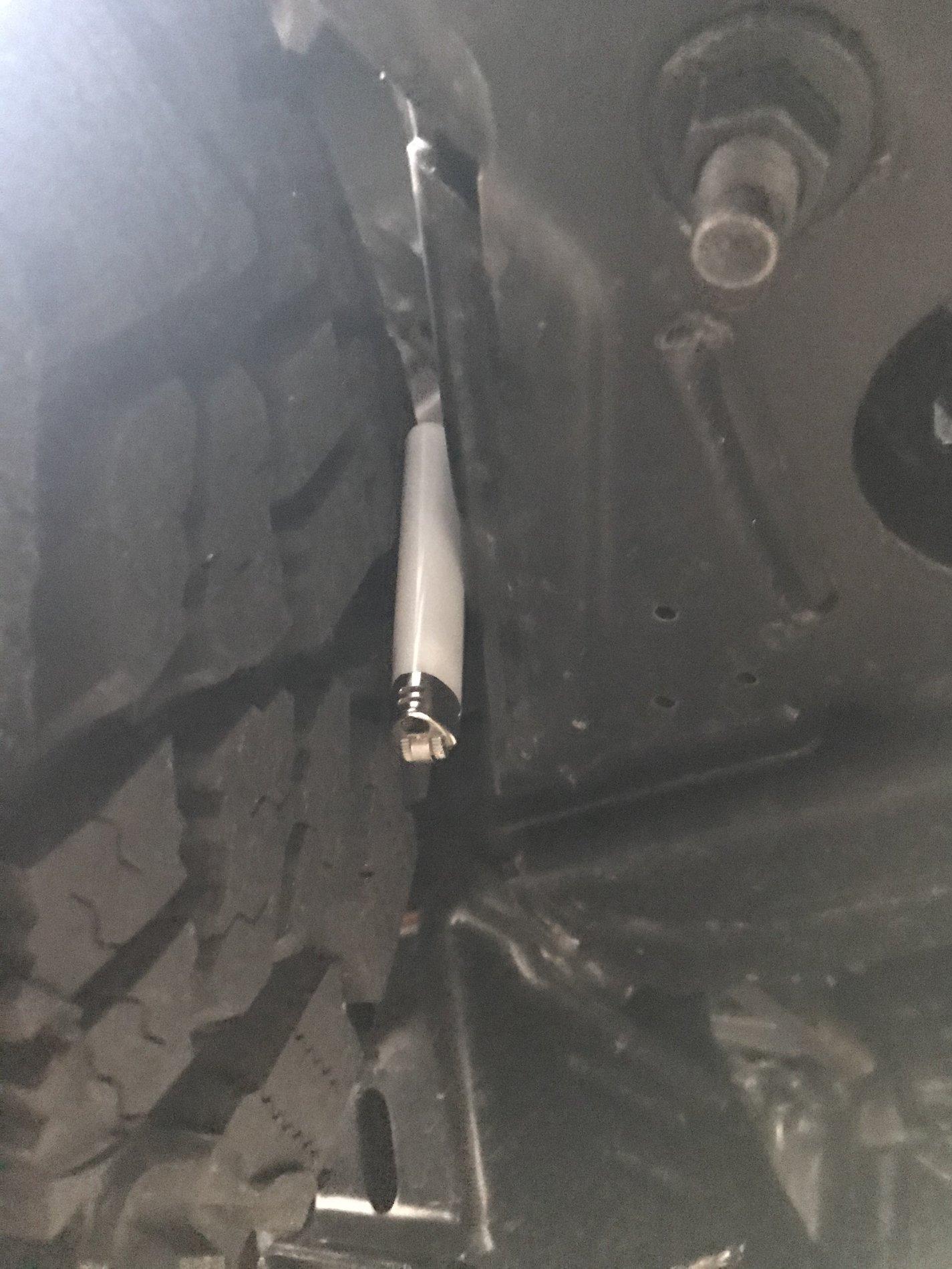

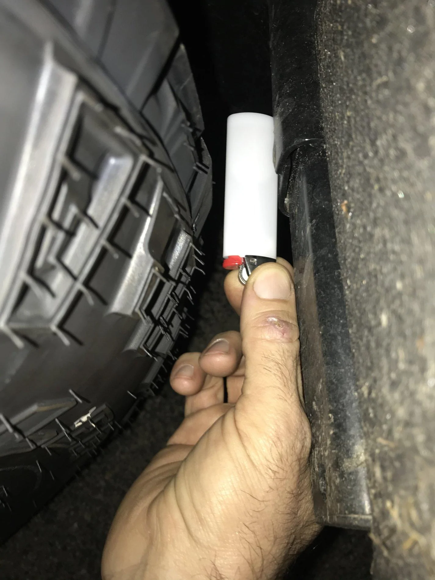

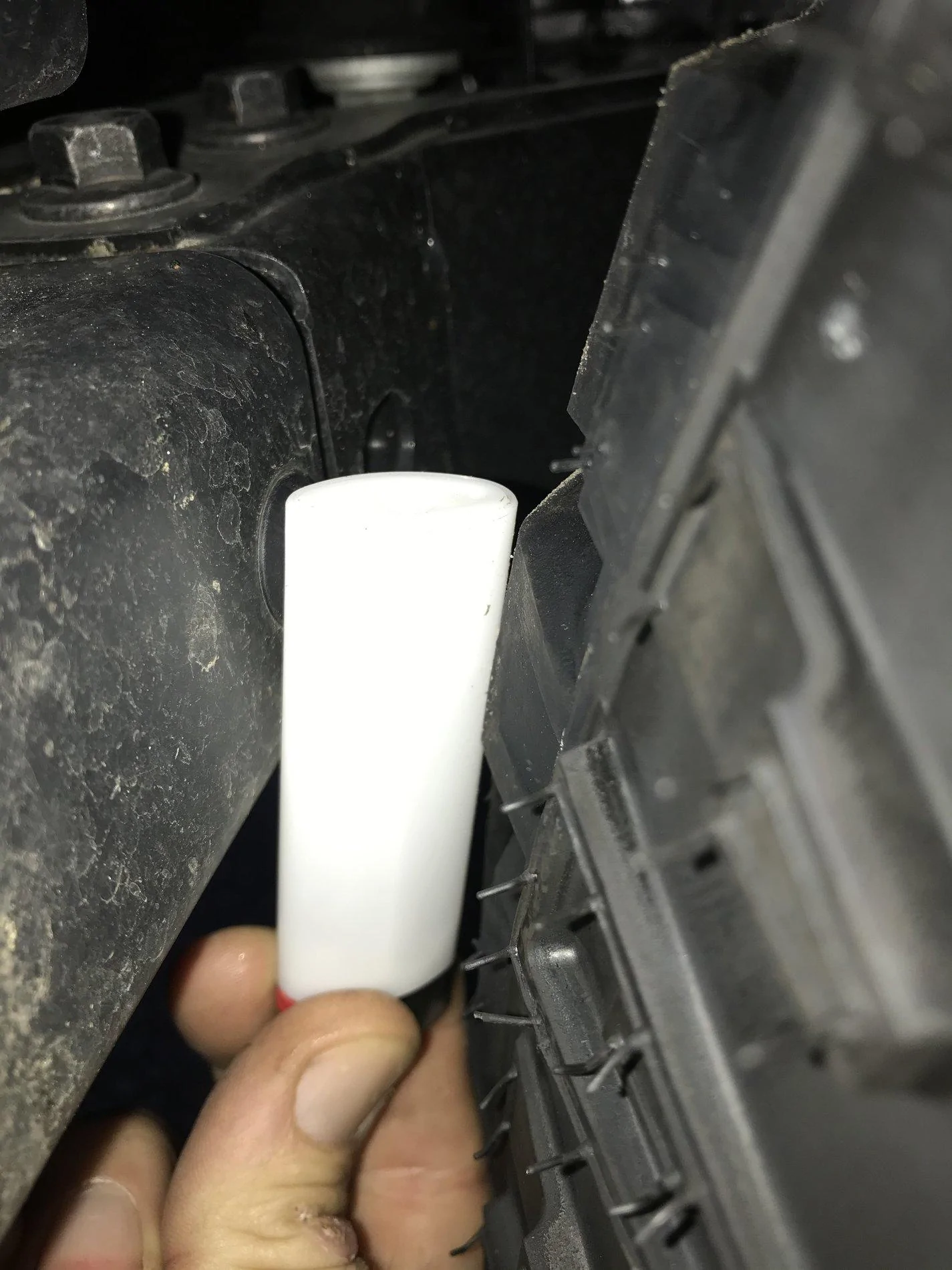

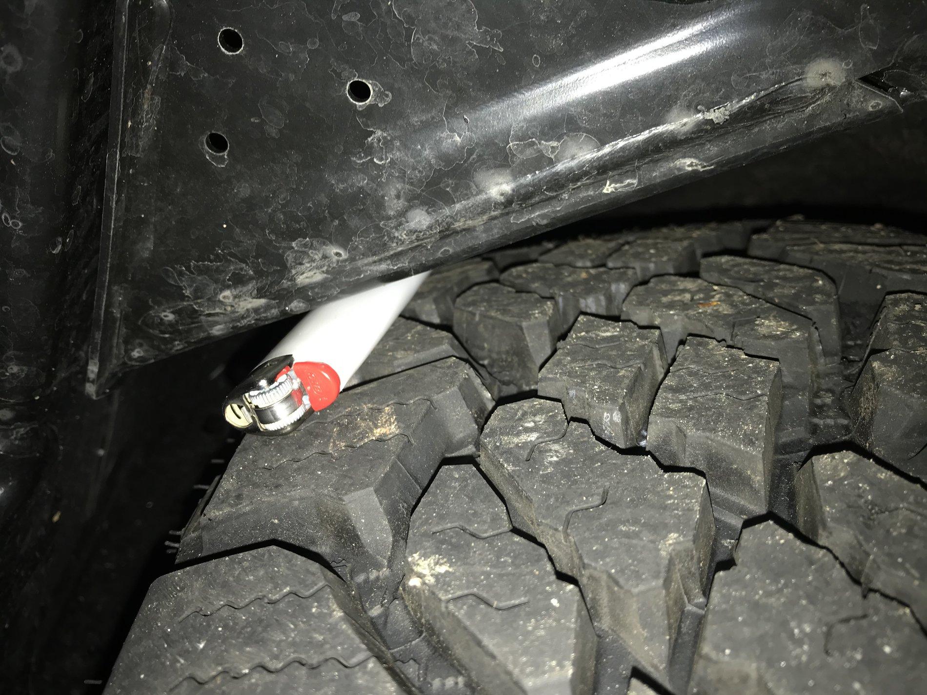

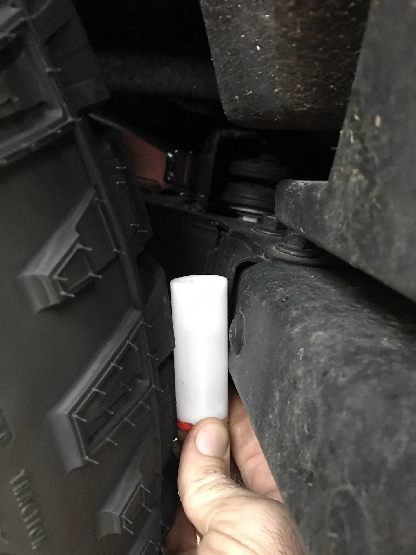

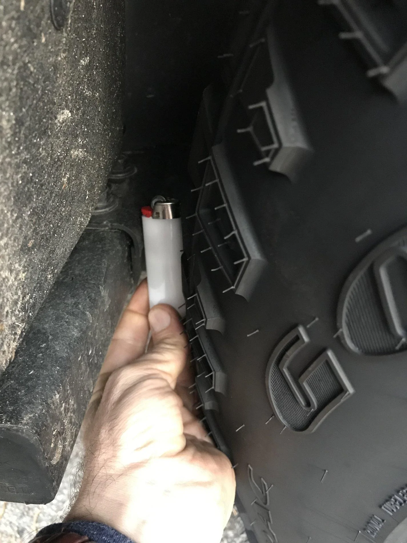

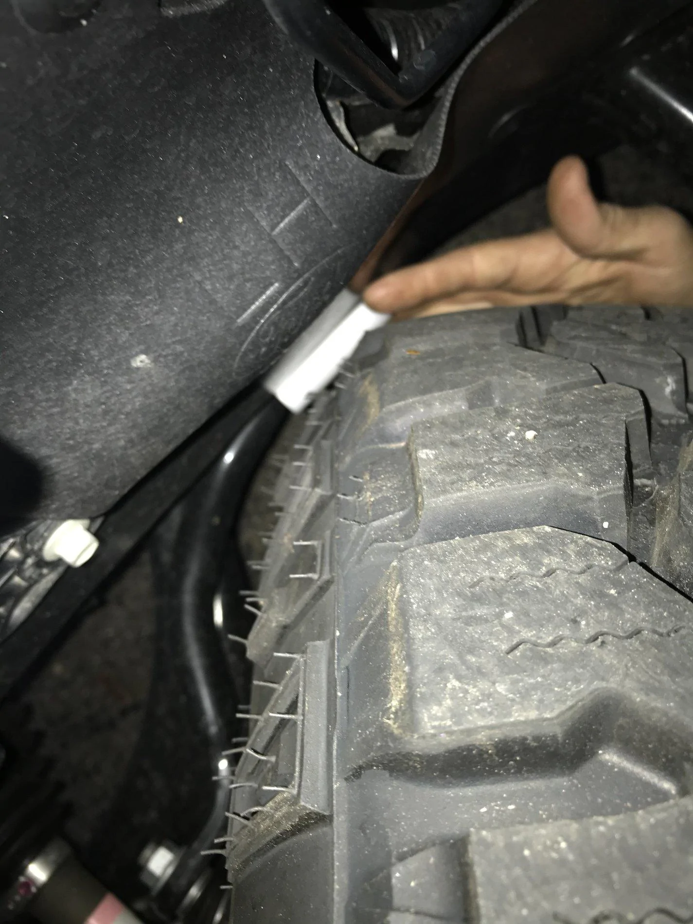

the lighter fits loosely at the rear, and tightly in the front. Lighter dimensions are 5/8ths thick and one inch wide.
