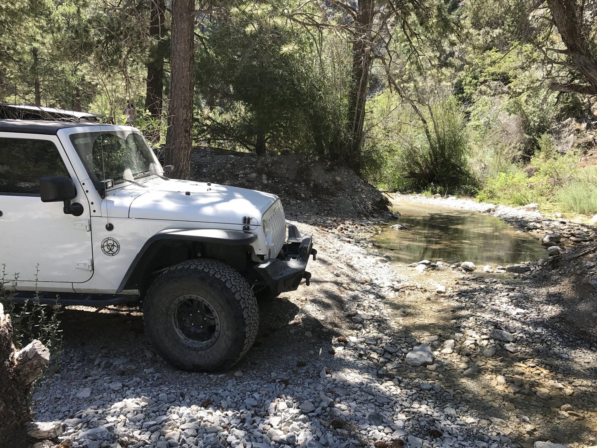

I had 35” ko2 on my wrangler. I rotated about every 7-8000 miles. Sooner if off-roading lost a wheel weigh or vibrations developed (happen once)
Drove 12k miles a year. Had 30k miles on them and never got chunking of the thread blocks. Went off road fairly often. Tires still looked good when I traded the wrangler in. Would not hesitate to get them again. They were good at staying balanced even with those heavy meats.
At 30k they were starting to look well used and chunking was about to start. But the razor sharp rocks in this desert will accelerate ware and cuts.

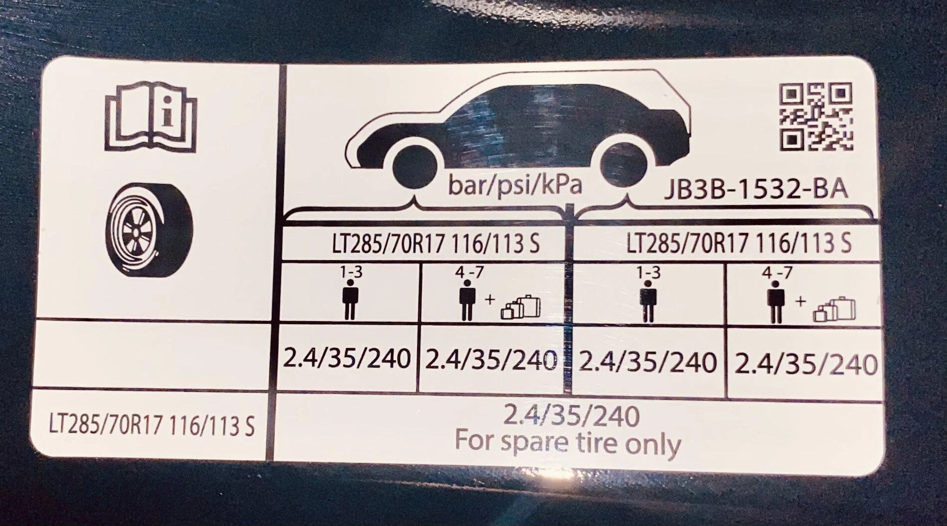

Galion
Luis
Feb 17, 2021
143
Charlotte NC - Lima PE
Ranger Raptor
Civil Engineer
These are Ranger Raptor OE tires. Ford recommends 35psi.
A Raptor outweighs a 4x4 2019+ Extended cab Ranger by 600lb
You’ll be more than fine with 34 psi
