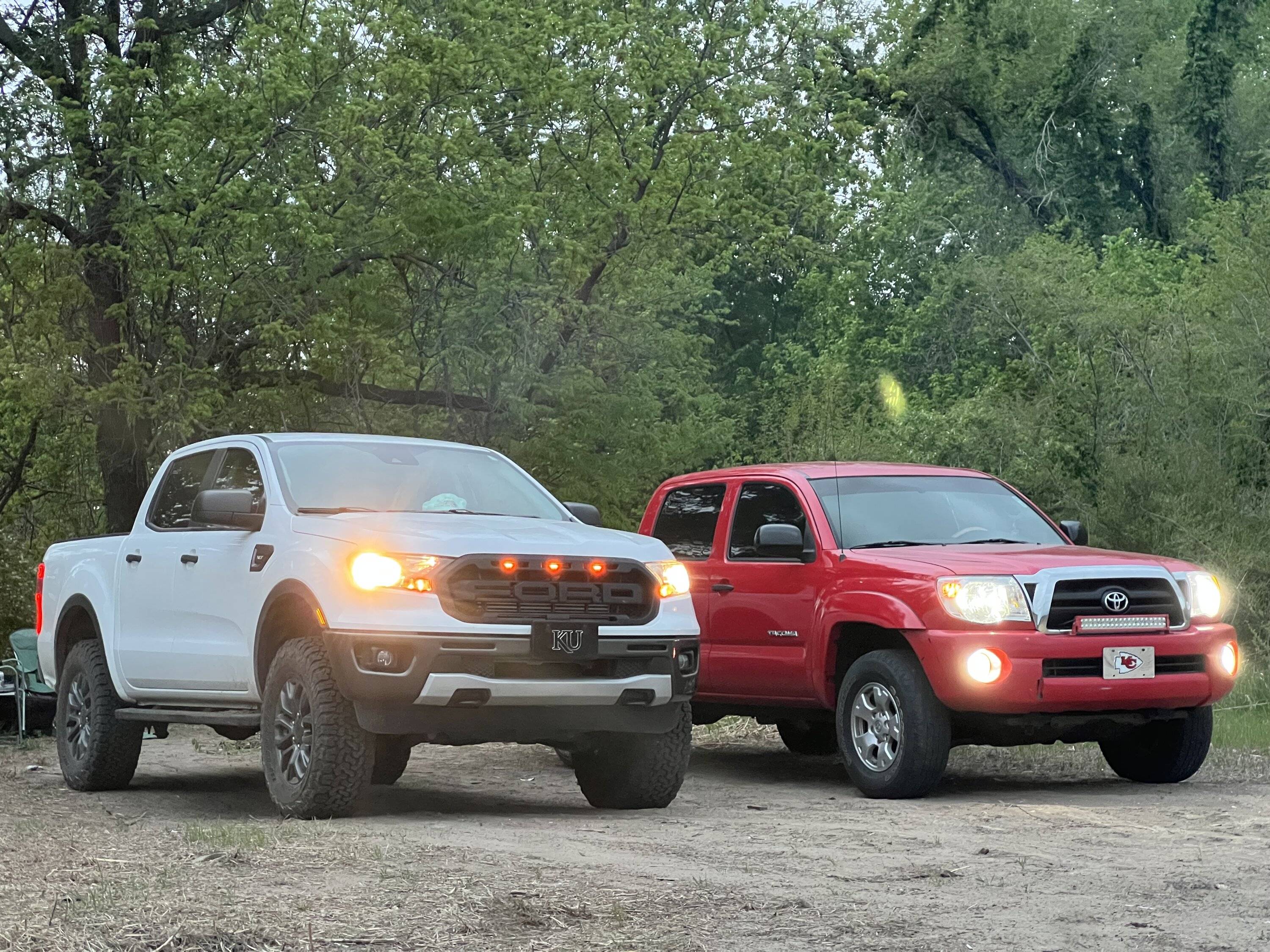

285/70/17 K02s on stock rims with .25 spacers up front. 2.5 in level kit.
