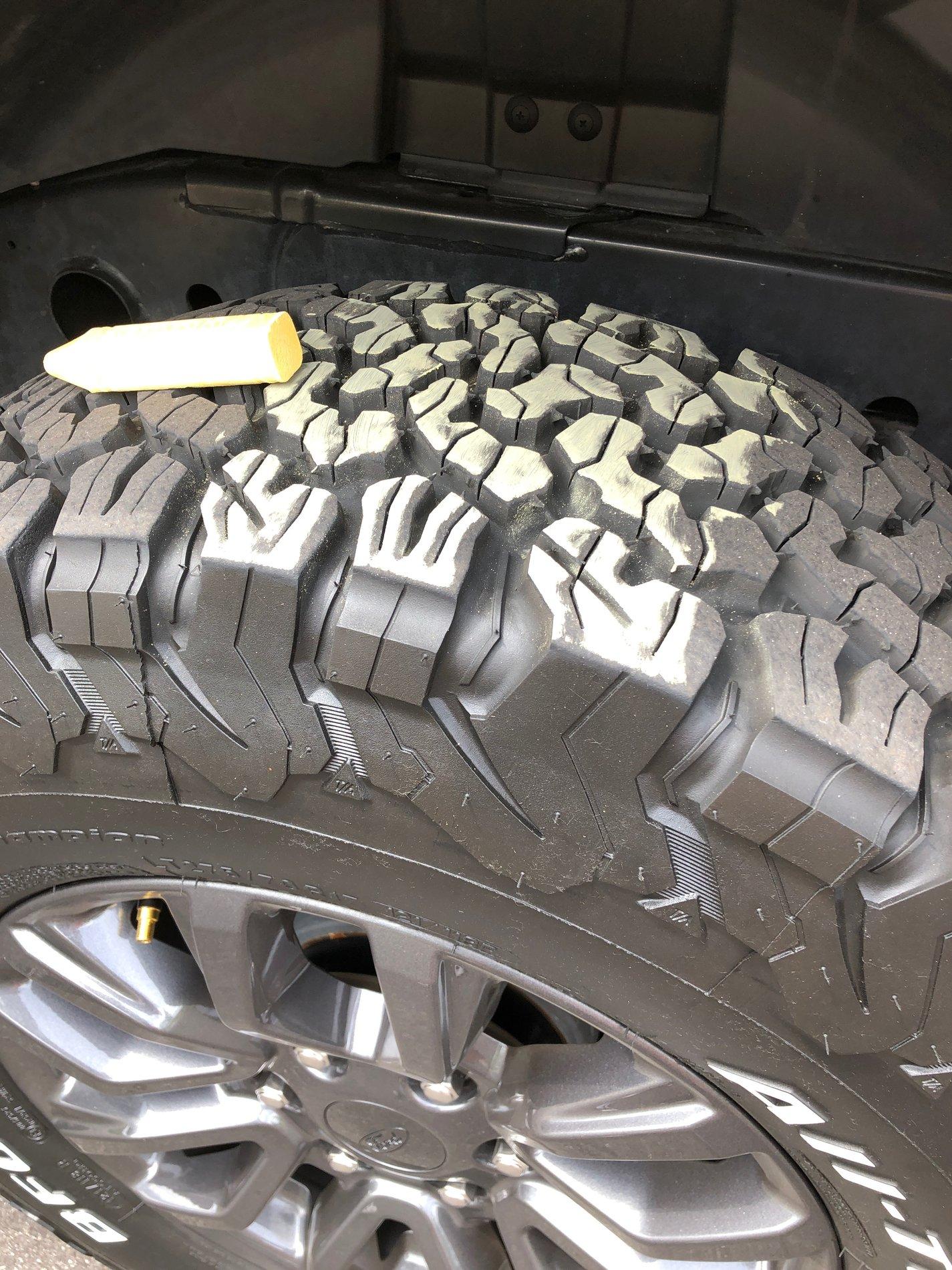

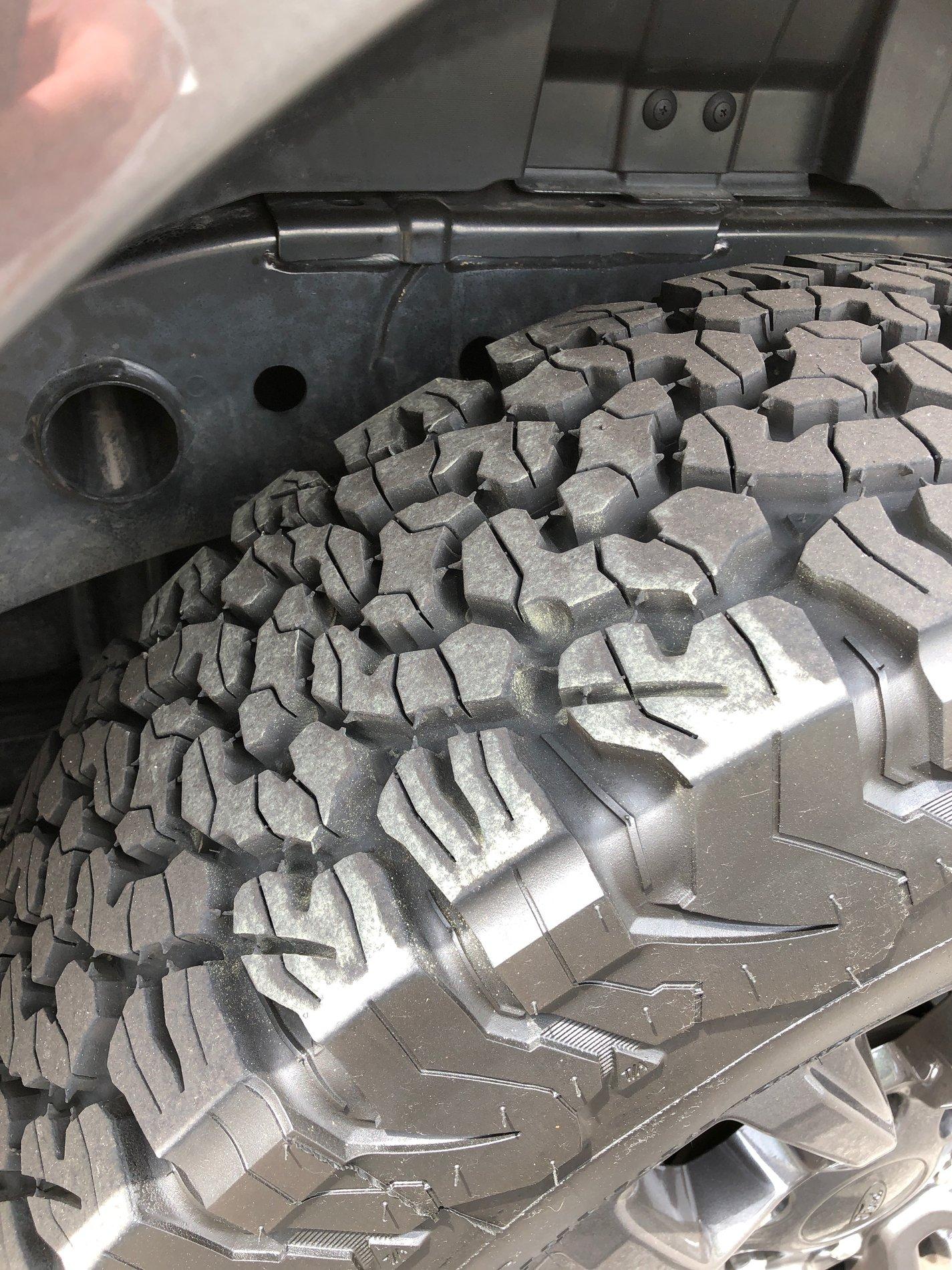

I finally got around to the chalking process; so I thought I'd share what I found.
First off.... I headed over to Michael's Crafts for some YUGE "sidewalk chalk":
I aired up my tires to 42psi and headed to a local parking lot where I could get a clear & straight minimum 100' run. I over inflated as it's easy to let air out, but I do have a 12V air compressor in my on-board tool kit if I needed more air.
I used the side of the yellow chalk stick and colored about 4-5" across the tread: making sure to go all the way to the inside/outside edges:
I did this to each tire, and then slowly drove straight for approximately 100'. I stopped and made sure the chalked area was in view on each tire.
This first attempt at 42psi showed most of the chalk was off the tread in the middle of the tire, but the outer 1" or so on the fronts and a little more on the rears still had some chalk. (at this point I will add my truck has no load, and I don't plan to drive it loaded, but if I did, I would adjust the tire pressure accordingly.)
I dropped the fronts down to 40psi and the rear to 39psi, re-chalked and repeated the process. There was still some chalk on both the inside & outside tread on the fronts, and again a bit more on the rears.
In the end, I have decided based on my set up and these results, to set my tire pressure at 39psi in the front & 37psi in the rear.
I can't really tell a difference in the ride vs. my original 38psi set up. For me, this exercise was more of a "confirmation" of the proper psi and an attempt to set the tires up with a pressure for optimal wear.
Hopefully that is the case and maybe this can help others to set their pressure as well.
