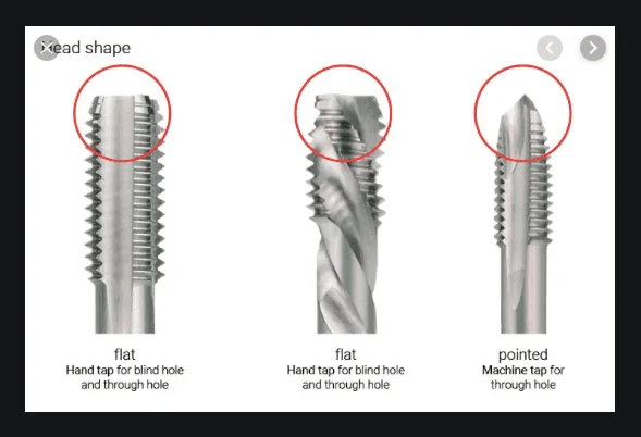

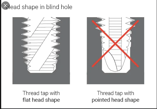

The correct choice is to use a “chaser” tap. A cutting tap is designed to create new threads, whereas a chaser tap is designed to clean, re-form and restore existing threads.
To my knowledge there is no such thing as a "Chaser" Tap. Of the two shown later in this tread the one with a Blunt nose is a blind hole tap which is used when hole does not go through the material. The point od the tow is used when the hole goes all the way through. Blind hole taps are a little more difficult because they don't center as easily during the start.

Dan there are chaser taps,they just clean threads and not cut them. Bret

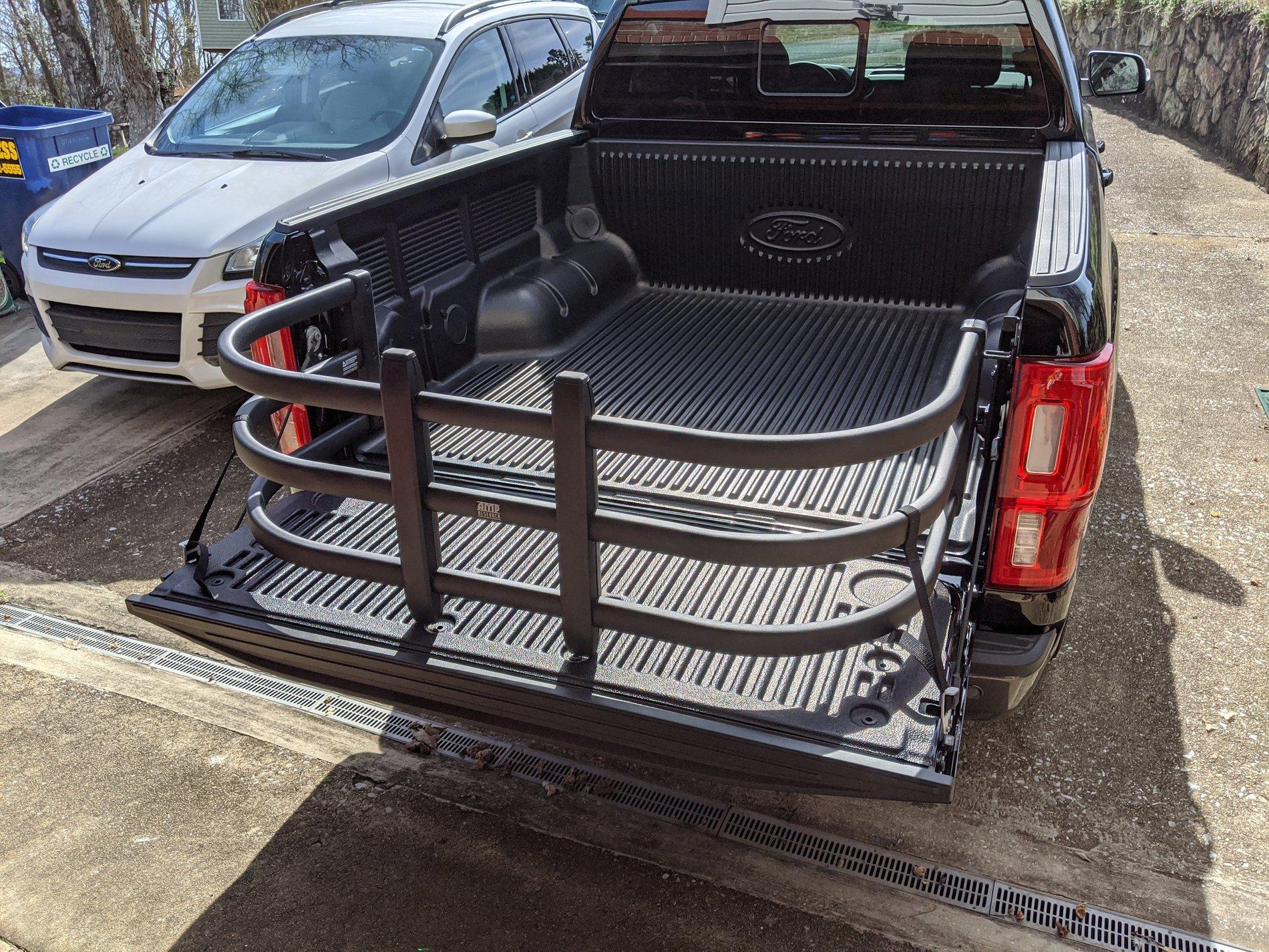

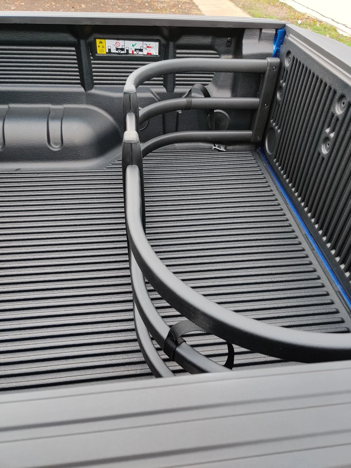

I installed the Amp research yesterday. It was easy just had to drill two holes in the factory drop in bedliner.
So you just drilled the holes and bolted through the drop-in bed liner?
I'll be installing mine tomorrow and have been looking for pics of an install with the drop-in liner. I was thinking I might need to cut a notch out of the liner on each side with a Dremel. Haven't really looked closely at the liner or the extender yet. (just got it and it's been raining all week)
Looking forward to getting this installed!

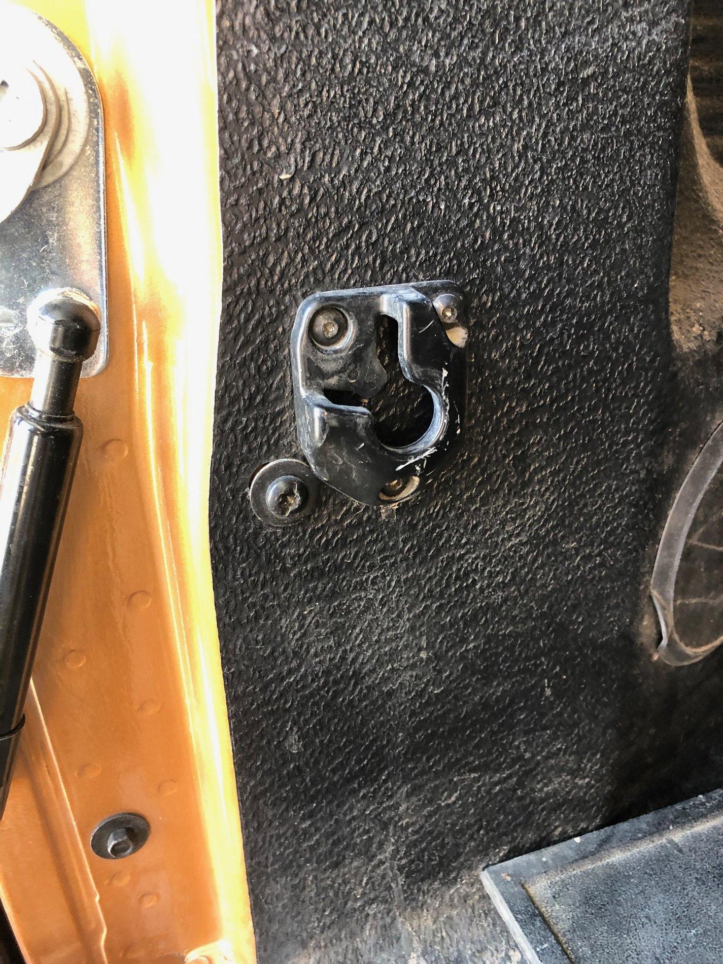

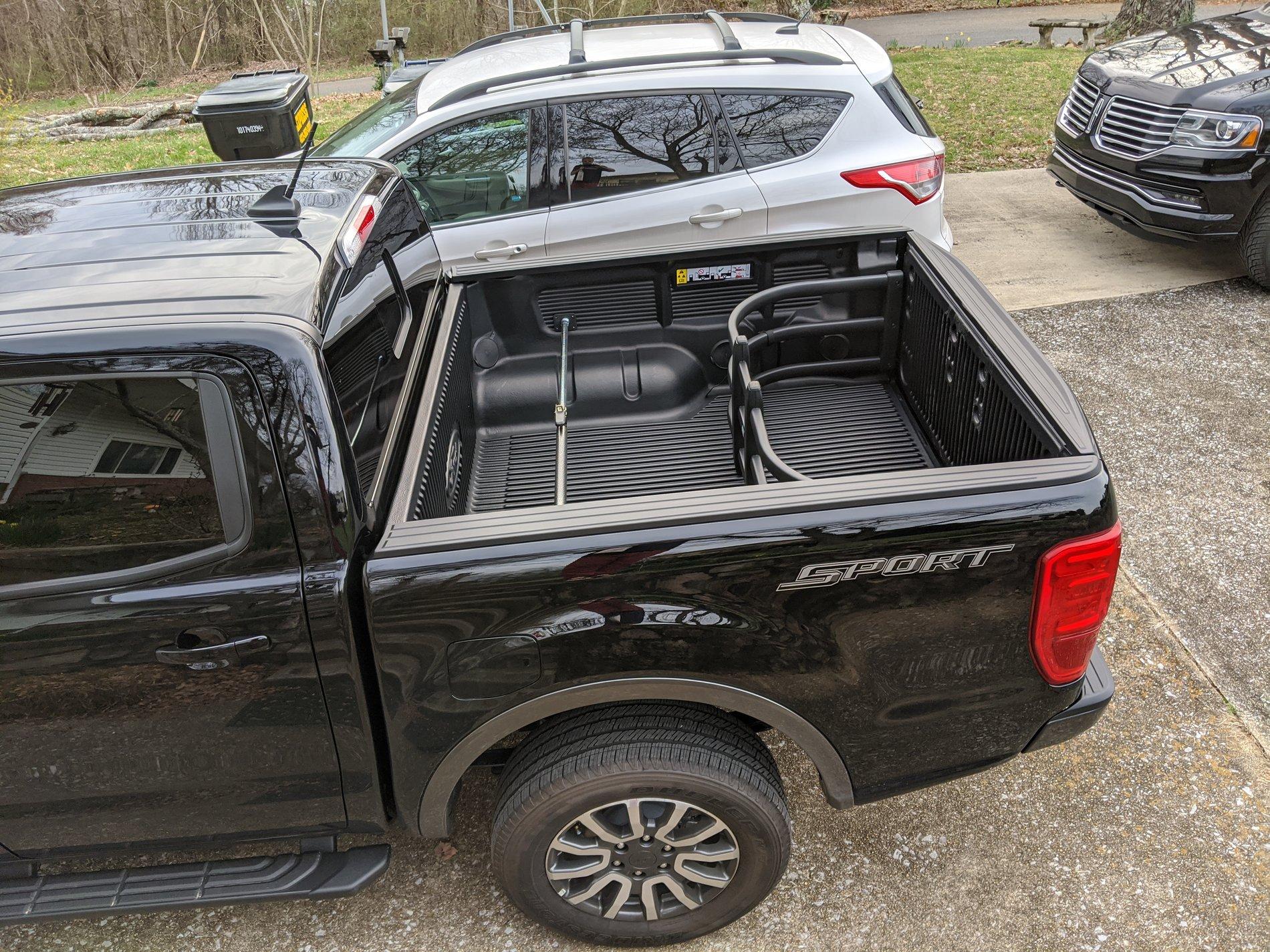

I have the drop in bed liner and you can install it without notching it out. I actually have my bed extender from my Tacoma (the mounting brackets are different from the Ford ones) and I use it just about everyday and it's held up fine. The Ford mounting brackets are a lot better as the plate screws right into the factory threads. Mine I had to remove the taillights,drill through the liner and the metal to make my own holes and then just used the original nuts/bolts.

Perfect! Thanks for the picture.
Looks like this will be as simple and painless as I'd hoped.

Anytime! Your's will be much easier than mine was. I always try to retro things that are perfectly good and reuse them if I can because I'm (cough, cough) frugal. :)

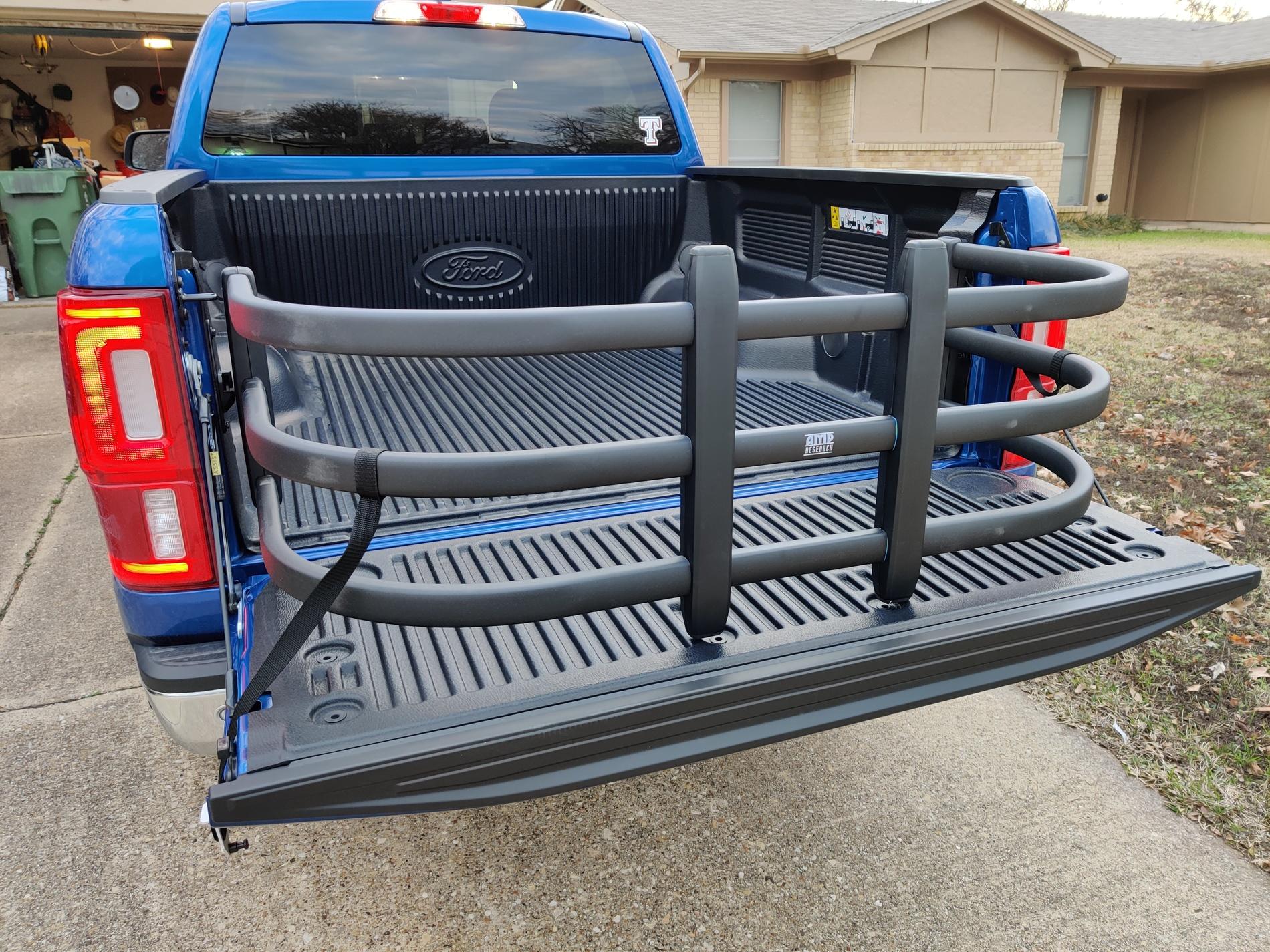

That's all I did, the kit came with a plastic washer, so I just didn't use the washer and used the bedliner. I also put some blue lock tight on the bolts.

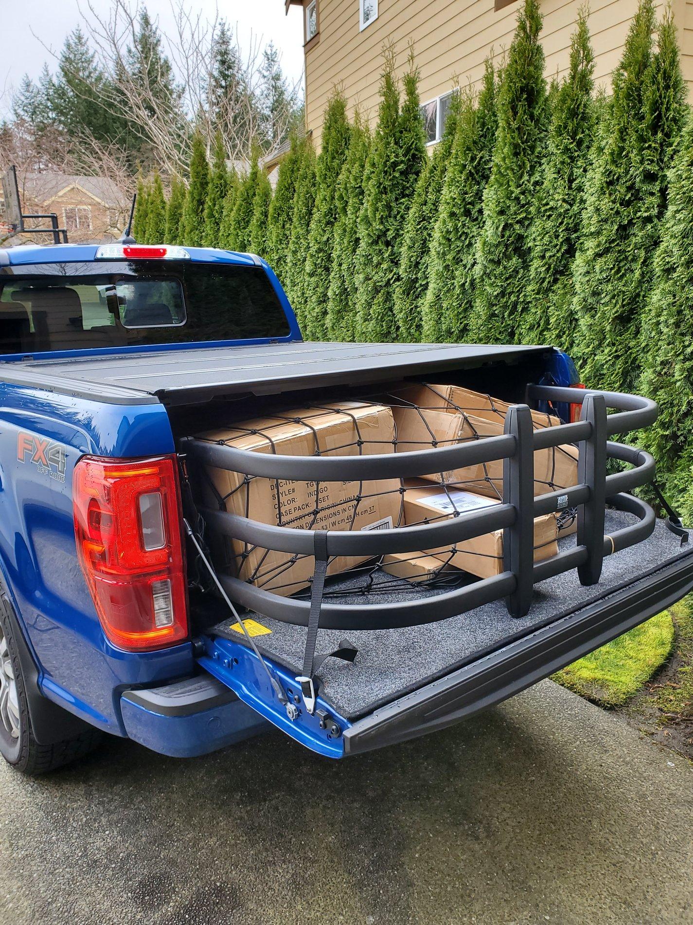

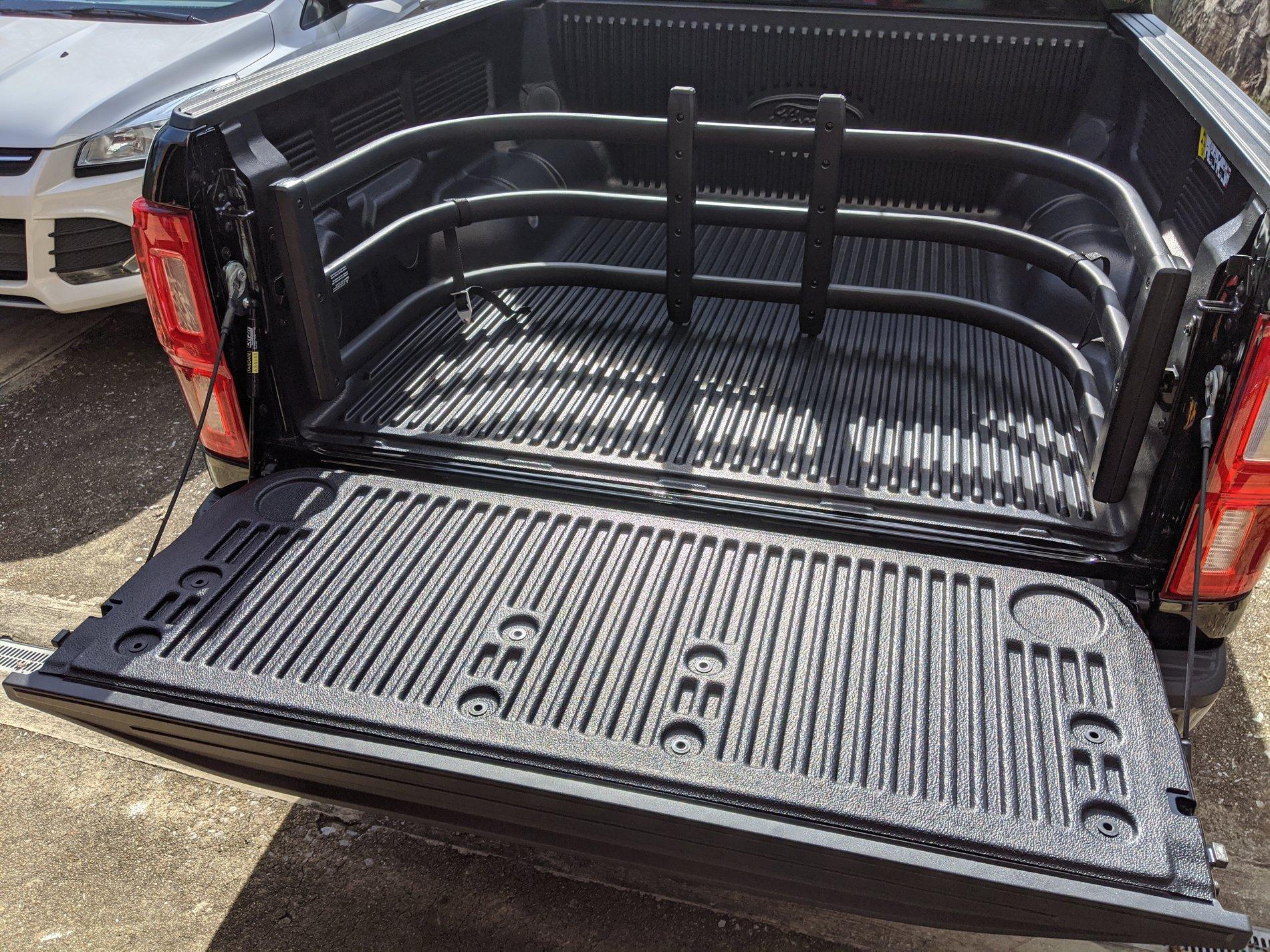

Mine just arrived today! Got the MAX one as I wanted more space and it was nice to see it works with the MX4. I have to haul some boxed furniture and the pieces are a little too long for the bed. From the pics it looks great installed!

Installed this morning and working as intended!
137,231
I bet you'll find yourself using it a lot,they come in handy for a lot of different uses. I leave mine flipped inside the bed and use it all the time to corral stuff from going all over the place.
