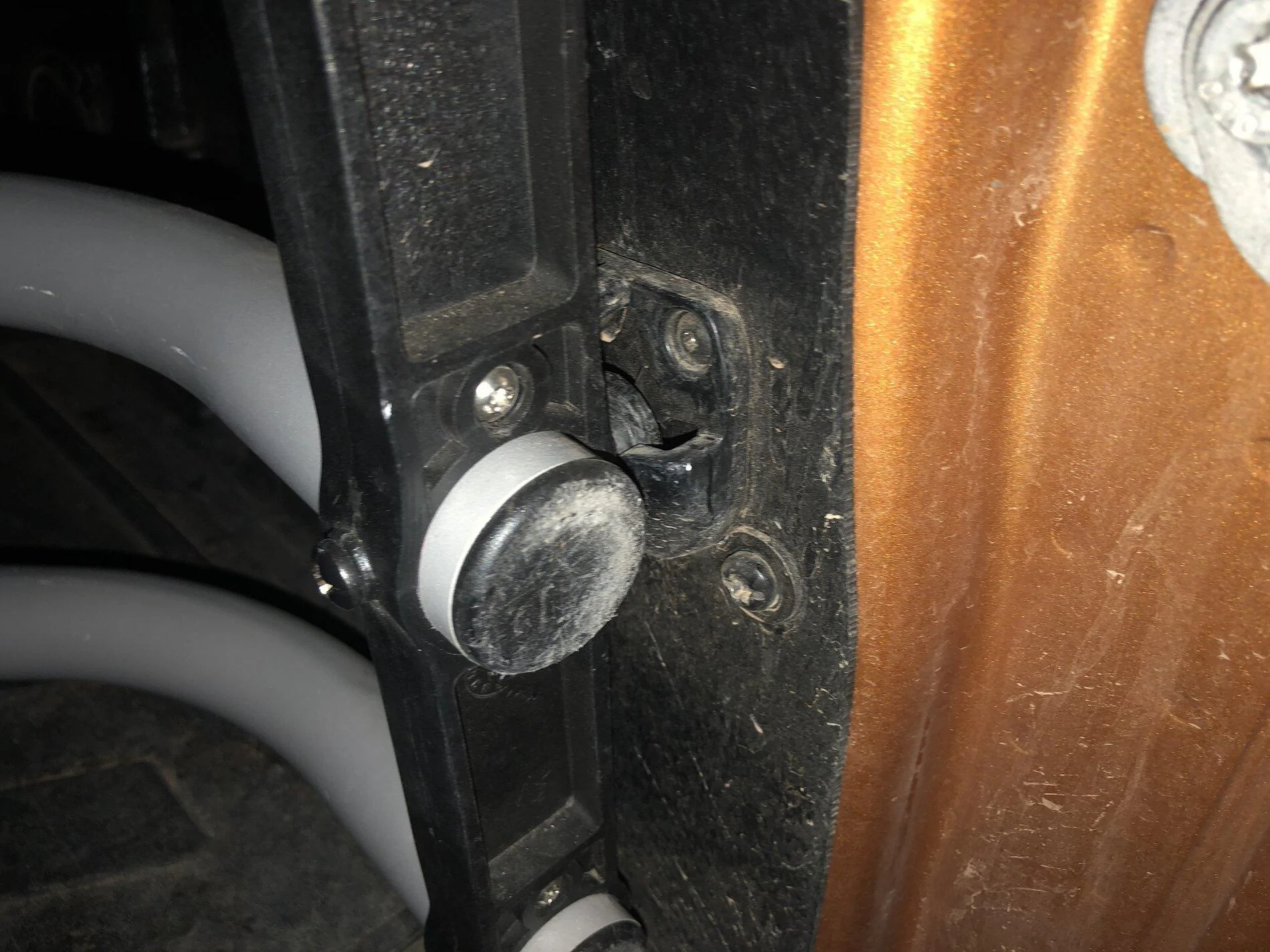

Do you have the mounting hardware along with it? I used my old bed extender from my Tacoma and just used the old pivot. I just pulled out the taillights and drilled into the sides and mounted it. It's worked great for over a year now and I use mine all the time.

It's available.
I happen to have mine. Going to install it tomorrow.
I scanned the instructions for you to read.
It's on. :D
Had to buy a rivet gun.
Instructions is fairly simple. You need to read it carefully because some parts only fits in one direction.
And I'm happy the bolts screws directly into the holes you see on the side when you put the tailgate down.
