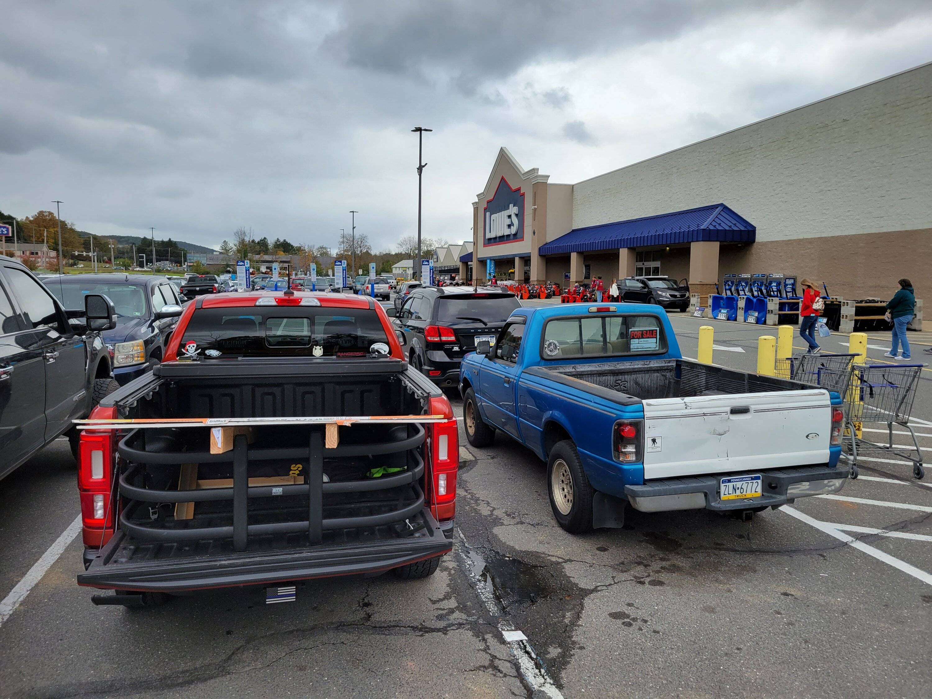

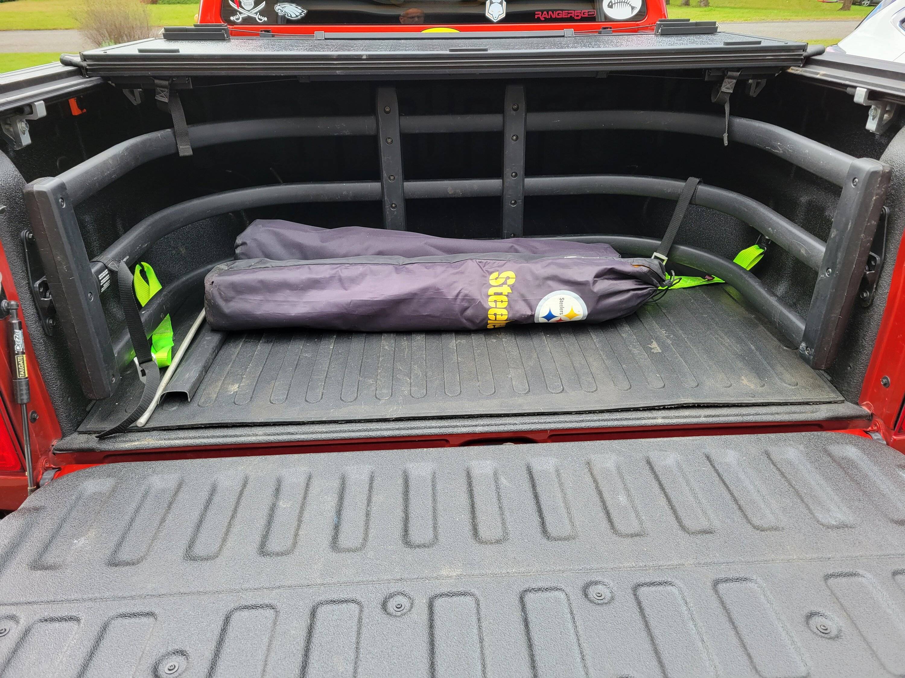

I use mine all the time, on my 2019. Just yesterday to pick up drywall from Lowe's. When I don't want it on, it just lifts off. It's AMP Research.

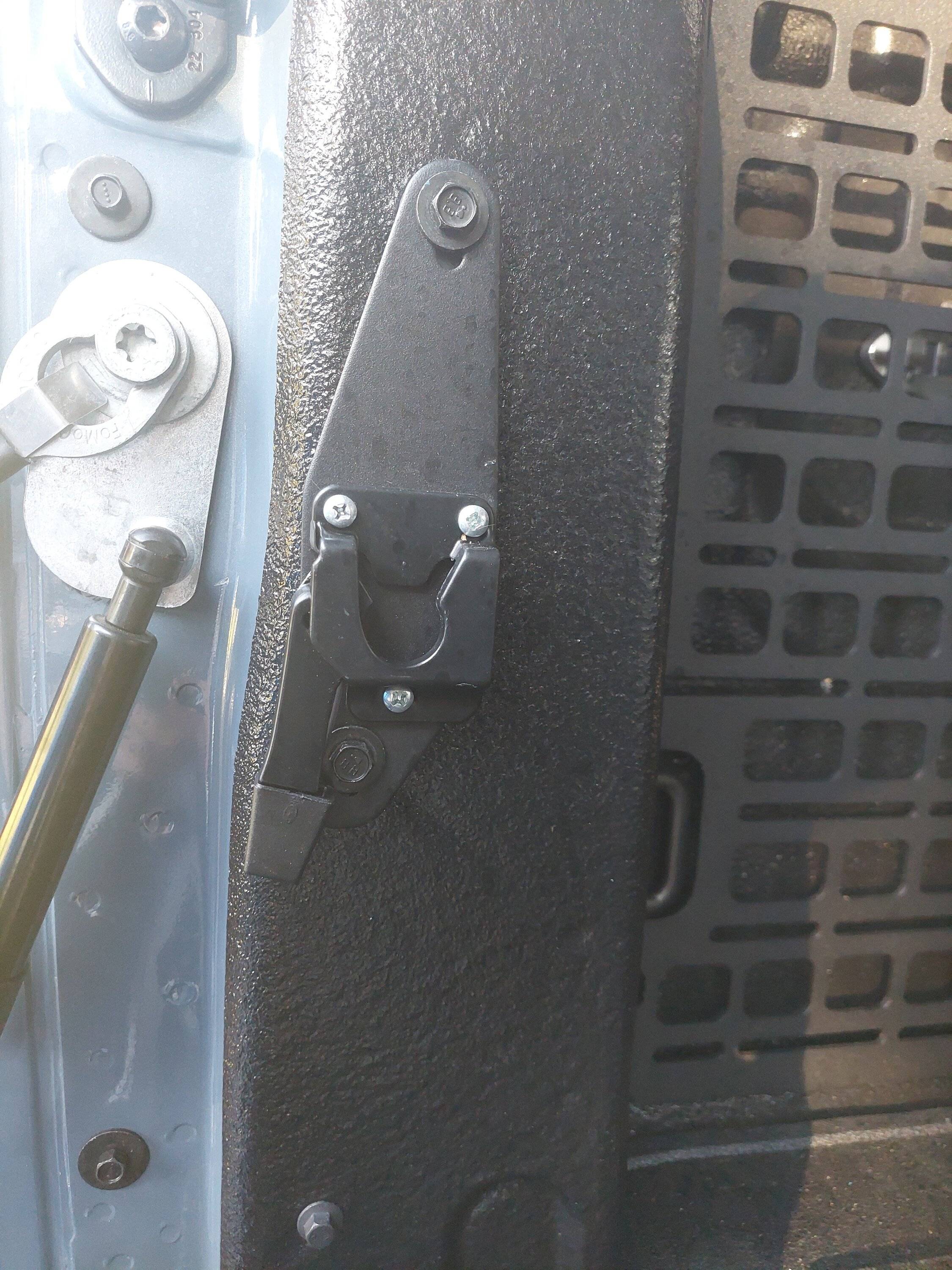

1. Hopefully, when they did the spray-in liner they put placeholder bolts in prior to spraying. Otherwise, you're going to have to spend time tapping out the holes. I was lucky in that I knew I was getting a bed extender and put in placeholder bolts myself so I spared myself the pain of having to clean out/up the threads.
2. I don't know if the Ford-sold extender comes with brackets. But if it doesn't, just buy the 74613-01A I mention above.
3. EDIT. At first blush, I don't think there's a need to get the other bracket. I didn't need it on my Bakflip. BUT I don't know how high the Ford hard tonneau raises. You'll need about a 2 foot radius (from center point of the bracket) to successfully flip the bed extender from tailgate to bed. So you might....
The attached photo shows you the bracket, where it mounts, and the mod I had to do when I switched to a topper (a mod you might not have to do).
Cheers.
P.S. I do know from experience that sometimes the bed extenders are sold for a particular vehicle, but include the wrong brackets..... Just FYI.
P.P.S. If you do have to do the mod, you'll be drilling out three rivets per side. I used blue Loctite on the bolts/nuts (it's a tight fit and didn't want to have to play the tightening up game).
