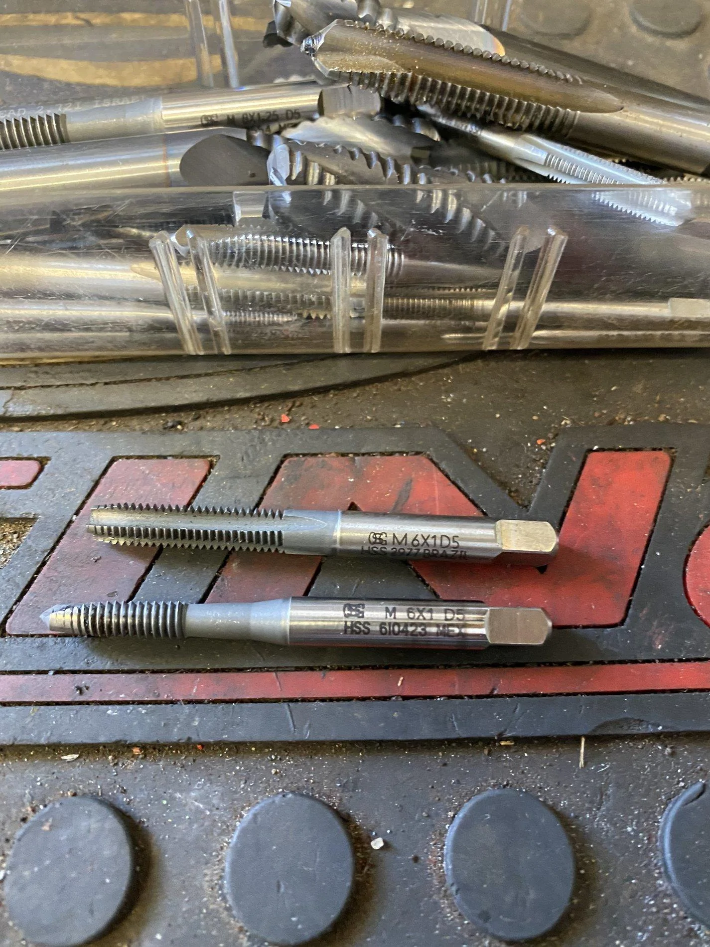

This comment isn't for me, but having installed this the other weekend, a tap made quick work of cleaning the threads.
Nutty 5.0
May 23, 2019
260
506
SE PA
2020 LB Super Crew, 2012 GT500, 2015 VW GSW TDI
This was the tap size I believe I used.
