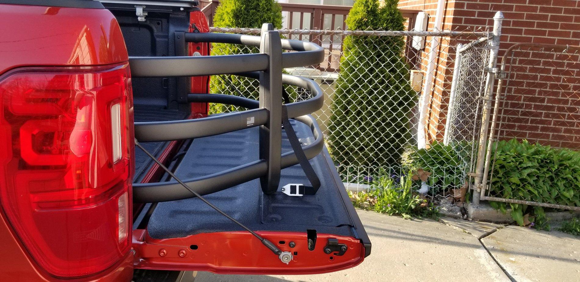

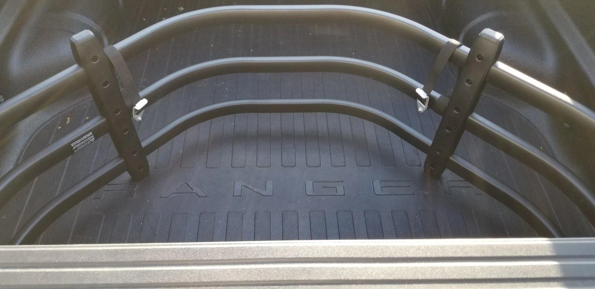

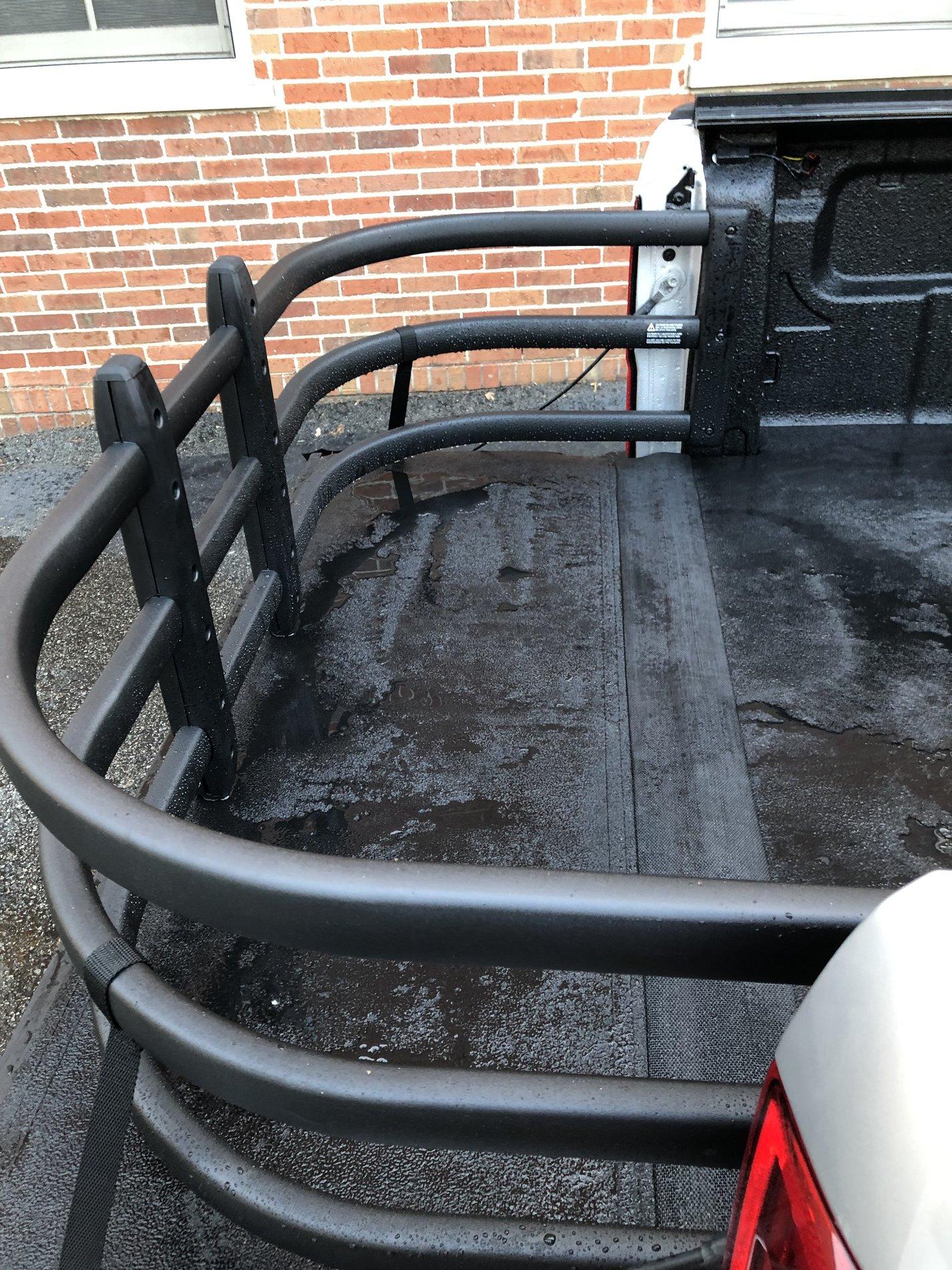

It's on. :D
Had to buy a rivet gun.
Instructions is fairly simple. You need to read it carefully because some parts only fits in one direction.
And I'm happy the bolts screws directly into the holes you see on the side when you put the tailgate down.
It doesn't look like a standard 4-wheeler would fit with this on. I like the materials used for this extender more than the version that goes to the corners, but I think I will be forced to use the other version due to the maximizing of the bed space. Can you confirm if a 4-wheeler will fit when using this extender?

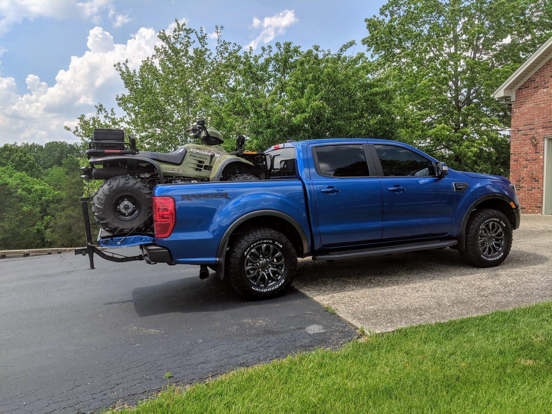

I'm thinking from this member's post that a 4-wheeler won't fit in this members bed because of the roll up hardcover and the arc of the extender.
https://www.ranger5g.com/forum/threads/2019-rangers-hauling-things-thread.1760/page-4#post-40773

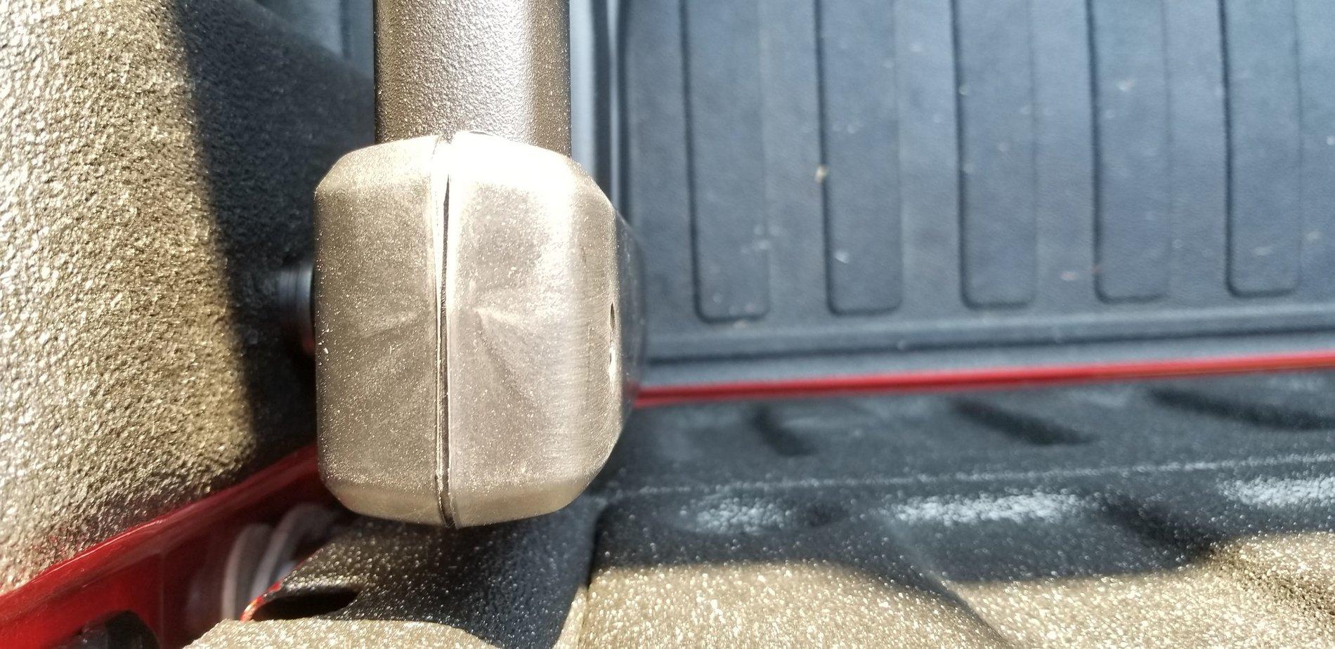

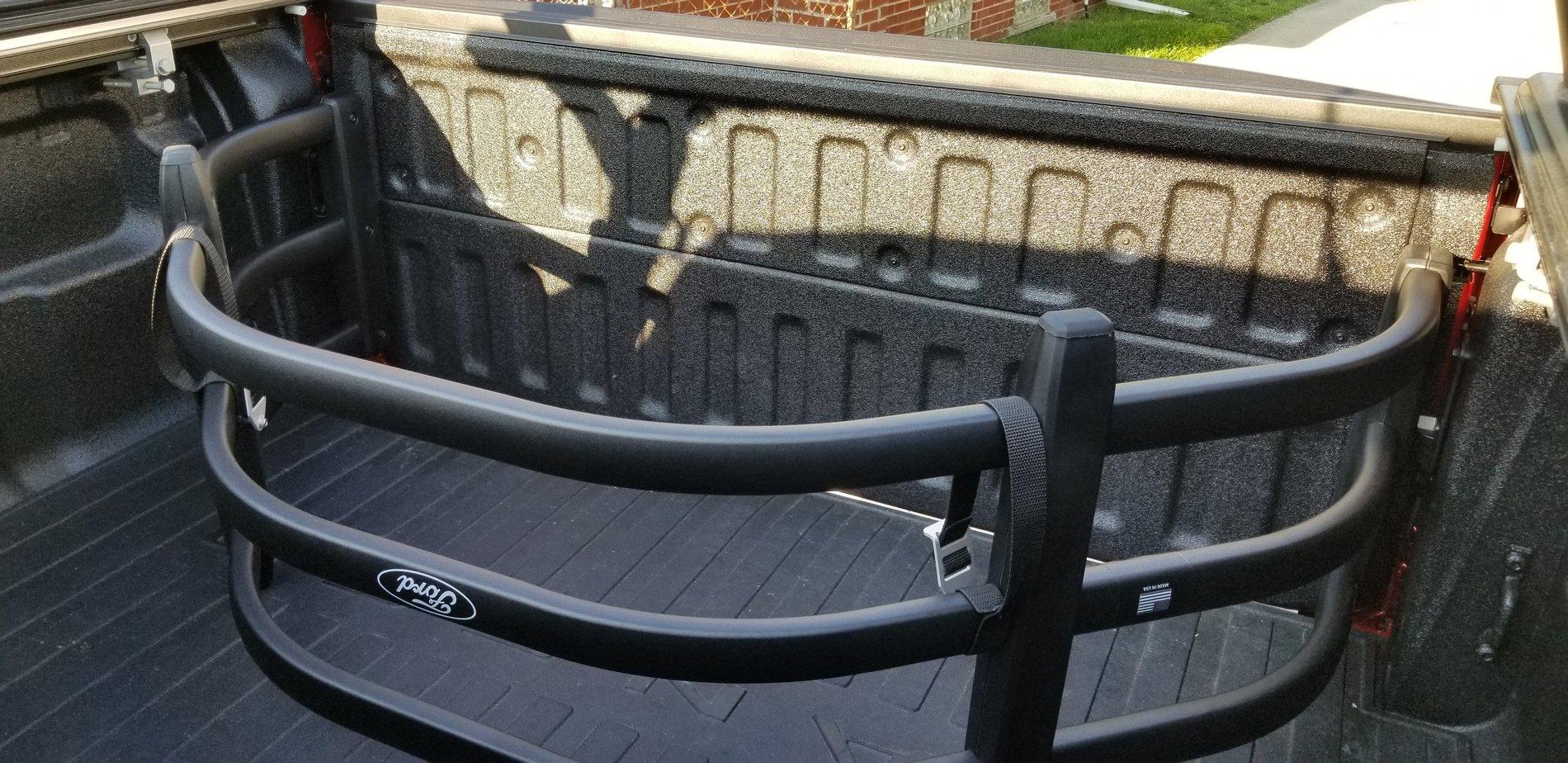

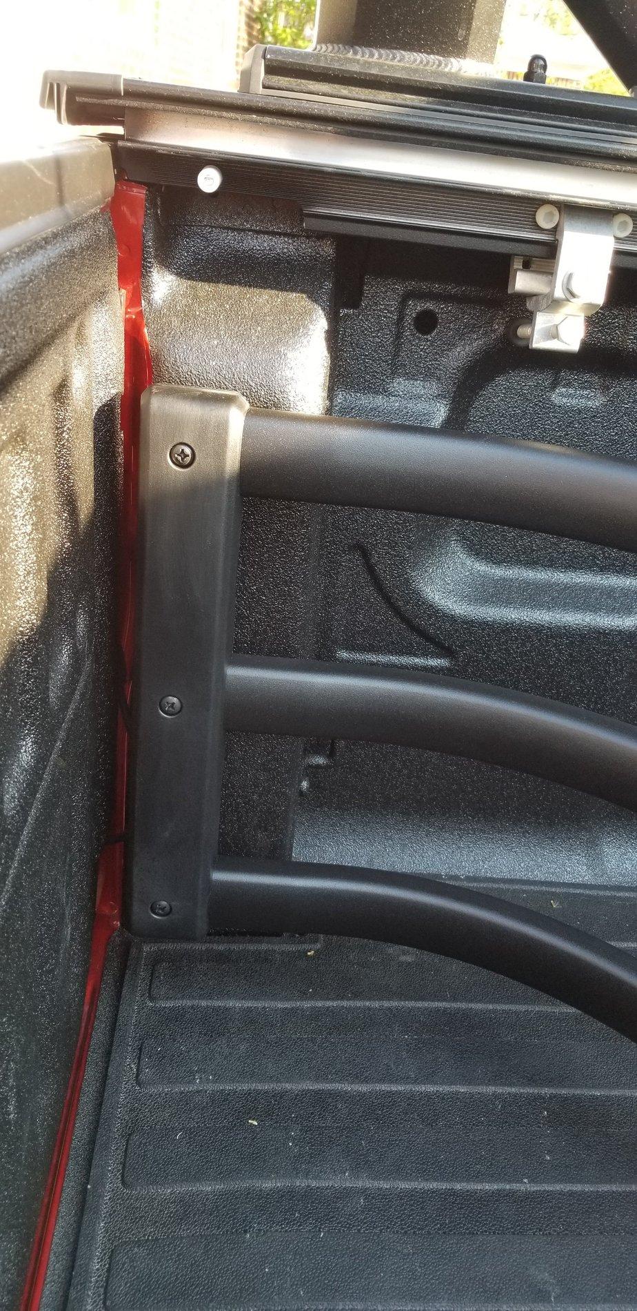

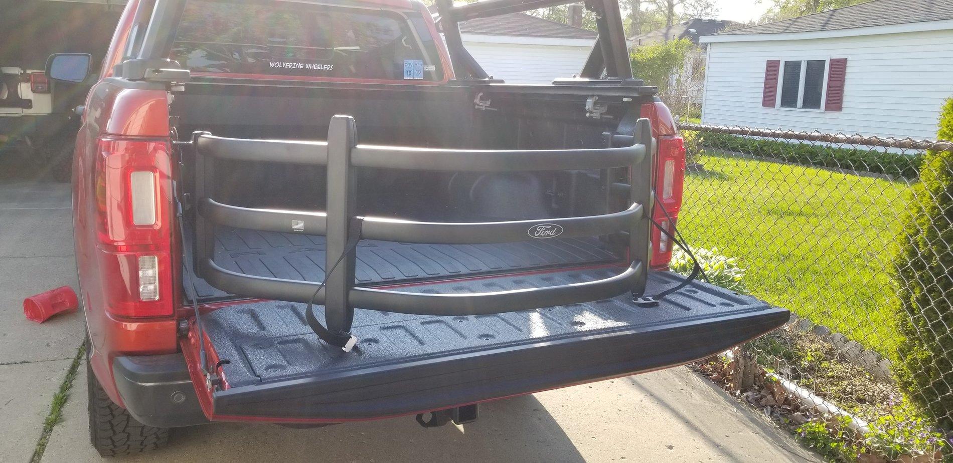

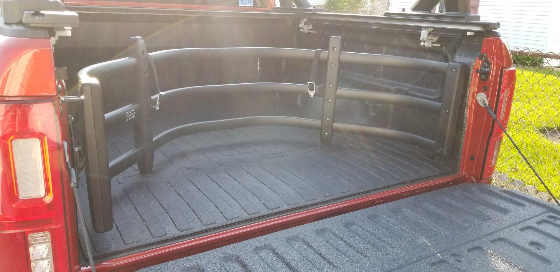

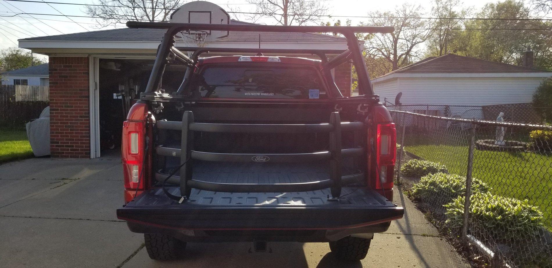

Finally got my extender installed! Hardest parts of the installation were cleaning the holes out that the bolts go into as the factory spray in bed liner material had closed them off quite a bit. And I definitely recommend the rivet gun for the installation as well! Got one for $10 at Harbor Freight and did the job just fine! Lastly, the extender does remove very easily by rotating it to a 45 degree angle towards the back and lifting up to remove! So you can easily install and uninstall the extender itself as needed! And for volume representation, went to Sam's Club yesterday and fit an entire full shopping cart worth of items in the corral the bed extender makes in the back, so there is definitely a good amount of space! happy with it so far!

Thanks for the photos...could never find a good side shot to see how close to the end of the tailgate it goes.

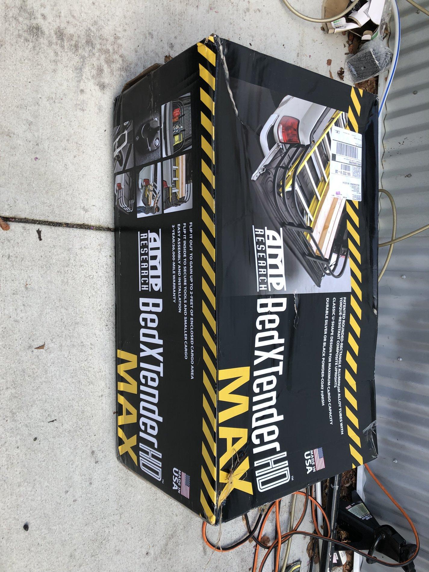

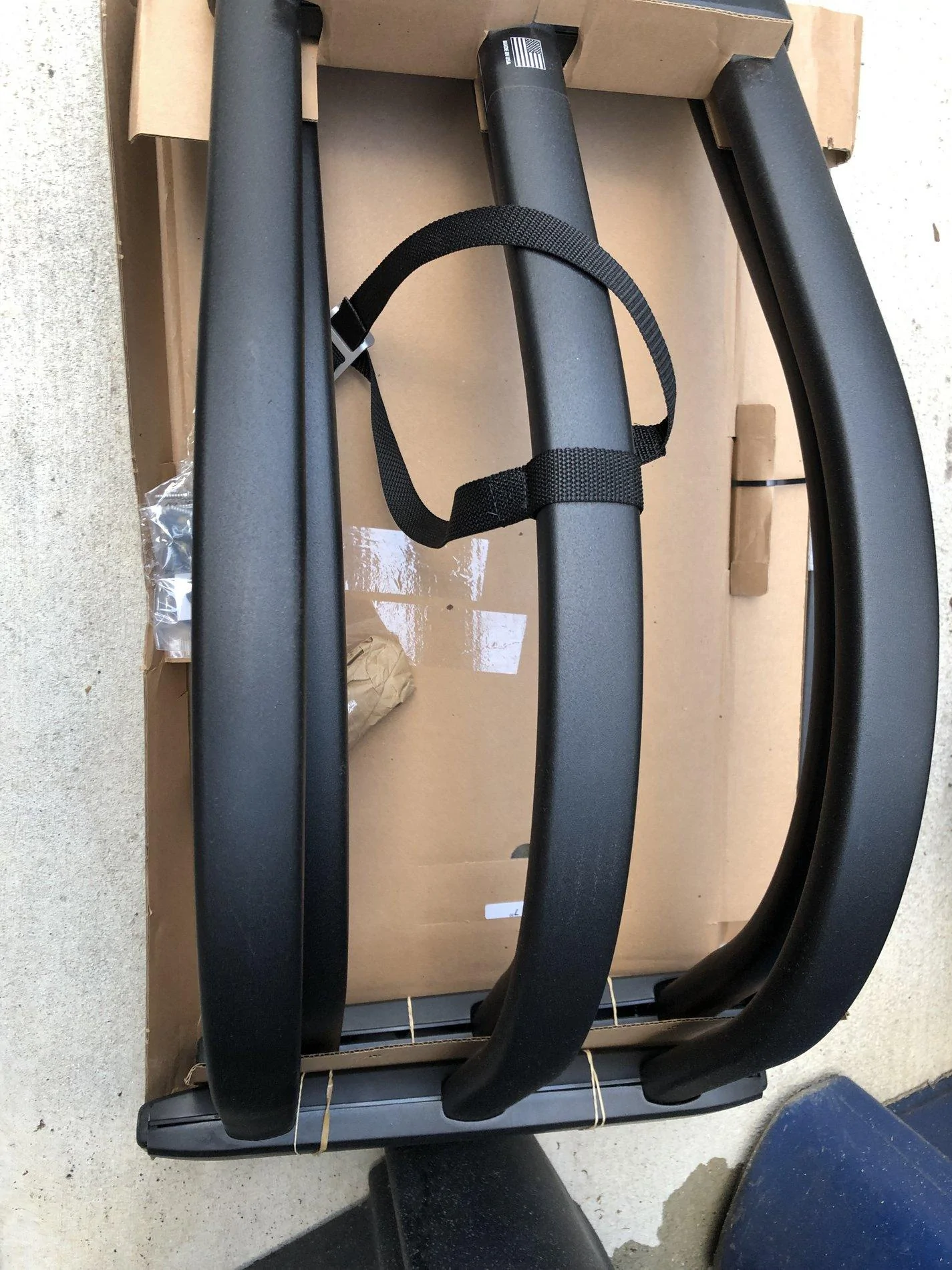

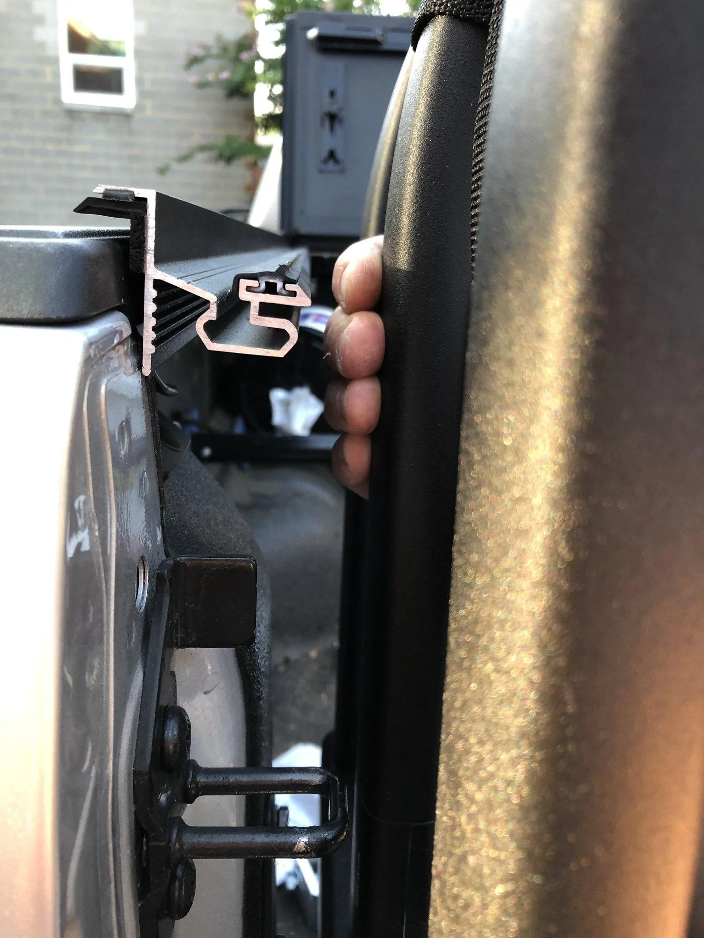

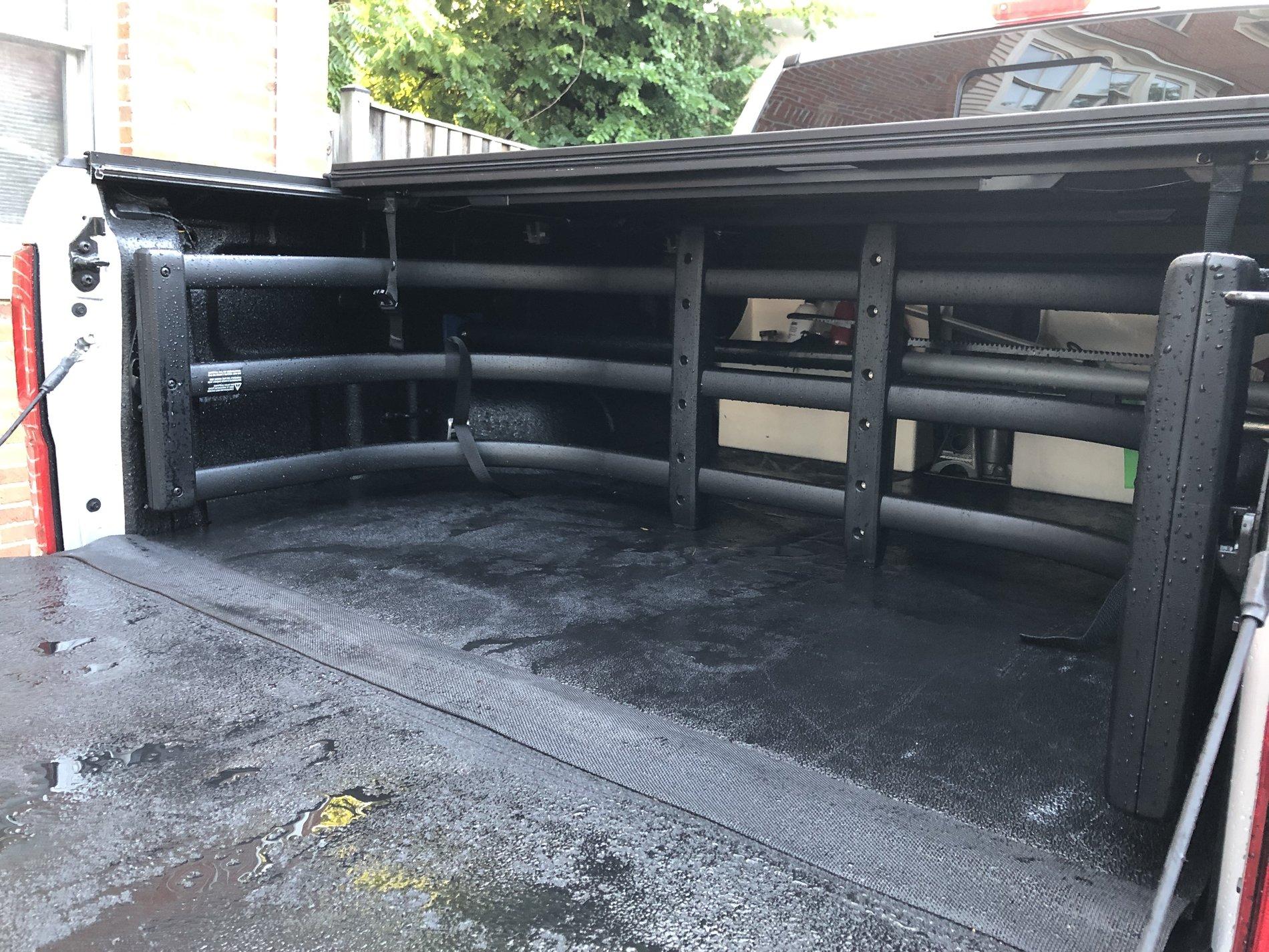

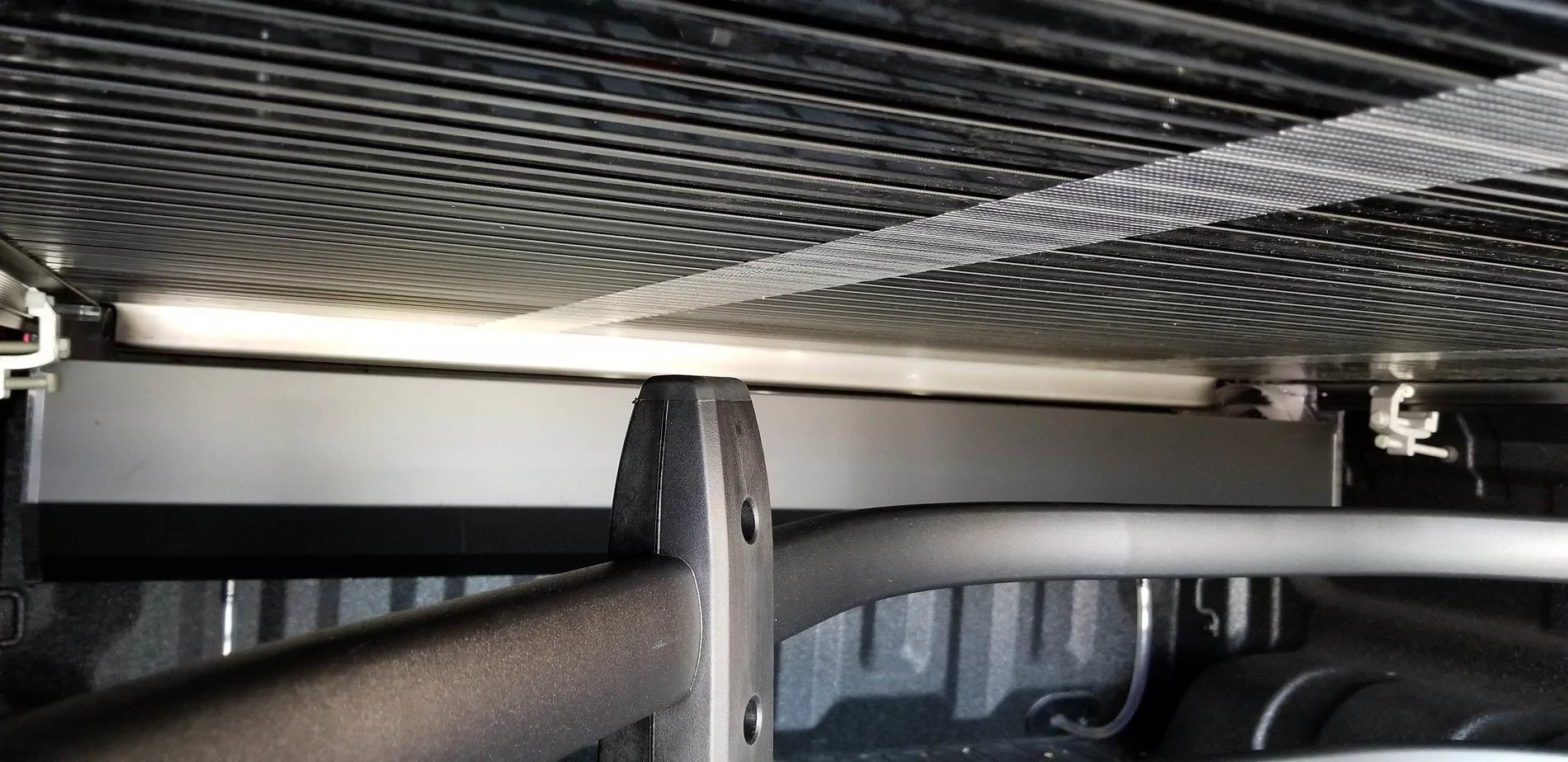

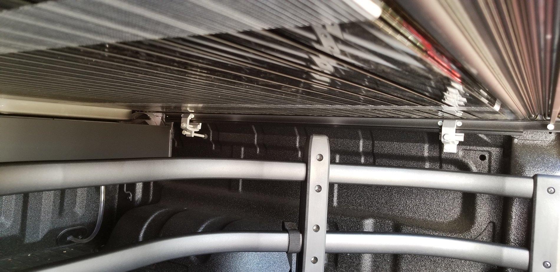

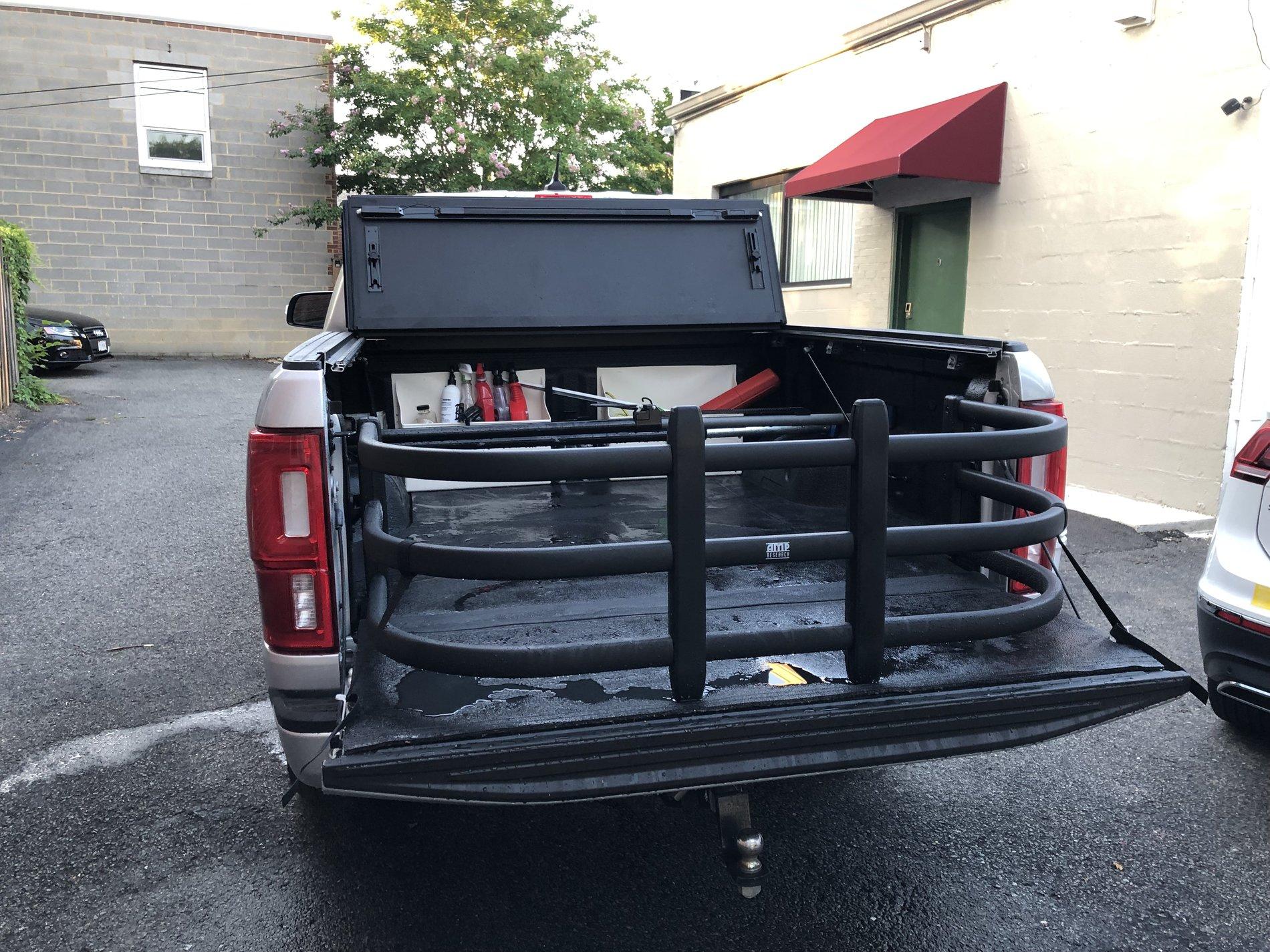

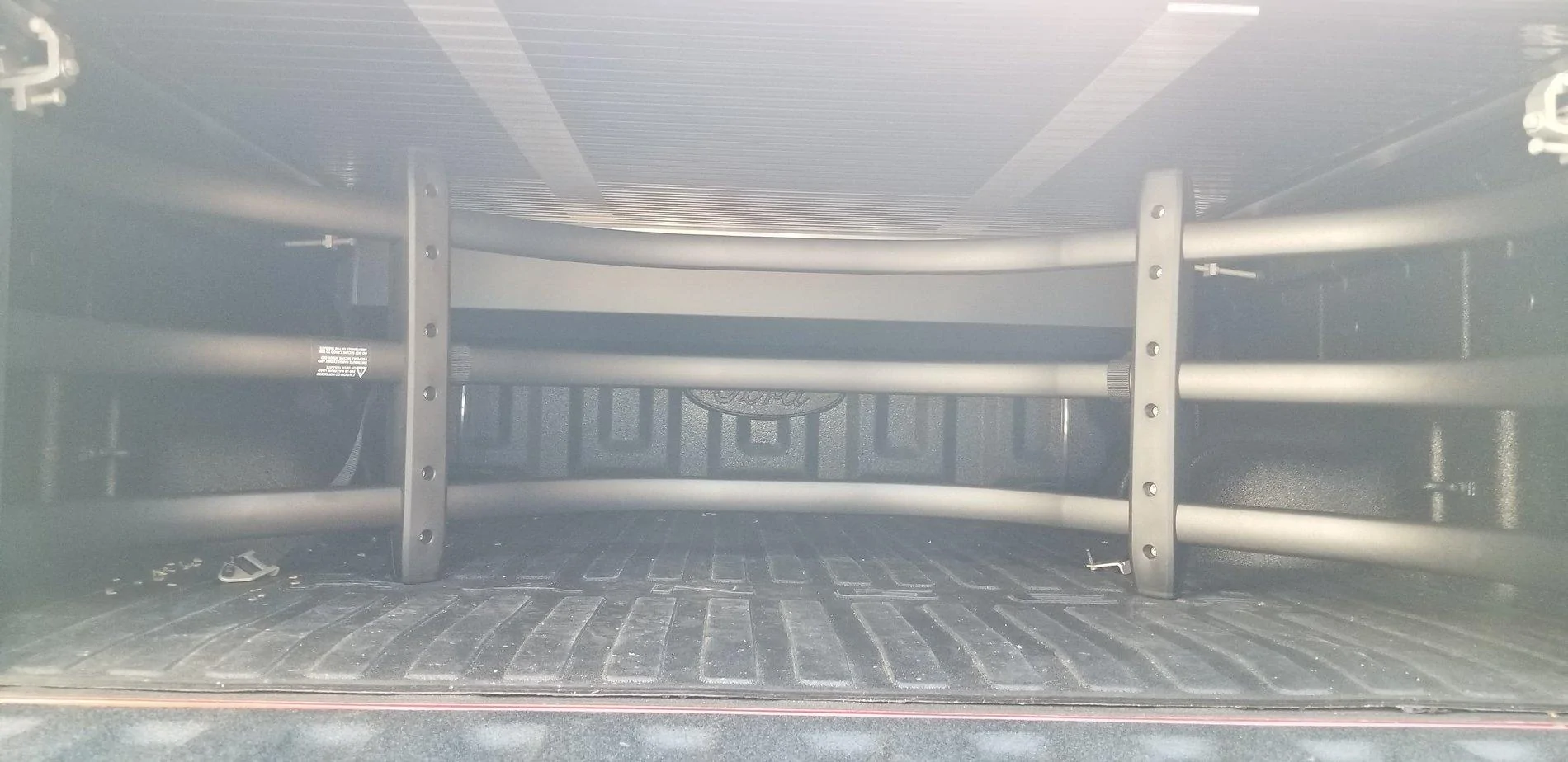

I received the AMP HD Max Bed Extender and installed today. Looks great and fits great with my BakFlip MX4. Plenty of clearance to flip in and out. There weren’t instructions in the box but they are available at the site below and there is a trick or two worth reading. I did not use the plastic spacers that were provided because I did not need them for clearance. Install maybe took 20 minutes. Quite easy.
https://www.amp-research.com/amp-research-74842-01a-bedxtender-hd-max

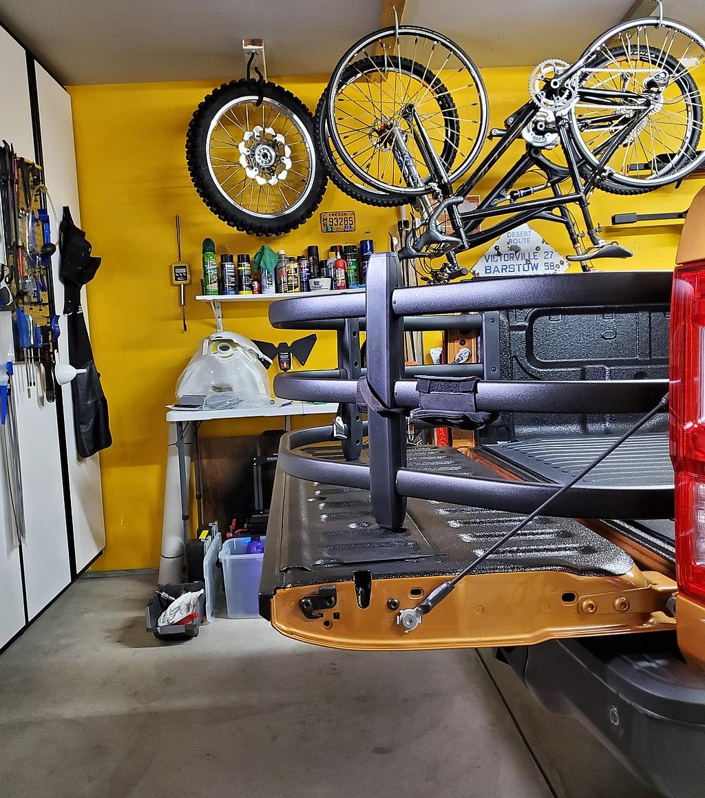

I talked to AMP and they currently have no plans to make a moto version...so when I installed mine I left the bottom bar with the normal overlap, extended the middle bar a bit and the top one a bit more, to better clear a motorcycle wheel. I riveted all three bar levels on both sides for more strength.

Thanks for posting the results. I'm happy to see this; that's the very extender I want to get but I was concerned it wouldn't work with a bed cover.

Truck looks great. I'm curious about your bed mat. Your garage says "Impact Mat". If you have time could you share some details about where you got it, installation and how you like it so far. Thanks.

Thanks. I’ve been very hard on the Mat. Concrete blocks. Wood, gasoline spills no problem. I like that it prevents stuff from getting in the hinge gap. It’s soft on the knees and feet too. Installation was as easy as putting gown the included velcro. It’s made by bedrug:
