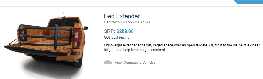

Where did you purchase it? Your dealer? Or online?
If I may ask, how much did you pay for it? Retail on it is $289, but I've seen other dealers offering it online for like $223 or so.
This will be one of my first purchases (along with an Extang Solid Fold 2.0 and a BedRug).
My dealer.
I paid $289 for it.

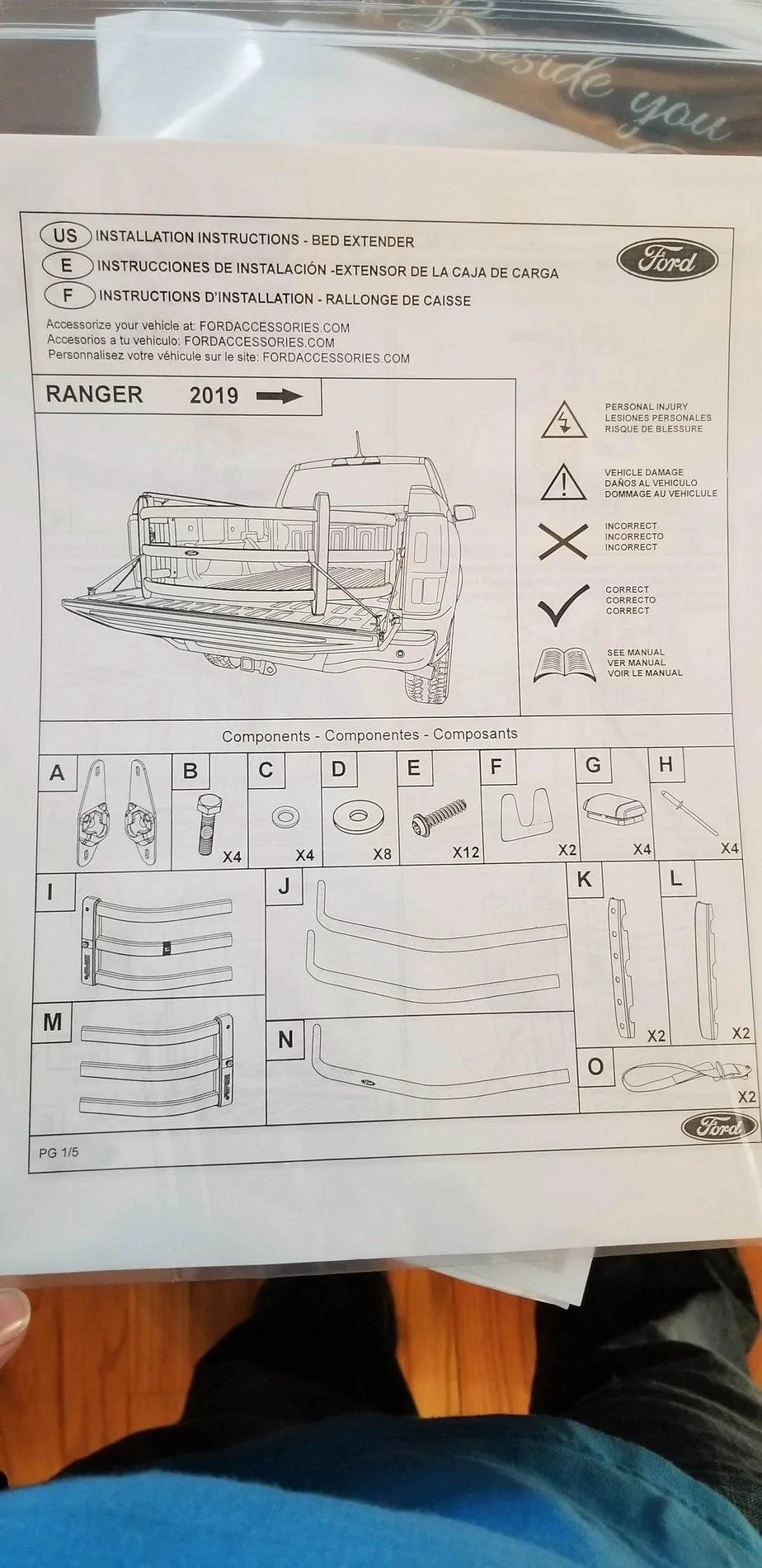

Looking at the instructions showing the rivet, is this even necessary? None of the other AMP Research Bed Extenders show the rivet. I have also watched several of their install videos and no rivet. Is this just to hold the tubes while screwing the retaining bracket?

After putting mine together, yes....it's necessary.
I tried it without the rivets since I didn't have a rivet gun. It kept coming out of adjustment every time I flipped the extender into the bed. So off to Home Depot I went to get a rivet gun. Followed the instructions and it works perfectly.
I've seen the instructional videos on Youtube. -------> https://www.youtube.com/results?search_query=amp+research+bed+extender
Don't go by those videos unless you happen to come across one for the 2019 Ranger. Just follow the instructions that comes with the extender for the 2019 Ranger.

Thanks for the Scan..I have my bed extender on order and wanted the instructions to understand what is involved...Super simple it would appear...Thanks again!

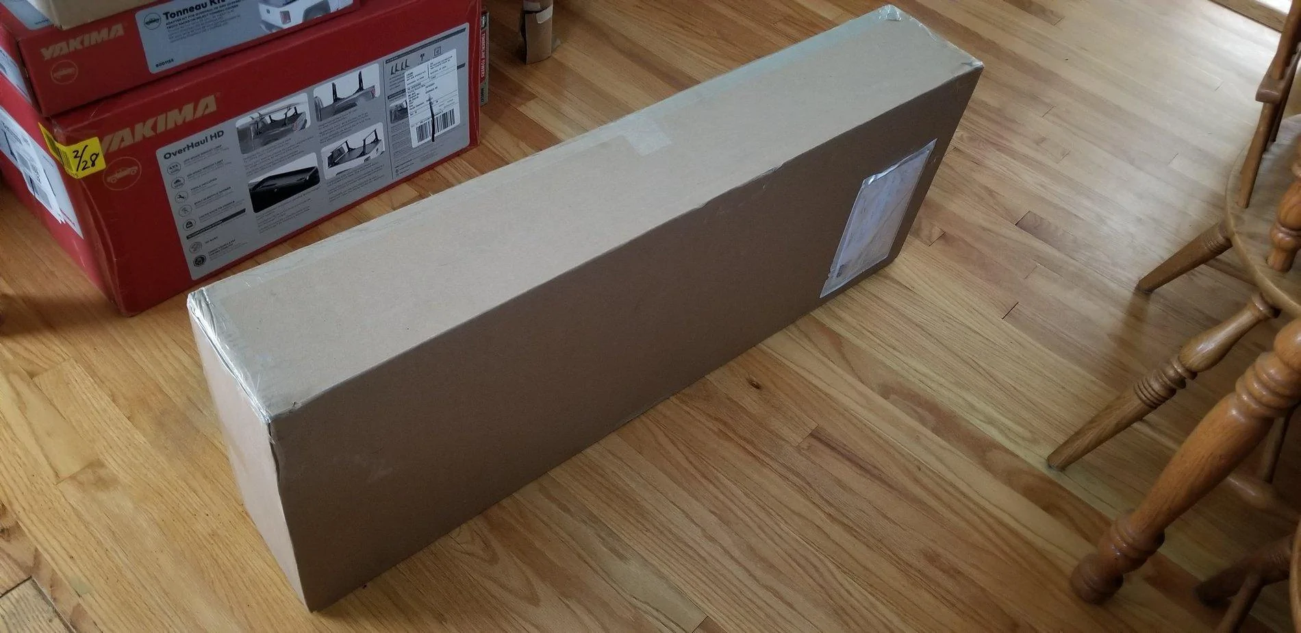

Got mine yesterday! Will hopefully have time by the weekend to install!

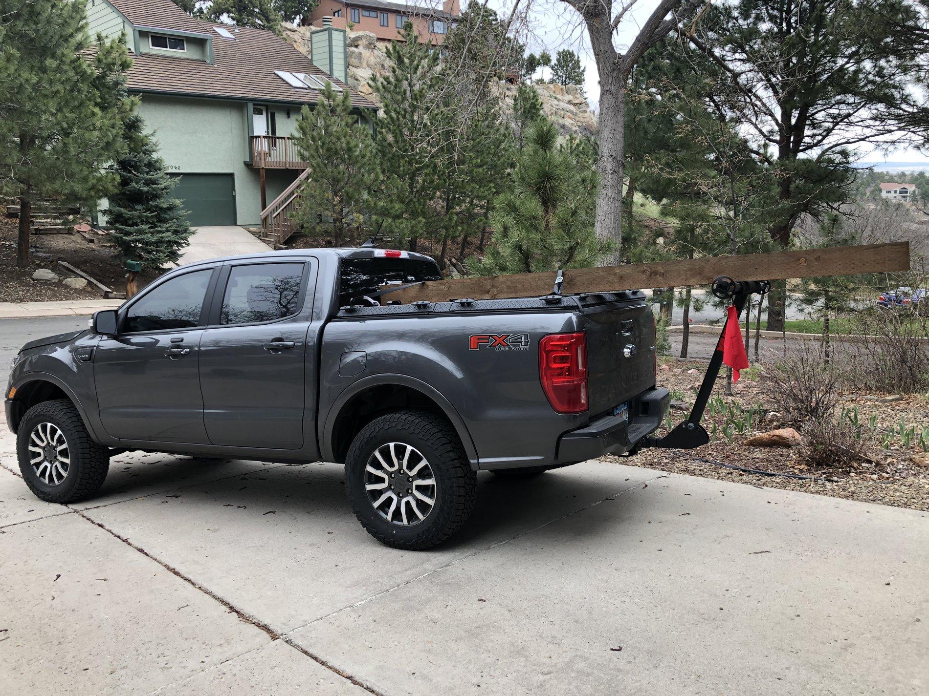

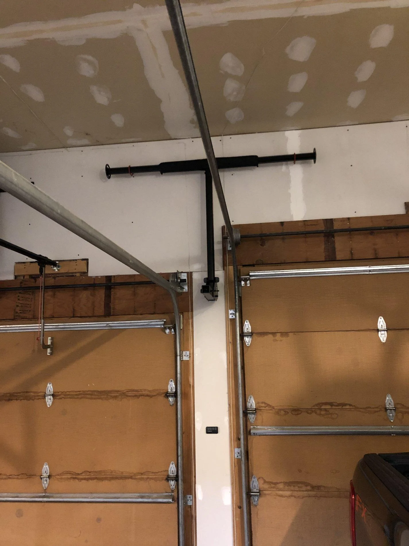

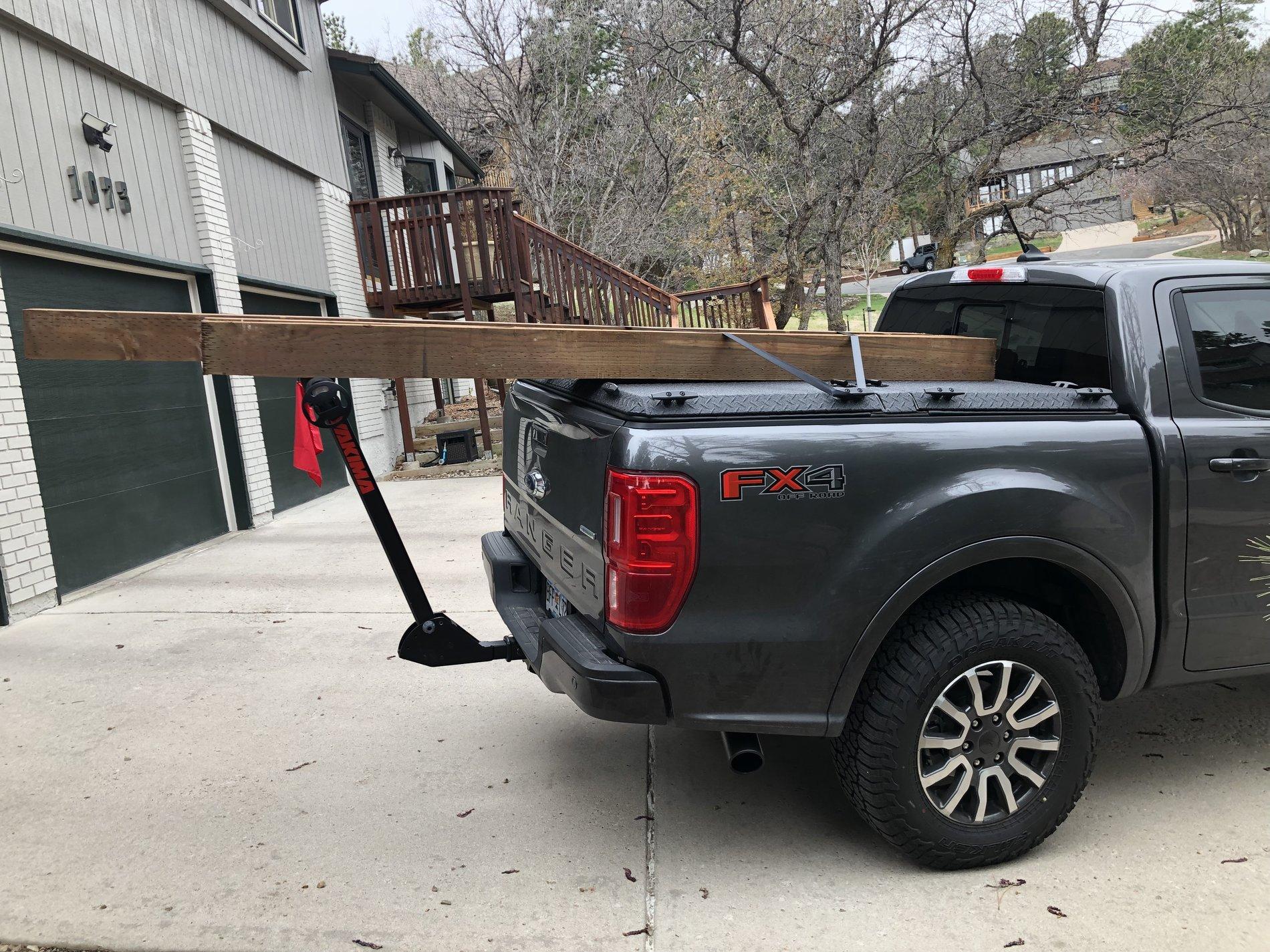

Pics of the Yakima Bed Extender in action and stored away in my garage. It’s all aluminum, so hanging it up on the wall is an easy task.
Those are treated 6x6 timbers in the photo (i.e. they are not lightweight)

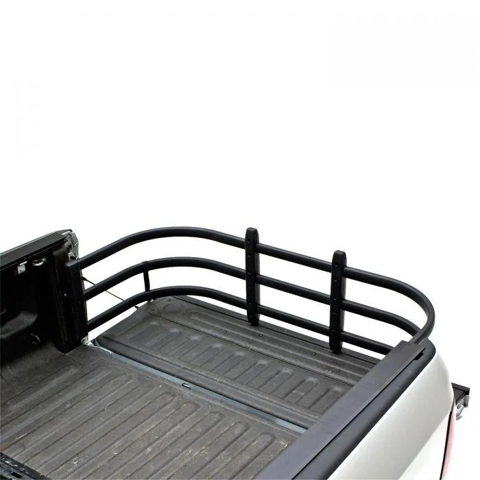

The bad thing about this bed extender is that some tonneau cover rails will prevent it from flipping in and out of the truck bed.
The V-shaped one fixes that problem. Mine barely misses the rail when I flip it in and out of the bed.
Read the description here.
https://www.pandamotorworks.com/col...sport-truck-bed-extender-for-2019-ford-ranger
V-shape design is the perfect mix of form and function that keeps your gear secure. Provides the extra clearance needed when used with some tonneau cover rails.
