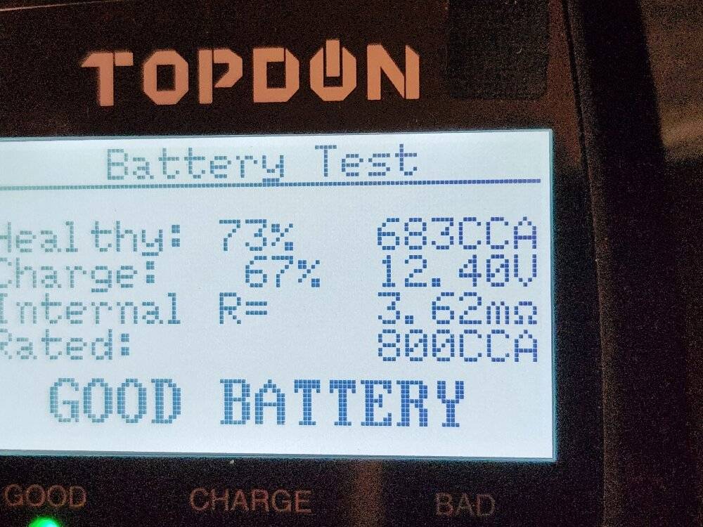

Not sure what the average is but still have OEM on my 2019. Drove a total of 8 miles the last two weeks (2, 4 mile trips) and battery is not too bad.
