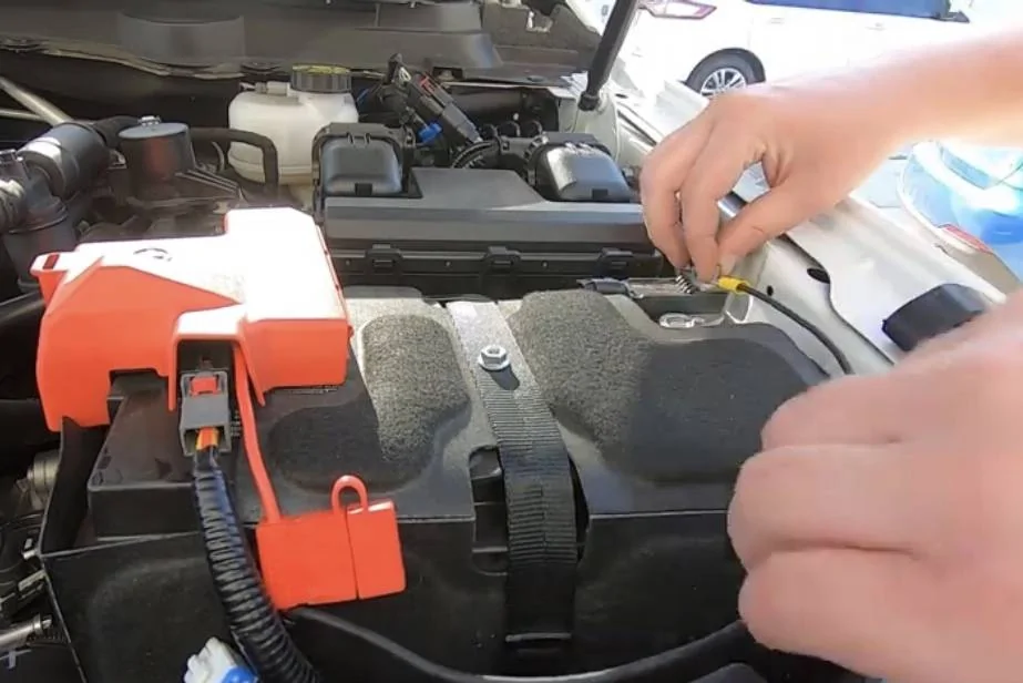

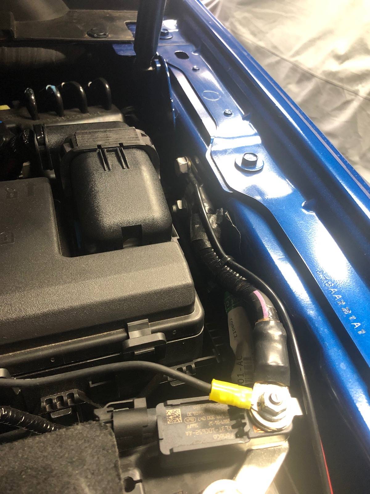

I’m not sure who’s correct but hope we can get it figured out so I can make the changes if need be. The picture I posted of a my ground wire grounded to the chassis was for my Deltran Battery Tender Plus quick disconnect that I’ve been using for almost 5 years.
But I recently had Amp Research Power steps professionally installed and they connected the ground to the Neg on the battery. Also there is a YouTube video of the same Amp steps installation and he too put the neg on the battery.

If you notice the side it is connected to it is considered on the chassis side of the BMS sensor. That makes it where the BMS is still going to read the draw from the steps. Make sense?
So then my and Josh’s install is correct?

Without seeing pictures it can be hard to say for Josh. Your install is ok
His install pic is below mine and connected in the same spot.
Thank you for clarifying Chris.
Sorry, multiple posts all at once:
Yes, this, as long as the sensor can pick up the current flow, this (As Pictured Above) or an actual Body Ground connection is needed.
If you use the actual (Negative Post) you are By-Passing the sensor, now how much of a difference does it make or is it truly important. It mostly depends on the extra load you are adding.
We are already (BLESSED) with the BMS system and fuel economy induced operation, undercharging the battery as it comes from the factory, by passing the sensor only makes it worse.
Thanx,that where I put the negative for my Battery Tender.Good to know its right.I thought when I attached it it would be on the chassis side of the BMS sensor and would work properly.For a winch I would bolt it to the chassis as you have shown.
