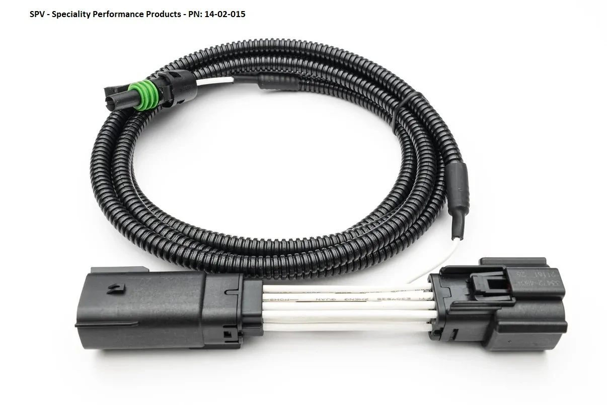

Has anyone come across a commercial plug & play pigtail connector to add power to a relay from high beams to aux lighting?
I would prefer not to have to directly splice into the highbeam wire or build my own pigtail if possible.

Here is the harness - this will allow you to (T-Off) the headlight assembly connector.
However its prewired for - Parking Tap (off), so you would have to mod it and move the tap in the connector.
I cannot remember if anyone has used this, I just know its available and it brings into question - will the BCM flag the extra draw (even for relay coil power) since we know its very sensitive
But at least this gives you what you are looking for - A clean tap point without touching the OE harness

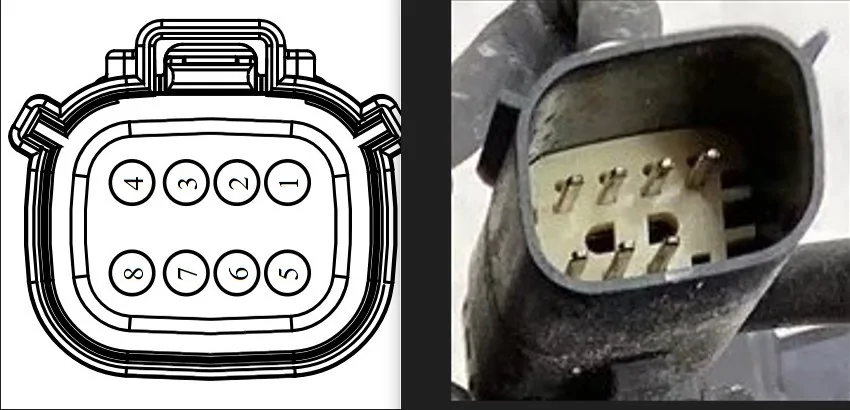

High Beam = Pin 3
Park Light = Pin 5
So if I am correct - the T-Harness will be set up and wired to tap off of Pin #5 in the harness and this will need moved to Pin #3 or cut and splice the wire into the High Beam all within this harness.
Pinout - showing OE Harness connector and physical headlight housing connector - For Ref.

Thanks for the info. The BCM is the reason I don't want to start playing with factory wiring. I'll let you know how it works. If the BCM screws it up, no harm no foul.
High Beam = Pin 3
Park Light = Pin 5

SPV Parts Harness System 2019-2023 Ranger (& RANGER Tremor) LED Headlight
https://www.specialtyperformancepar...headlight-connector-adapter-powers-backlights
If Lightforce isn't shipping and dabbing up a custom connector isn't your thing I guess this is the nearest thing.
How it works with the BCM may be the most complicated part.
