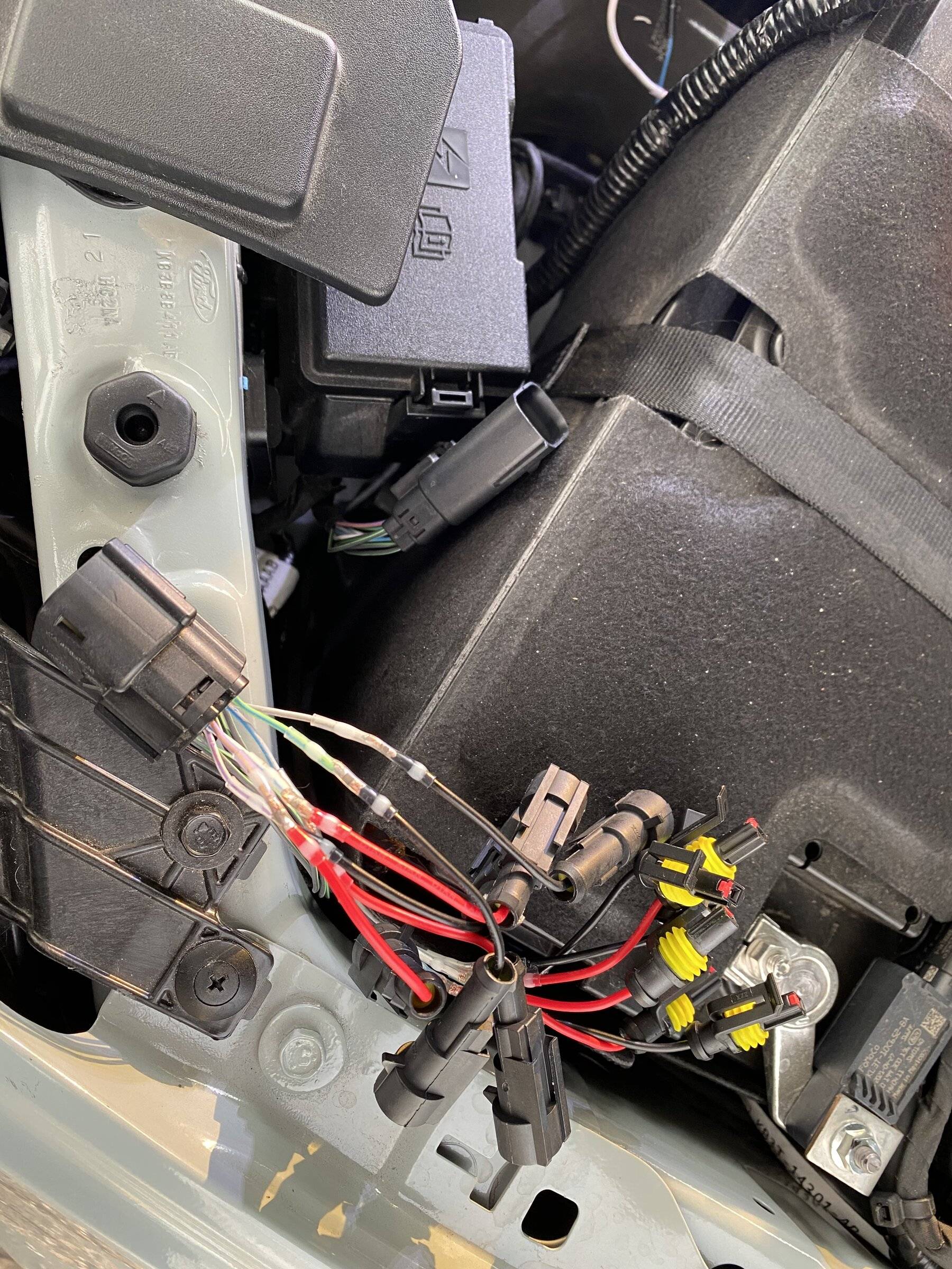

Thank you so much for this, what are the connector plugs you used? i was looking into getting duech connectors as the lights i have are plug and play.
the plugs you see are 1-wire deuch connectors from Amazon. These are on the cheaper side. I was okay saving a couple bucks as this is on the input side. For the output, especially the higher current outputs, I would use a higher quality connector. I used solderseal connectors on the outputs.

My experience was that it was easy. I used solder seal connectors. I also added connectors between the switches and the inputs to the relay box. This allows me to change what output each switch controls.
Thank you. I didn't get a chance to review my wiring until this weekend. My wire bundle was folded and tape down, so I was looking for physical connectors in the box itself.
Yes, I feel stupid. Thank you for clearing this up.

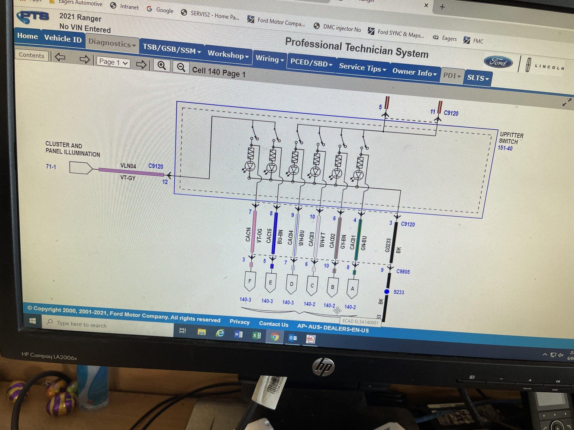

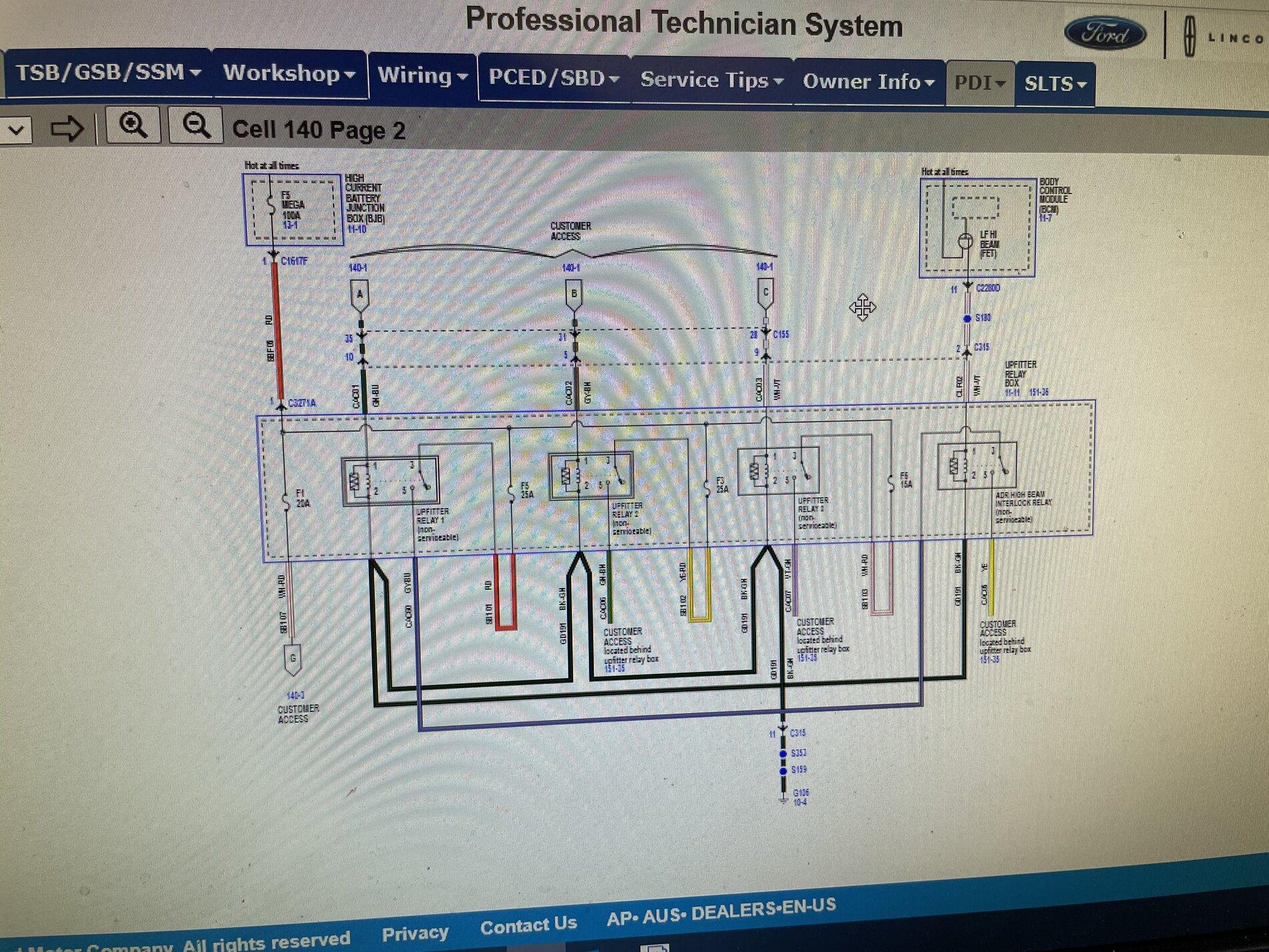

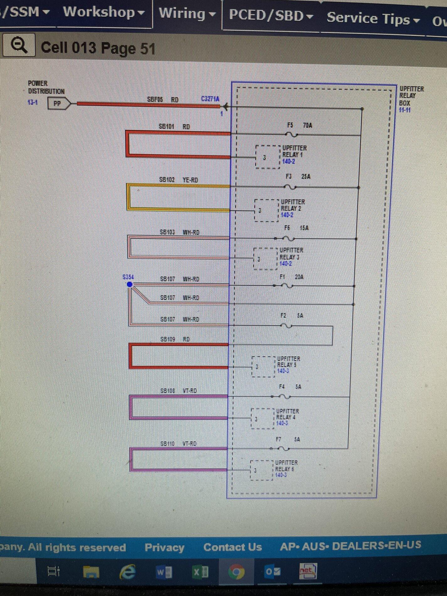

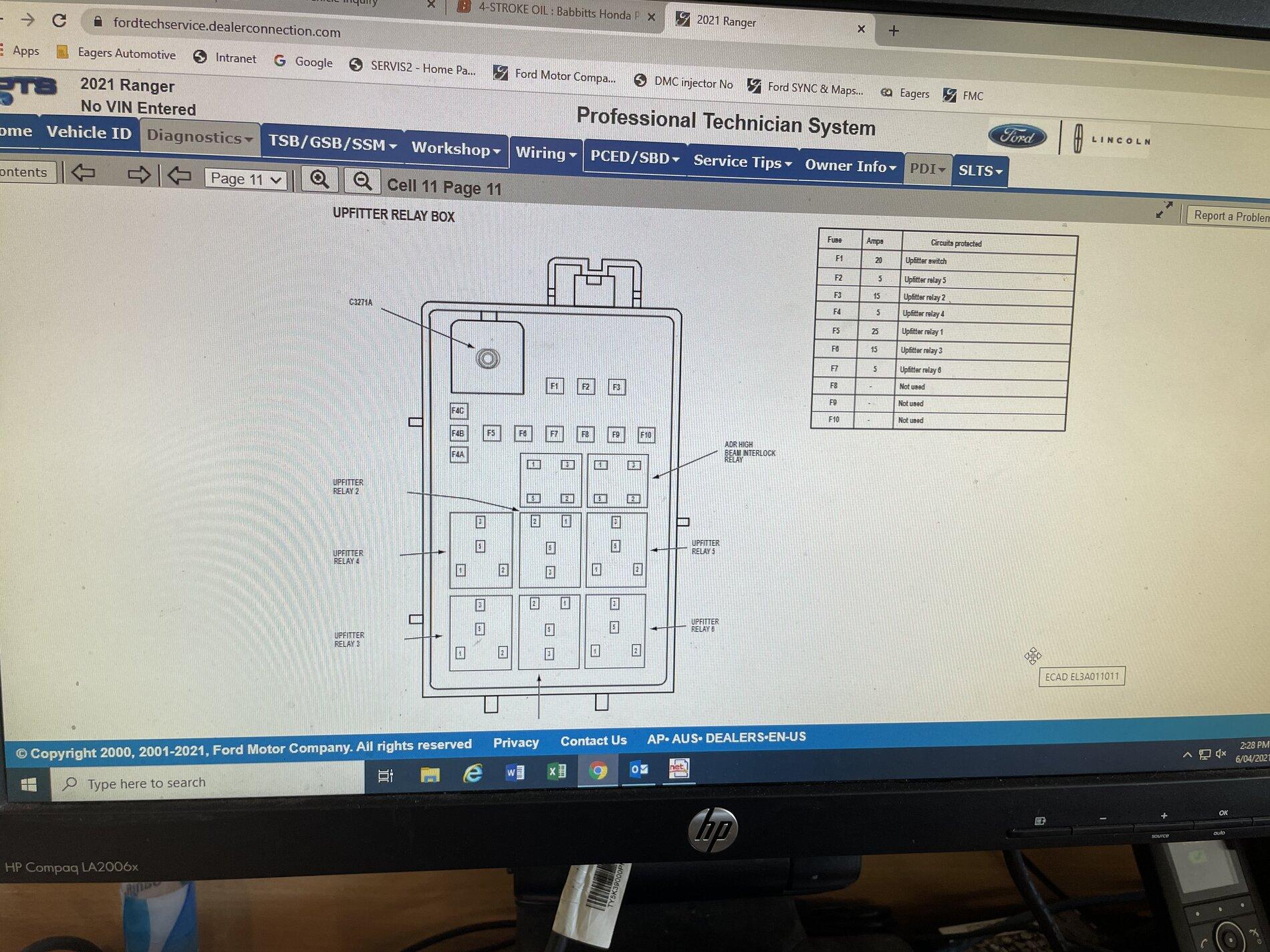

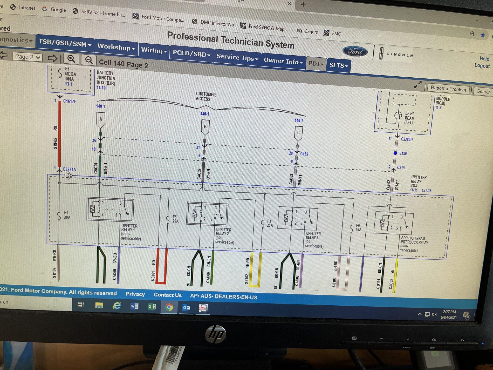

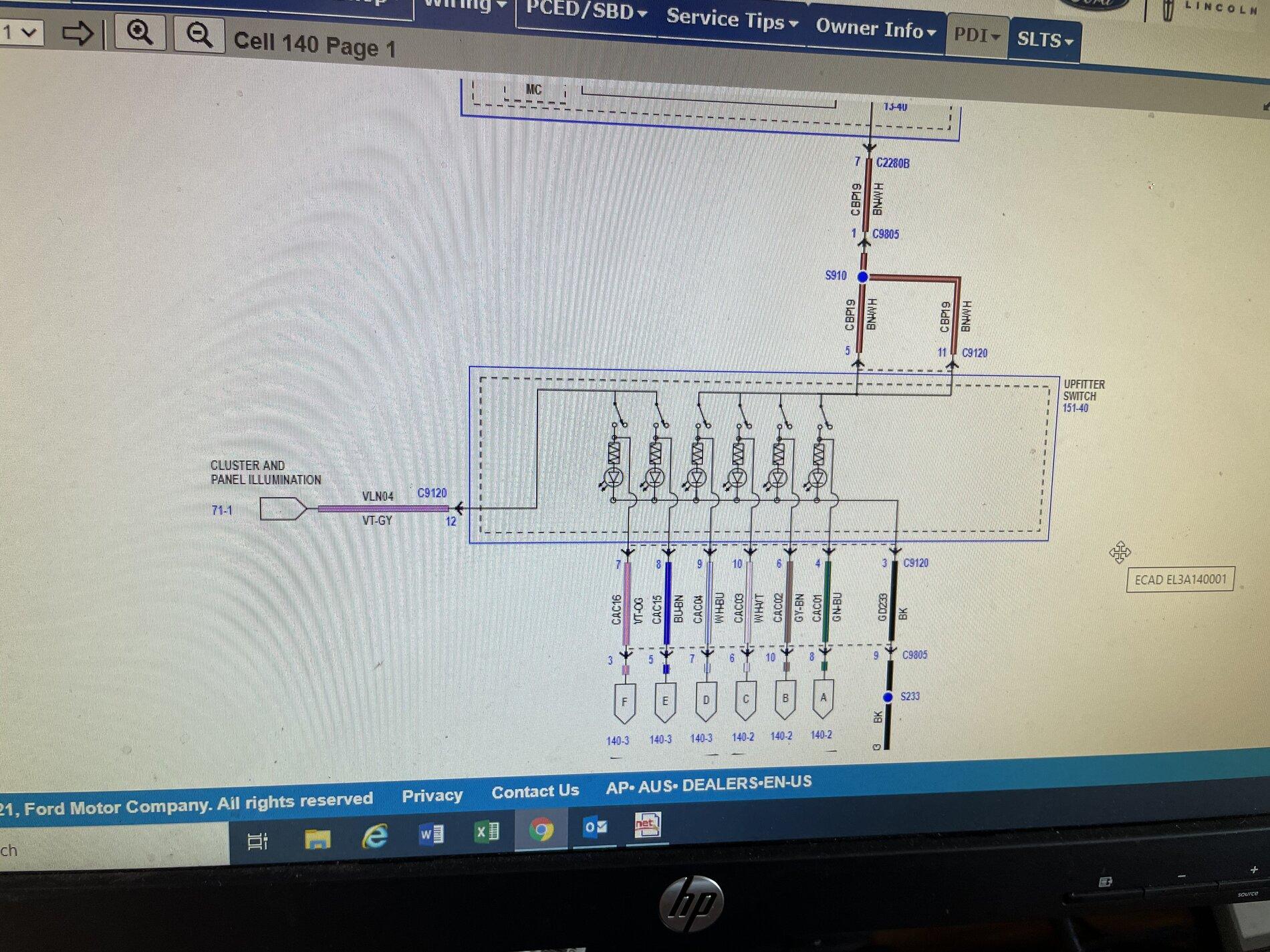

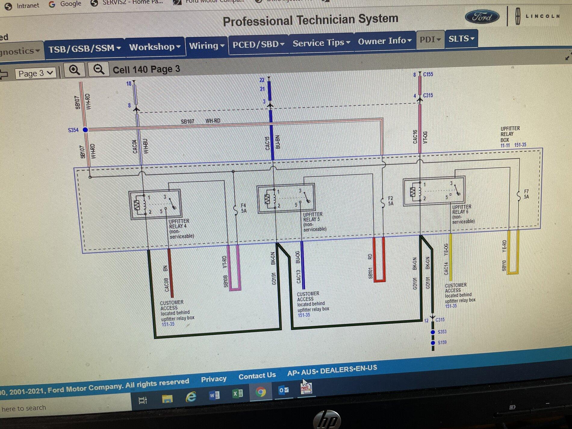

Here are some picture of the Australian version of the Upfitter switches. If it turns out they are the same as the American, I can go through it’s operation with any who need.
This is the most info I have found on the net for my fx4 max switches.
I have a lithium second battery installed and I want continuous power to at least 3 of my upfitter switches so I can have camping lights.
Any idea how?
Looking at the diagrams here the red and white wire is power for switch 4,5 and 6? Do I cut in power to this red and white wire? Or do I need to do something to the upfitter switch box on my dash?

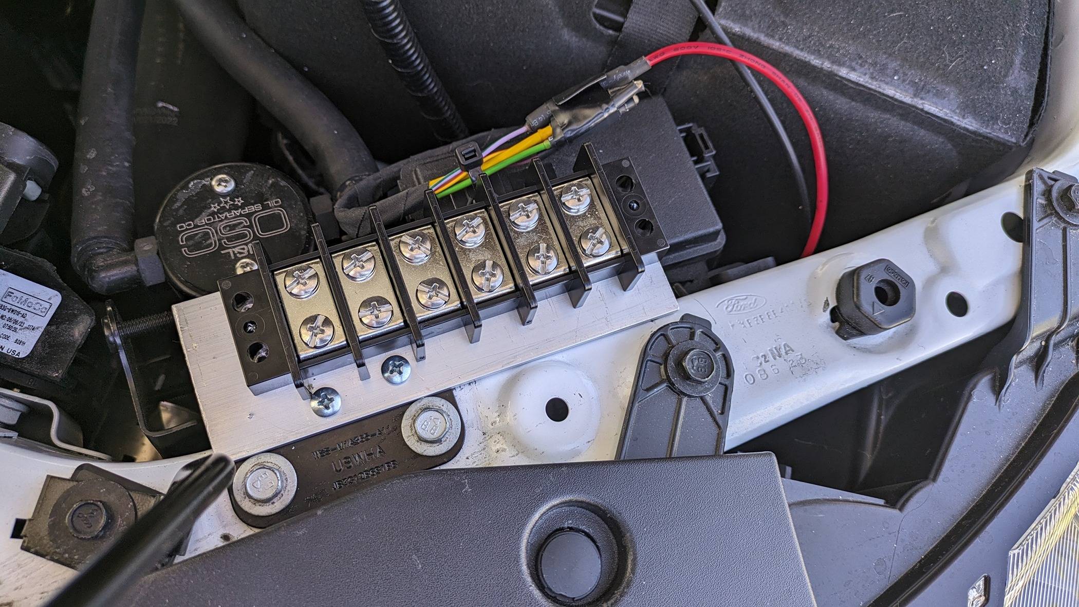

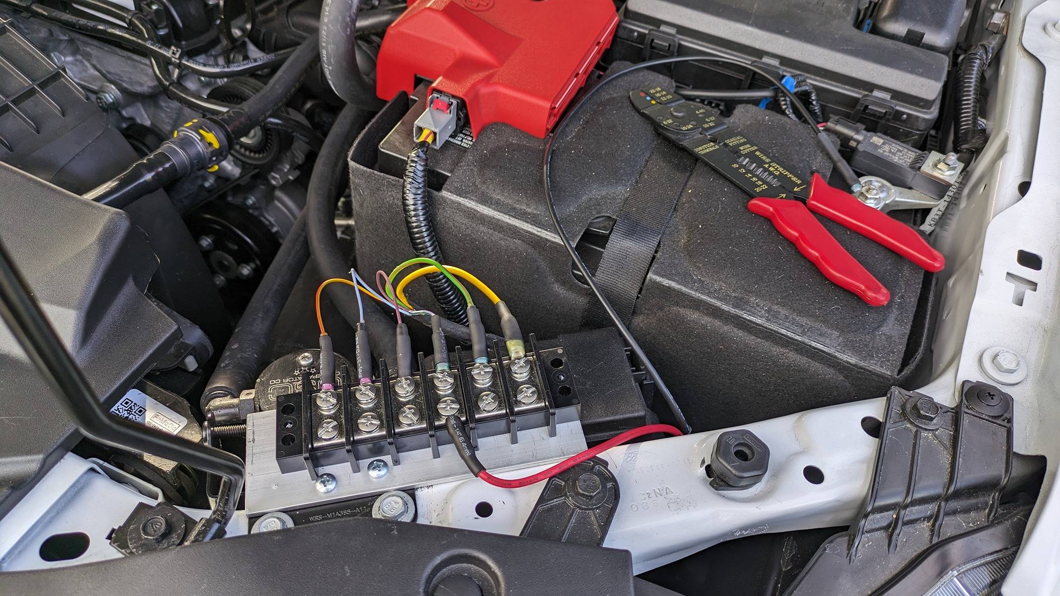

I had this same question. Ford went with the minimum requirement. So the question becomes, how to join different gauge wires for the trip to the rear.
I went with a terminal block and loop connectors so you can come into the block with the Ford wiring, and leave with whatever your heart desires.
Make sure the block can handle the amperage of all the switches on at the same time, even though that tends to be an unlikely event.
I'm in the middle of wrapping the wire in some loom for the trip under the truck to the rear for my own light projects. The block is ready though.
The red wire on the bottom is 14 gauge and going to a light bar on my front bumper. I'm going to rig up a bus bar for the negative leads and mount it on the fuse box above the battery.

LawnMM. do you have a part number for the terminal block? Also where did you purchase it?
thanks Dan
Otirado
Octavio
Jun 22, 2021
NYC
Ranger
Locksmith
Mine is a tremor and came from factory
I had to relocate terminal block due to catch can install
