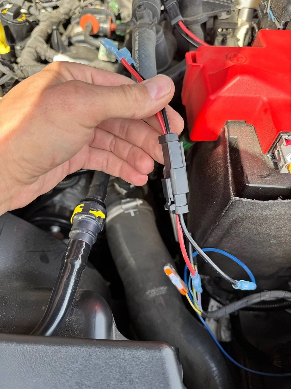

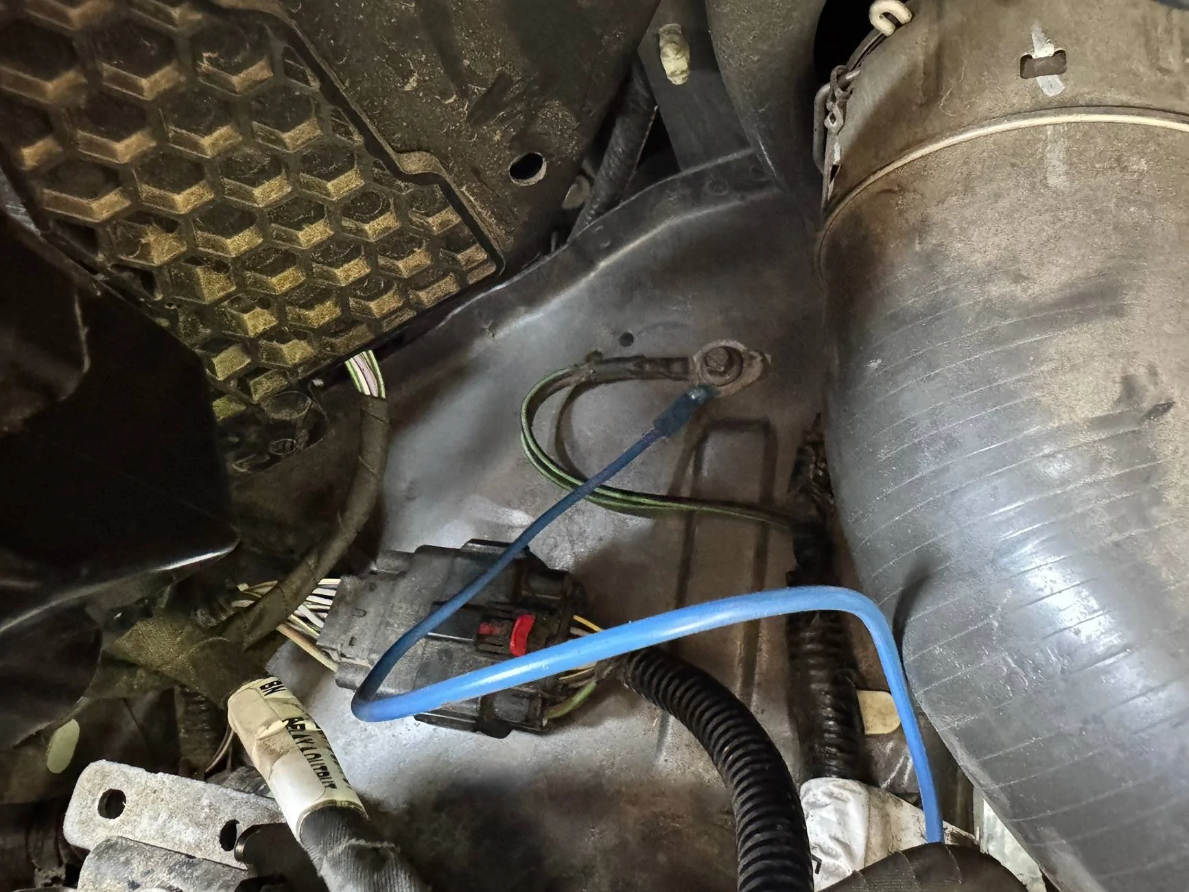

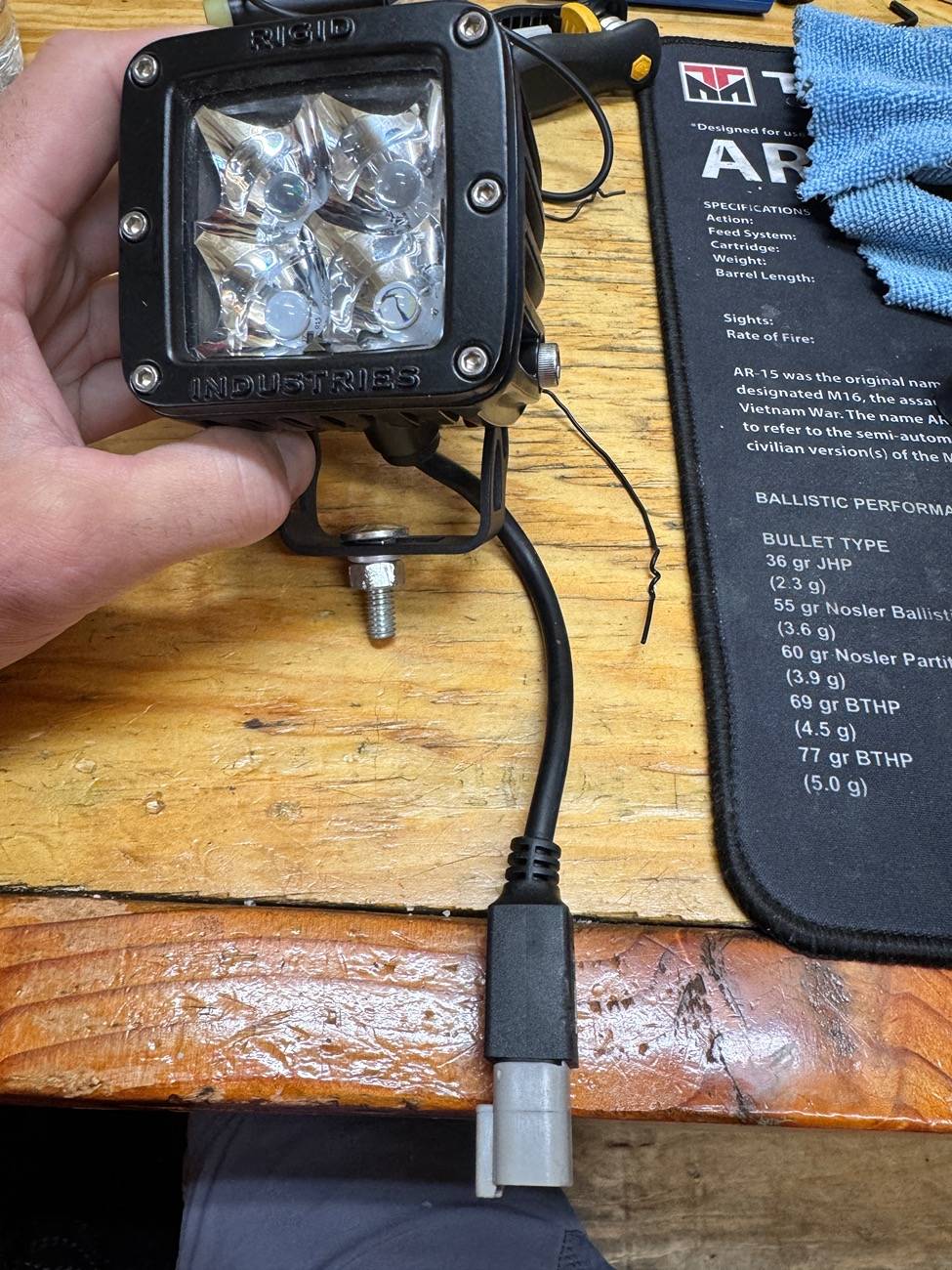

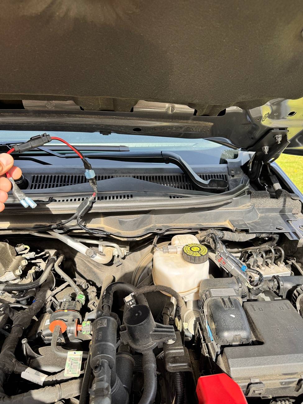

ok so I took another stab at getting the lights powered yesterday evening. I confirmed passenger side light had power and was coming on with switch6. I have a way too short Tractor Supply harness that enables 2 lights to be ran to switch. I guess it’s called a 2-way splitter? So I hooked up 2nd light and had to make my own harness extension to reach all the way back to auxiliary box using m/f DT-connectors on male/female quick connectors. When I tied both lights together and tried to turn them on I blew a fuse (5a) I moved the lights to the 10a switch3 and blew that one immediately as well. Where are you guys landing the negative side? Here’s some pics if you see anything wrong lemme know. Thanks!

A relative gave me these that he had sitting in his garage for quite awhile apparently because these are an older model of Rigid pods im told so I couldnt find the specs anywhere. Ive just been going off of their current D-series lights which are 30w apiece which I figured 5a fuse could work but now ive moved to 10a just in case.. IDK maybe i should put them on the 25a switch?

OK it must have just been a bad ground. I redid the wiring and landed the ground up under the shroud that sits over the fan. Lights are on and working as expected. Thanks for the help with this @airline tech
