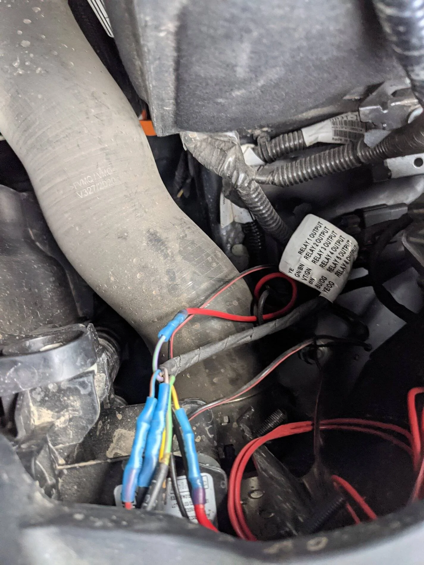

The tremor aux fuse box is front of engine bay on driver side just in front of battery and has a short bit of wires hanging out. You can just heat shrunk to whichever wire you want. I found a ground point just underneath the fuse box that I used. I did find it easier to remove the grille shroud to get access.

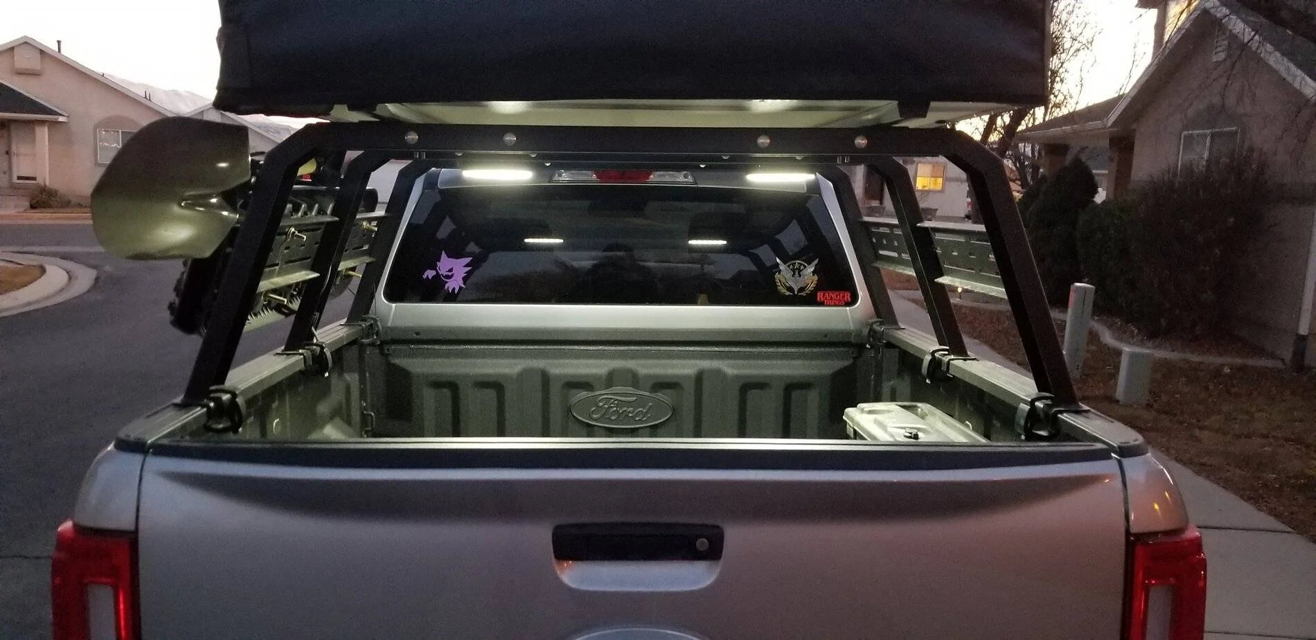

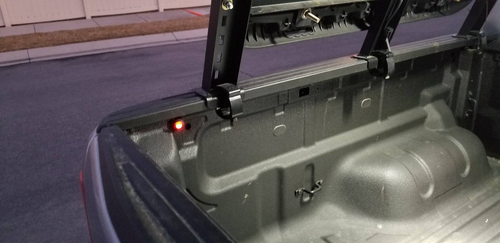

Alternatively if whatever you get has switch, there is a 12v supply that is runs off of the trucks PMS that you can tap into on the drivers side underneath and near to the rear of the bed box.
The only downside is having to switch it on from the outside instead of using the AUX switches, the plus side is they continue to run for awhile without the truck engine running.
Though to be honest running a few wires along the frame from the engine compartment is not that difficult(in my opinion)
I used that power source for some LED lights underneath my bedrack on my old 5th gen ranger.

Oh man your setup looks super nice. The entire reason I bought the lights was so that he would actually have a use for those damn switches in the cab, but if I'm being honest with myself, having a switch in the bed he could hit when he needed the light (rather than remembering to hit the switch before he gets out of the cab) would probably be far more useful.
When you ran your various lights to the fuse box, did you wire in fancy connectors or just heat shrink them or what?
I find it far more useful in the fact the truck doesn't need to be running to use it, unless he is getting out while it's running it's just far more convenient in my opinion.
I know that feeling, when I am completely done with my setup I will have all but AUX 1 connected to something and that one as of now, I have no idea what to put on it....And that really bothers me. I hate having switches that do nothing.
Ignore the messy looking wires, I have since cleaned these up a bit. I used a waterproof butt connectors, the kind that has heat shrink on it. It's super easy and allows the joint to expand. You could solder them, but I think this is the better way to go.

Hi Ryan! I'm looking to add lights to my bed rack. What kind did you get. It looks like you have lights on the rack and the in the bed which is nice. Did you just zip tie the wire to the rack? Also where do the wires enter the bed? Thanks!
I don't remember exactly what I did on this one as it was my FX4.
However to the best of my memory I got some amazon cheap LED lights.
As far as mounting the wires I got some simple adhesive wire retaining clips and ran them underneath the bed rails and on the rack to their respective locations.
On these lights I am actually using power from the plug that is up under bed/box the rear driver side. So I ran it up through a small hole in the rear left corner of the bed.
Just about every corner of the bed has a small gap/hole you can bring stuff up through, and hide along the bed rails.
Someone else here might have a better idea, that is just what I did.
Hope that helps
