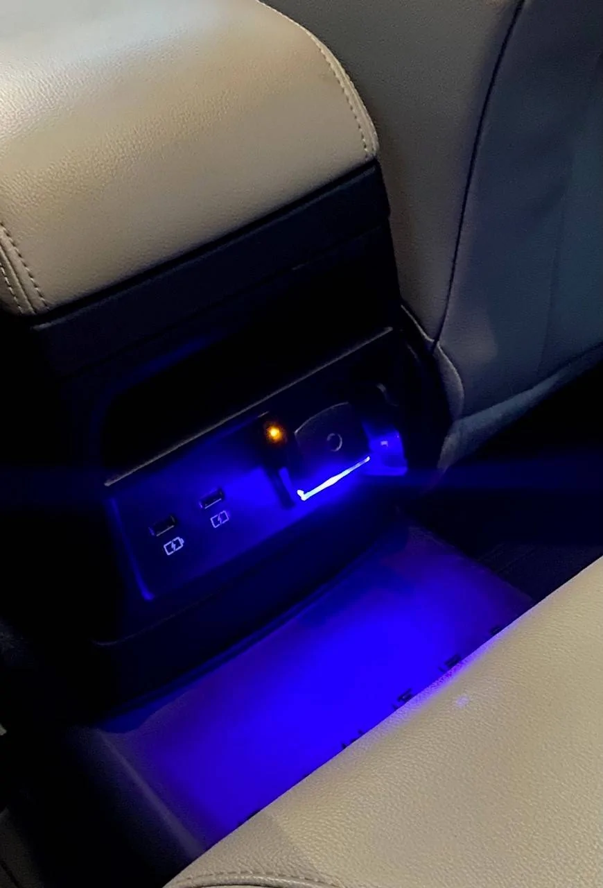

I took an old out-of-date AC phone charger, cut the cord off and plugged it in the AC outlet. Free, and repurposing something that would have gotten thrown in the trash.
The other day I got stuck in bumper-to-bumper traffic and actually unplugged it for a while.

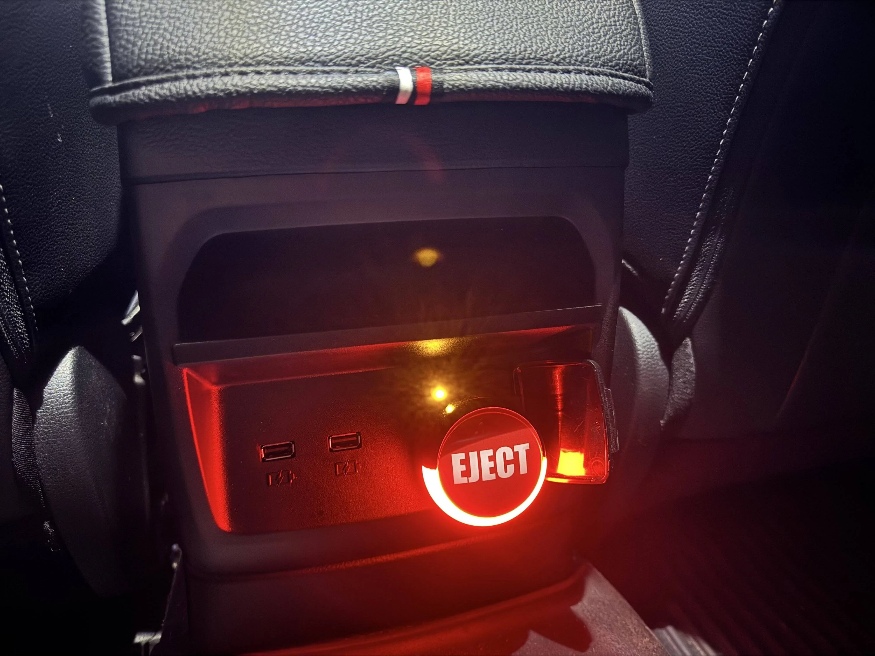

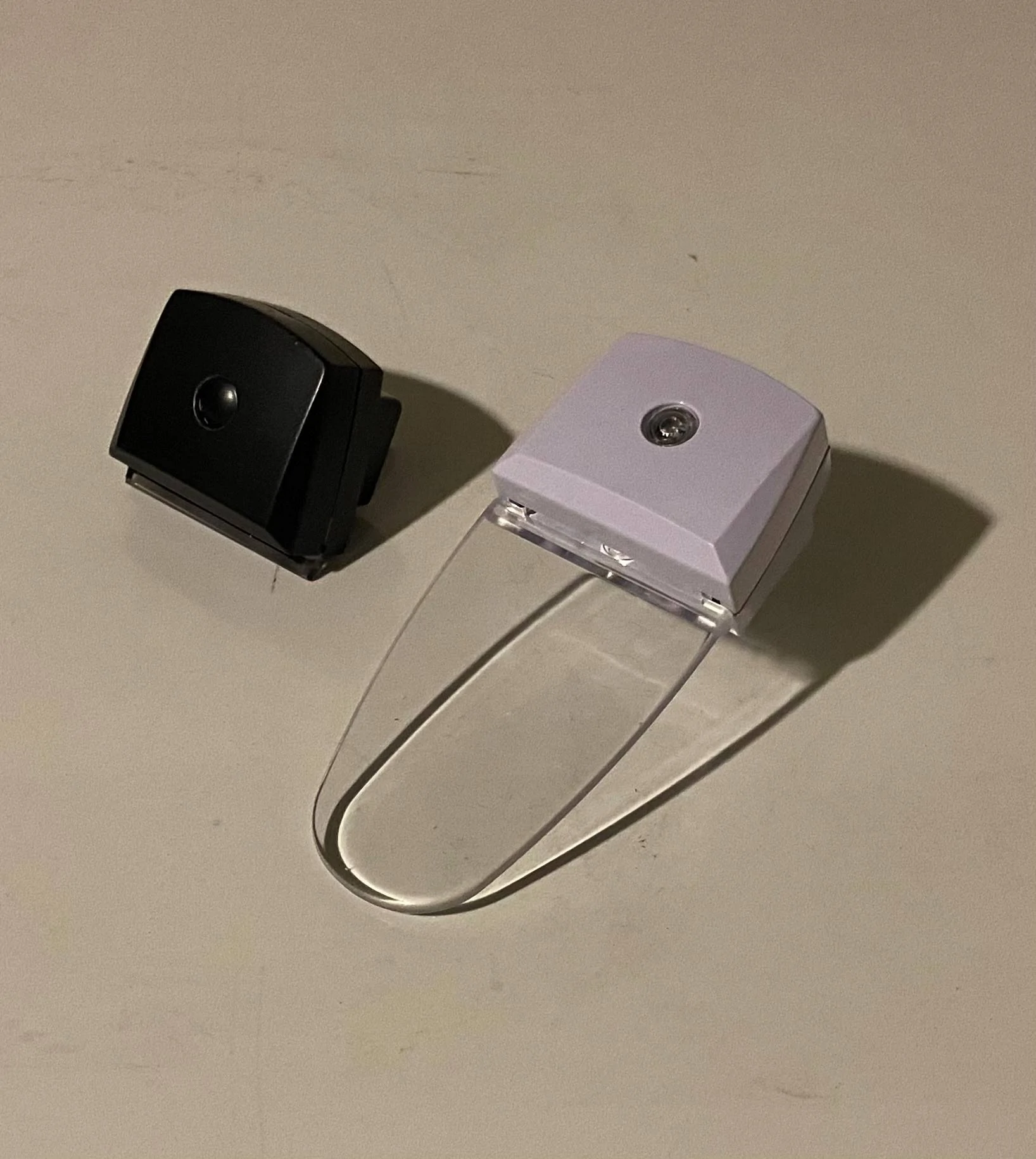

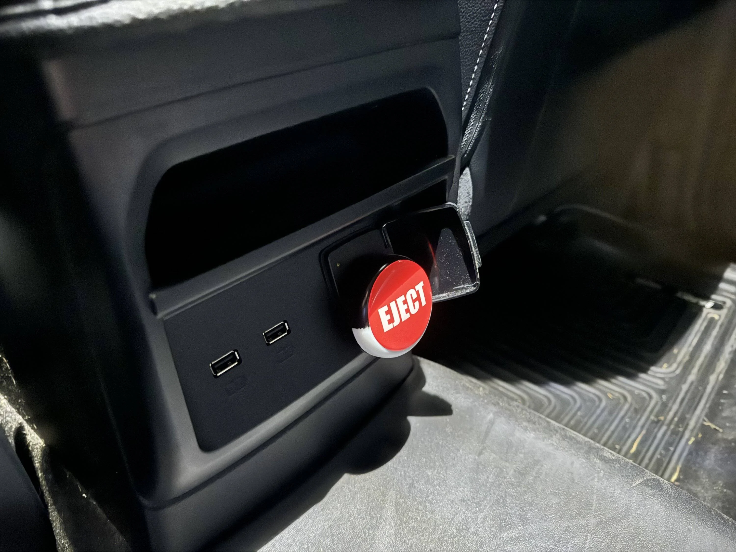

Saw that we could use home nightlights to "disable" the auto start/stop. Bought these from Amazon.
https://www.amazon.com/dp/B077X48B8Q?ref=ppx_yo2ov_dt_b_product_details&th=1
Using jewelers tools I took the nightlight apart, removed the lens and cut off most of it with a dremel cutting wheel. Finished off the rest with a dremel de-burring tool to get it to the smallest size possible. Hit up the body with a couple coats of plastidip and once dried put it all together again.
Works like a charm!

I used the nightlight mod successfully for months on my 2020 Lariat to disable ASS. I had to replace my battery due to age and the nightlight mod no longer stops ASS. Any thoughts?
