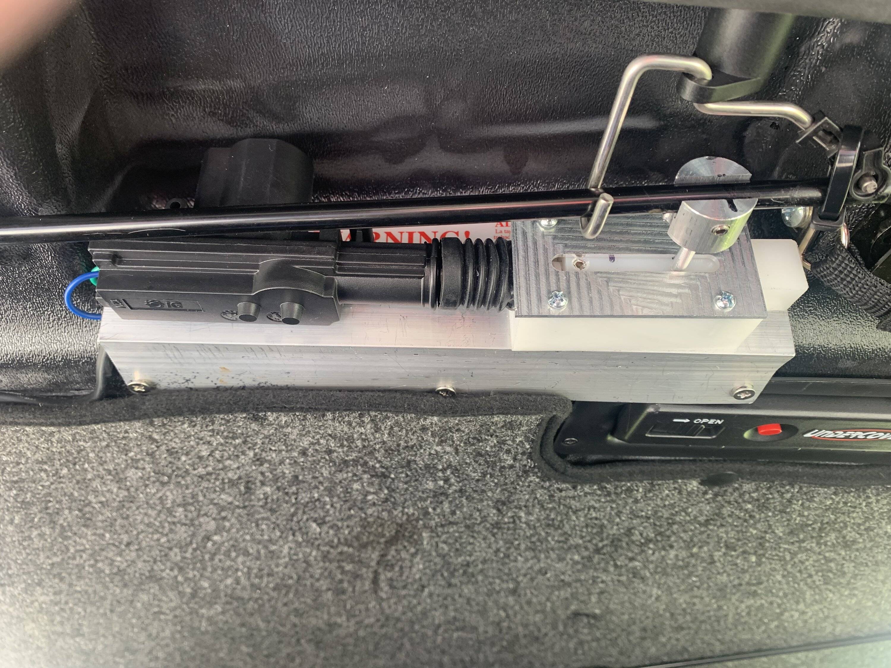

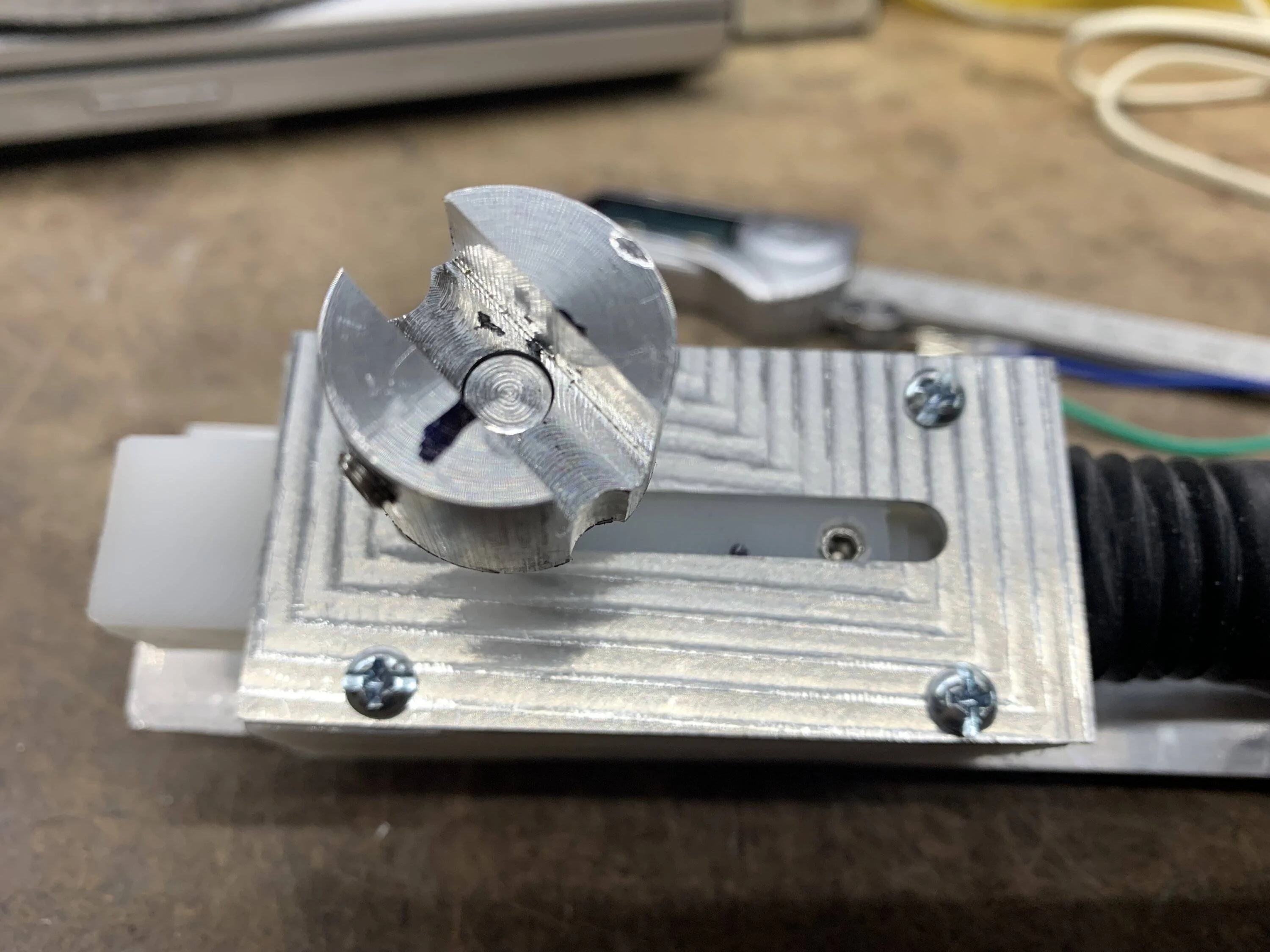

I fabricated a power lock and tied it into my tailgate power lock so goodby key! I designed it so the key can still be used in an emergency to unlock it if the battery is dead or the locking mechanism fails.

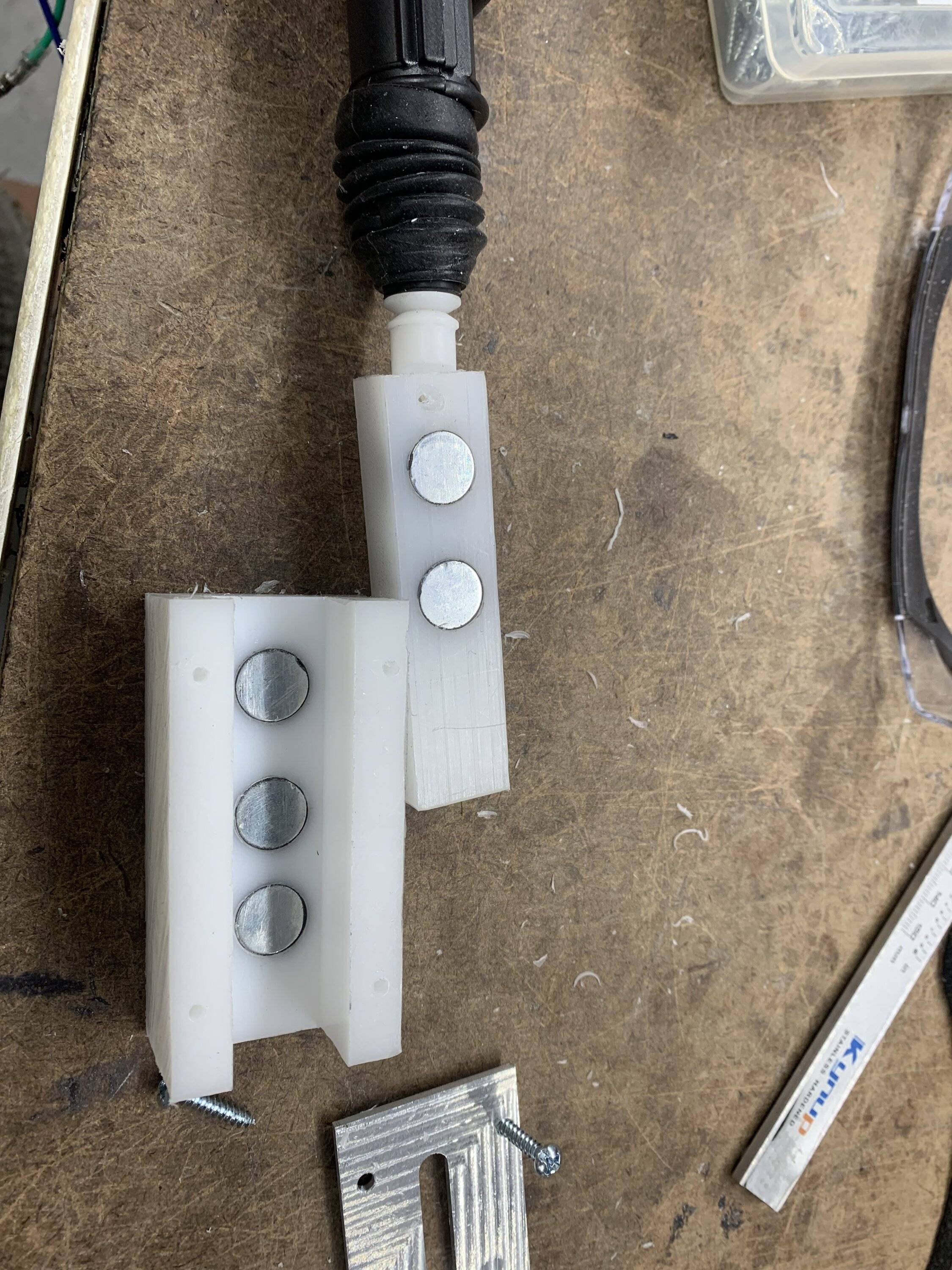

One of the challenges was in providing positive detents for the lock and unlock positions. I solved this by using the five Neodymium N52 magnets in the slide assembly so they would latch into place.
The locking piston is a cheapo amazon universal lock. 2 for $11.49 https://www.amazon.com/dp/B00CZBQCR2?psc=1&ref=ppx_yo2ov_dt_b_product_details
It mounts to the existing rod with the round mounting knob i machined and mounts without modification to the existing mechanism with a set screw. and the bracket is secured by 3 screws to the backing frame.
The only change is to disconnect the silver rod from the hole in the locking rod and tie warp it loosely along the shaft so that it can only act as an emergency unlock.

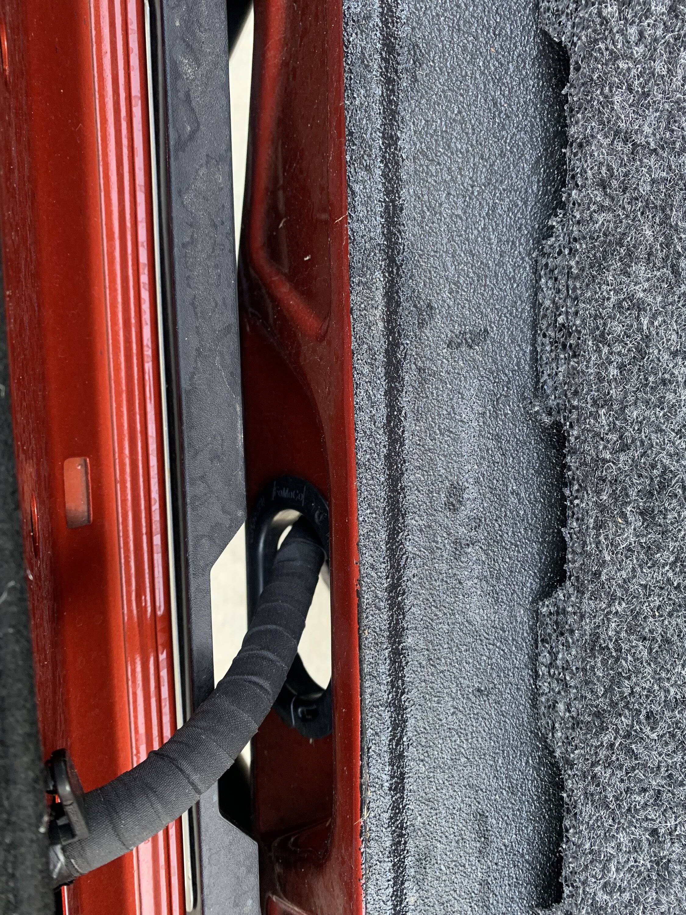

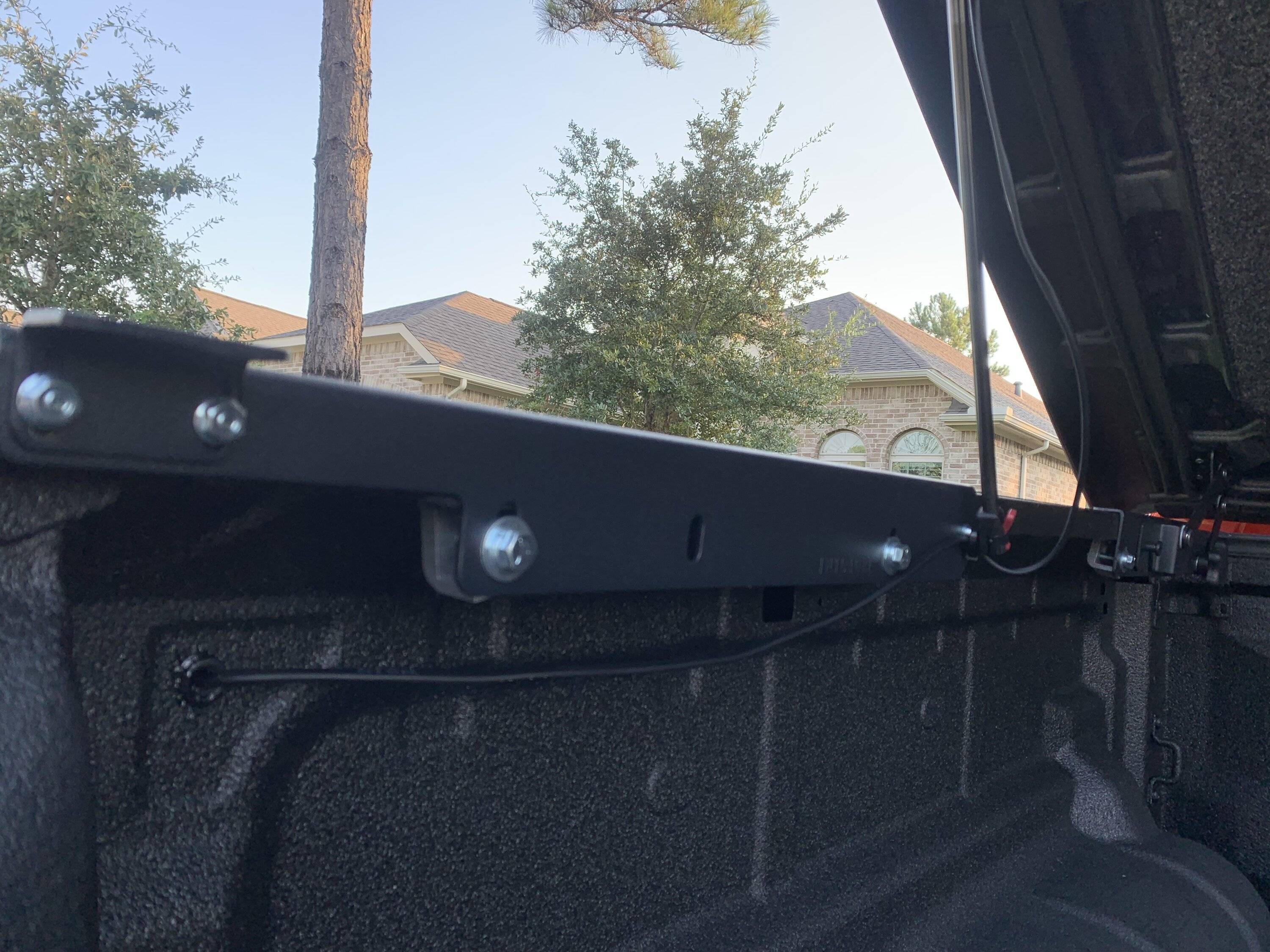

Wiring was simple. I pulled the tailgate access panel to expose the the wiring harness to the tailgate power lock. It is a short harness that clips to the lock assembly on both ends and under the bumper.
I disconnected it and spliced in a 2 conductor cable on the under bumper connector side and ran the cable and tie wraped them along with other cables to the fender and then up through an existing hole in the bed.
I added a rubber grommet to the hole to protect the cable then ran the cable to the support strut for the topper and cable tied it to the strut. then at the top ran it under the topper carpet to the new locking mechanism. One thing to keep in mind is that the lock works by reversing polarity to lock and unlock so don't make the final connection until you test the the polarity.
Hope this helps.

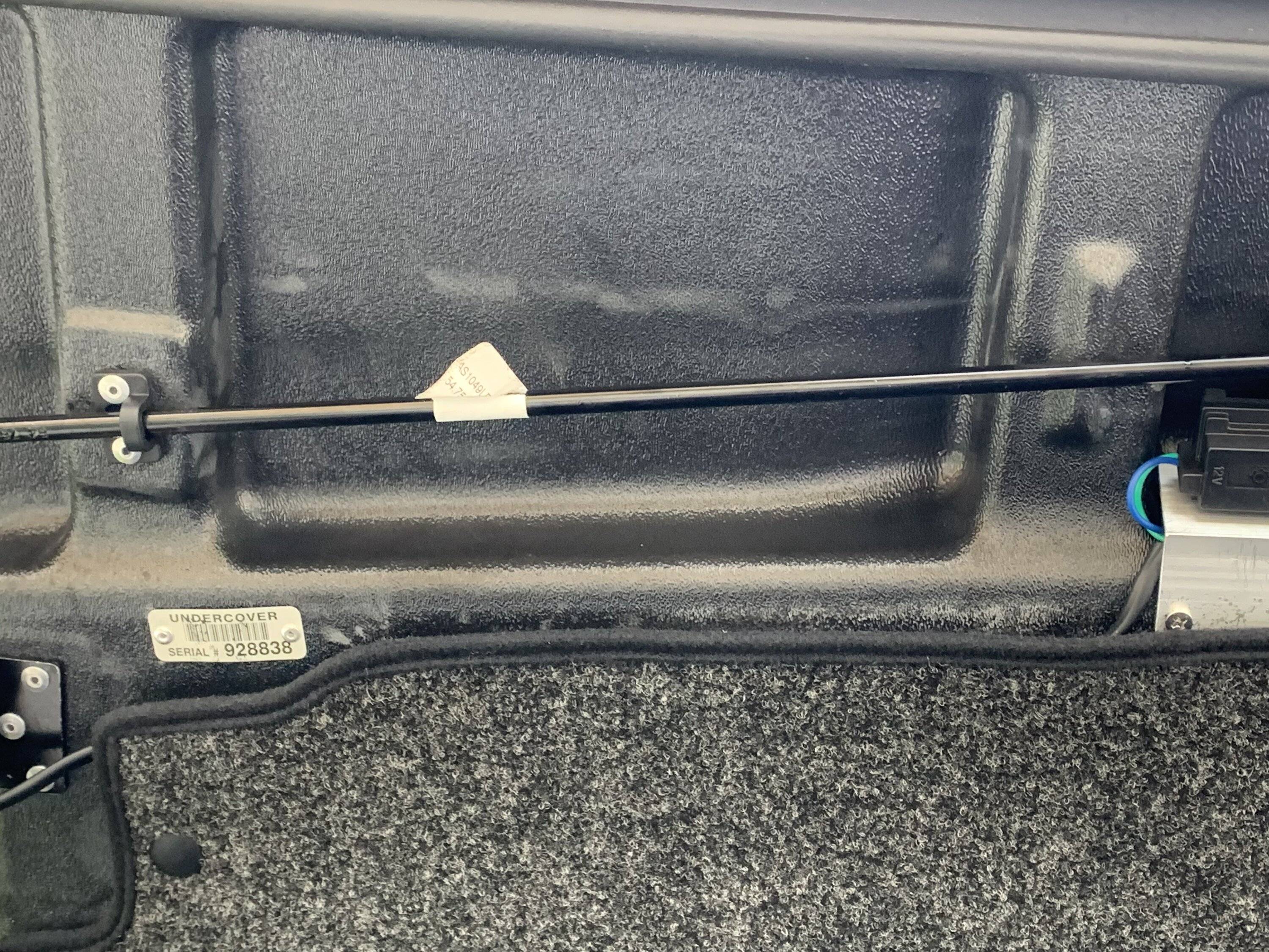

Here are a few pictures,
The cable harness I spliced into
The Cable run through the bed
The Cable under the carpet to the lock
