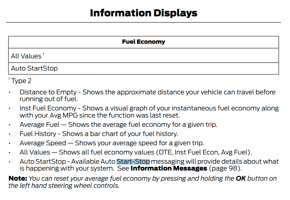

There is a menu you can display that will show you the status of stop/start. If it won't engage it will tell you why (charging battery, etc). It is in the left hand windows on the Lariat.
