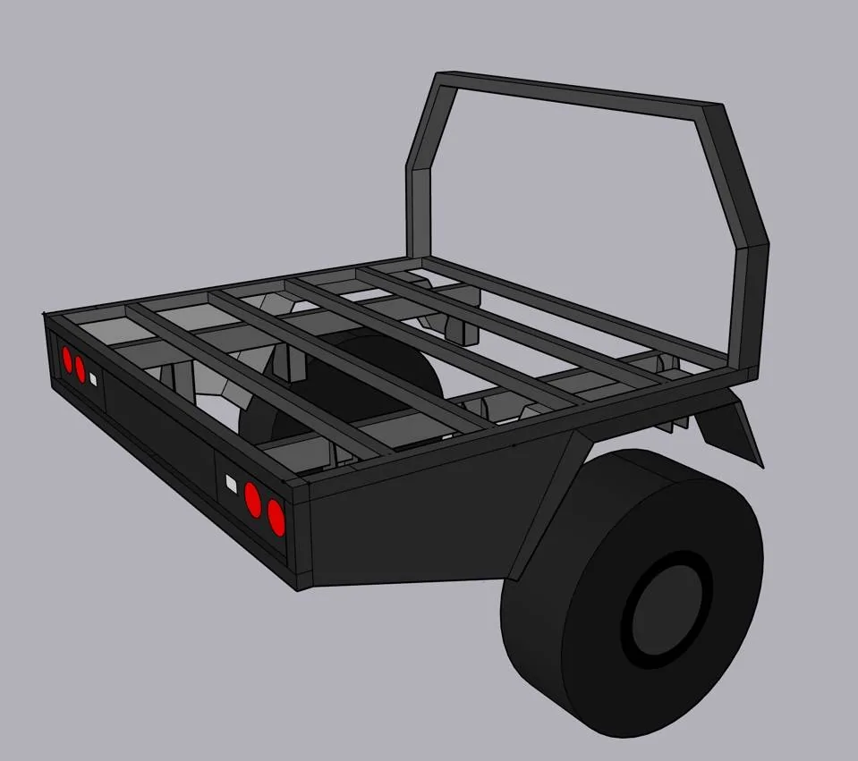

Got it! I was imagining the reverse.
Ignore my crude design but I was picturing the fender height would be set so the plate of the deck could be on the frame. Then the drawer system could go on the deck. Fender boxes between the cab and the fenders.
this is the last updated drawing I did for the project. While I’m waiting on the new tray mounts and fenders I’ll get another updated drawing in the works to show it better.

hell yeah man! I will probably have two versions. This one here mimics the wide body kits from ADV to keep that “Baja” feel to it. Since the truck will be wider I went ahead and planned for the rear to be wider.
I would probably make the standard size 72” wide vs 78”.

I've been monitoring this thread. Lot of admiration. Often considered a similar project, but that would be one hell of a doozy and metal materials are priced absurdly right now.
I use SketchUp for all of my designs as well. lol
Never translates 100%, but great FREE tool to get you close to the mark.
