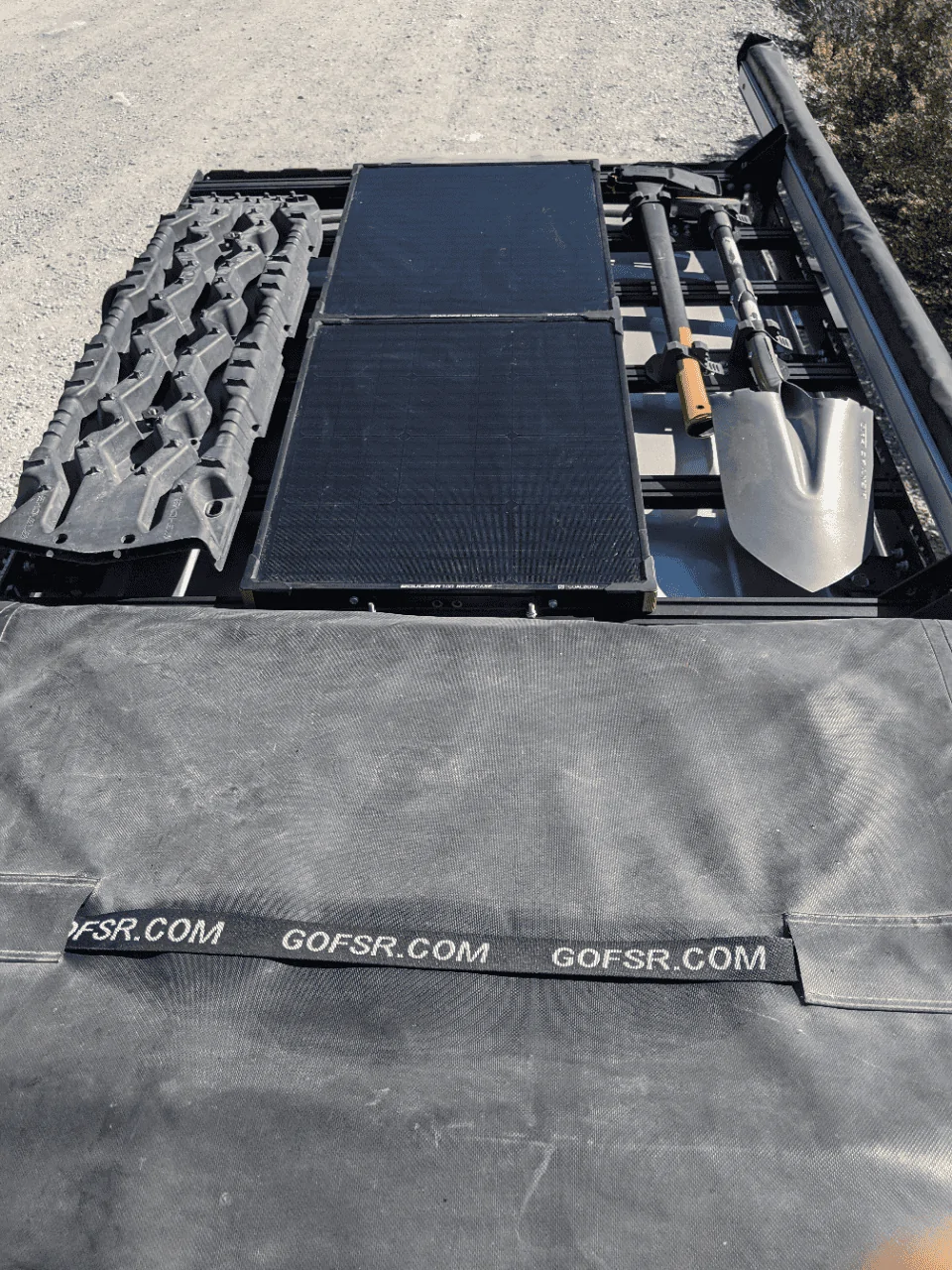

This a pic of the items installed on the UpTopOverland Bravo Rack.
  • ARB Tredpro Recovery Boards
  • Goal Zero 50 watt panels X2
  • Fiskars 36" Splitting Axe
  • Fiskars 44" Shovel
  • OVS 6.5' Awning
I purchased the Awning bracket and the Chop & Dig mount from Uptopoverland. The recovery boards are using a modified Yakima recovery board mount. The solar panels are using a bracket that I cut down to size and drilled out. I had to rewire the panels due to the cables being to short to fit in this orientation.
Thank you for sharing! You did a great job in the realization of your project! And it looks like a survivor's starter pack. Appreciate Fiskars's stuff( I got this baby)
Cheers!

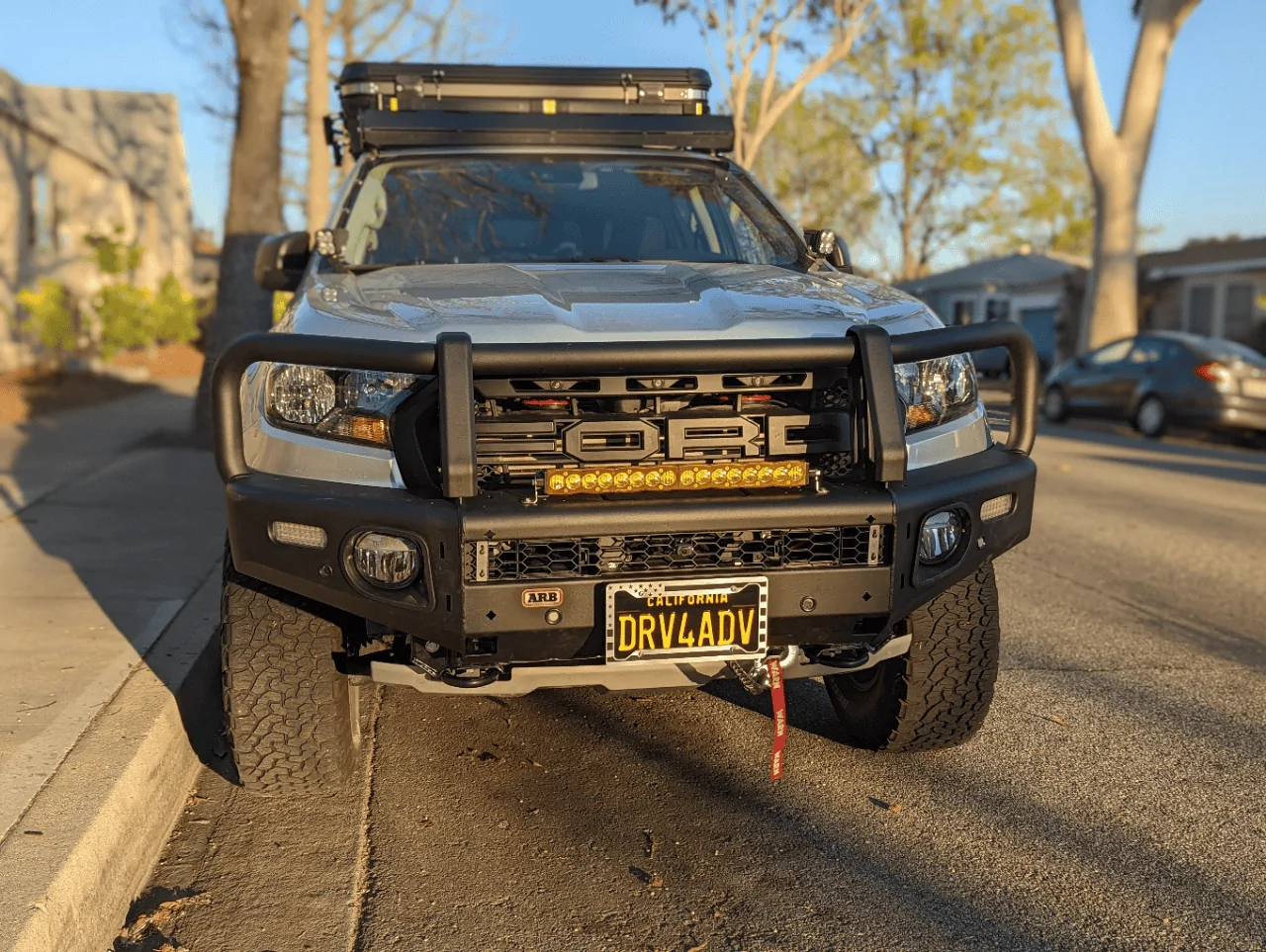

Thanks Frank! I need to upload some pictures soon. The Truck looks entirely different from my last post. The tent has been mounted to the Smartcap for months and I have rearranged the UpTopOverland rack to better suit my needs. The biggest change is I have installed a behemoth front bumper. It's the ARB Summit and it's heavy. The winch I have mounted to it only makes it heavier.

I think I spy a corner of that SmartCap! Looking forward to your updates - between your ride and the Stage3 overland ranger, I've got some inspiration.
I think I saw in another one of your posts that you're running 285s - how was your experience regarding the crash bar? Any modifications required?
I am running 285/70 17 but may go up to 285/75 17 at some point. 33" to 34" while keeping the same width. Minor difference but does help when offroad.
Crash bars were removed. Had to in order to fit larger tires. I feel better about it having that huge bumper up front. I know that is a highly debated topic. I would not go smaller tires with the offroading that I do. However, my fuel economy has suffered. Gearing is fine for 33's. I would consider regearing for 35's though. Not quite worth it for me. If you want to keep your crash bars I say trim the existing ones or try and fit aftermarket options.
I want to swap Eibach springs for a heavier spring rate. I am having trouble finding the correct length. The front squats too much with the standard Fox 2.5 coilovers. I can't find the spring rate either but will probably go with 650 or 700lbs. Bumper + Winch = Sag.
Hope your build comes together nicely.

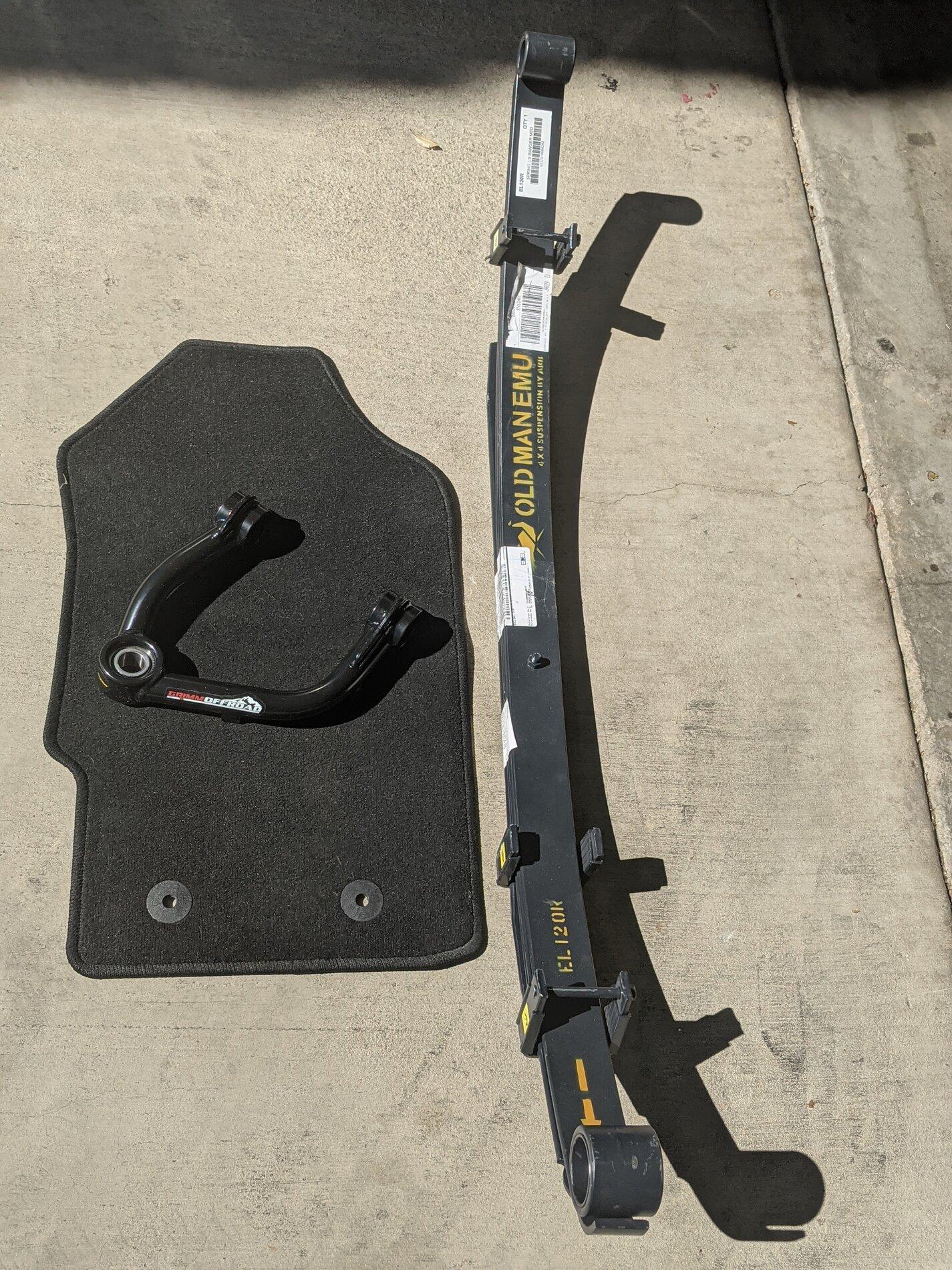

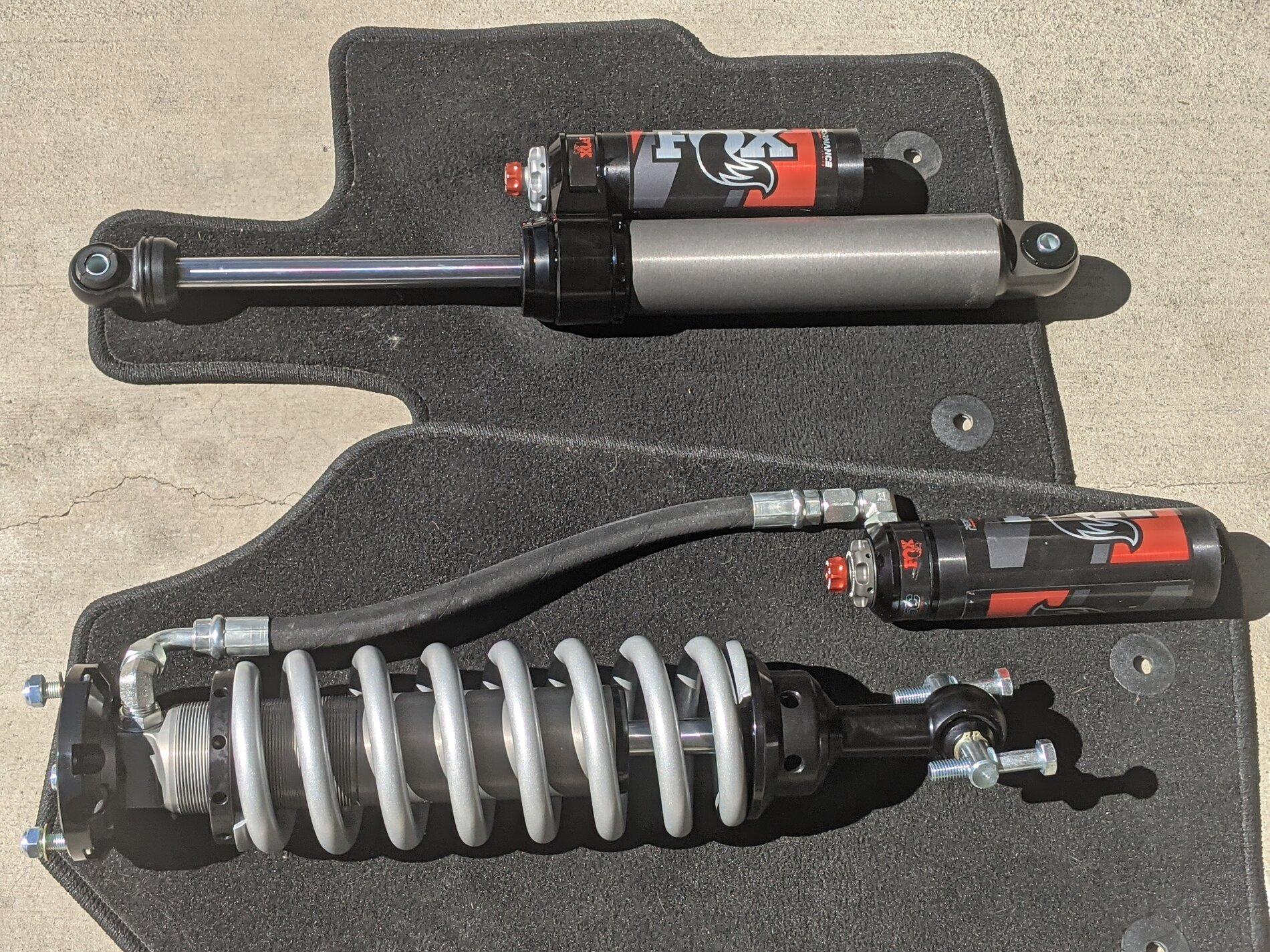

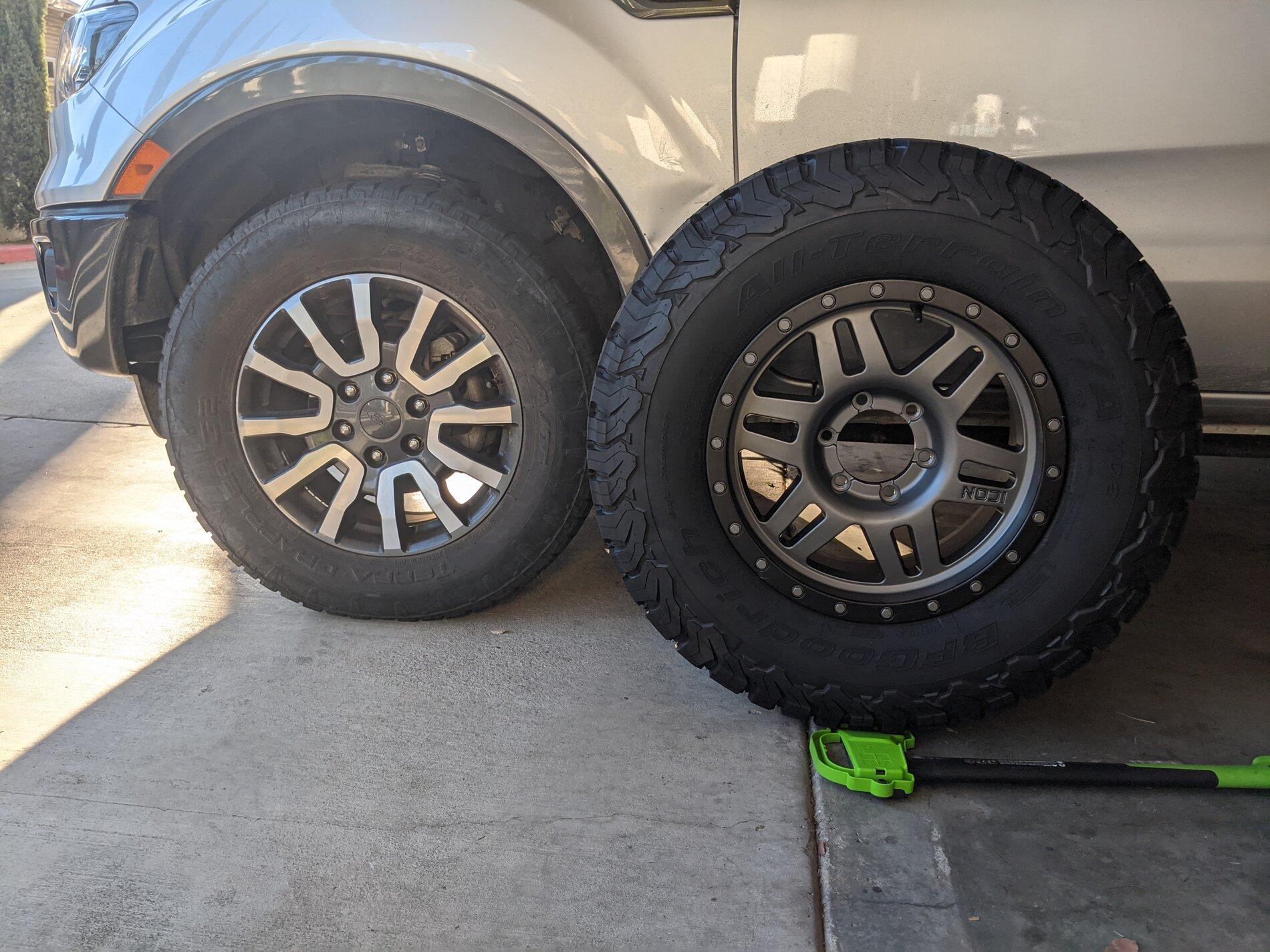

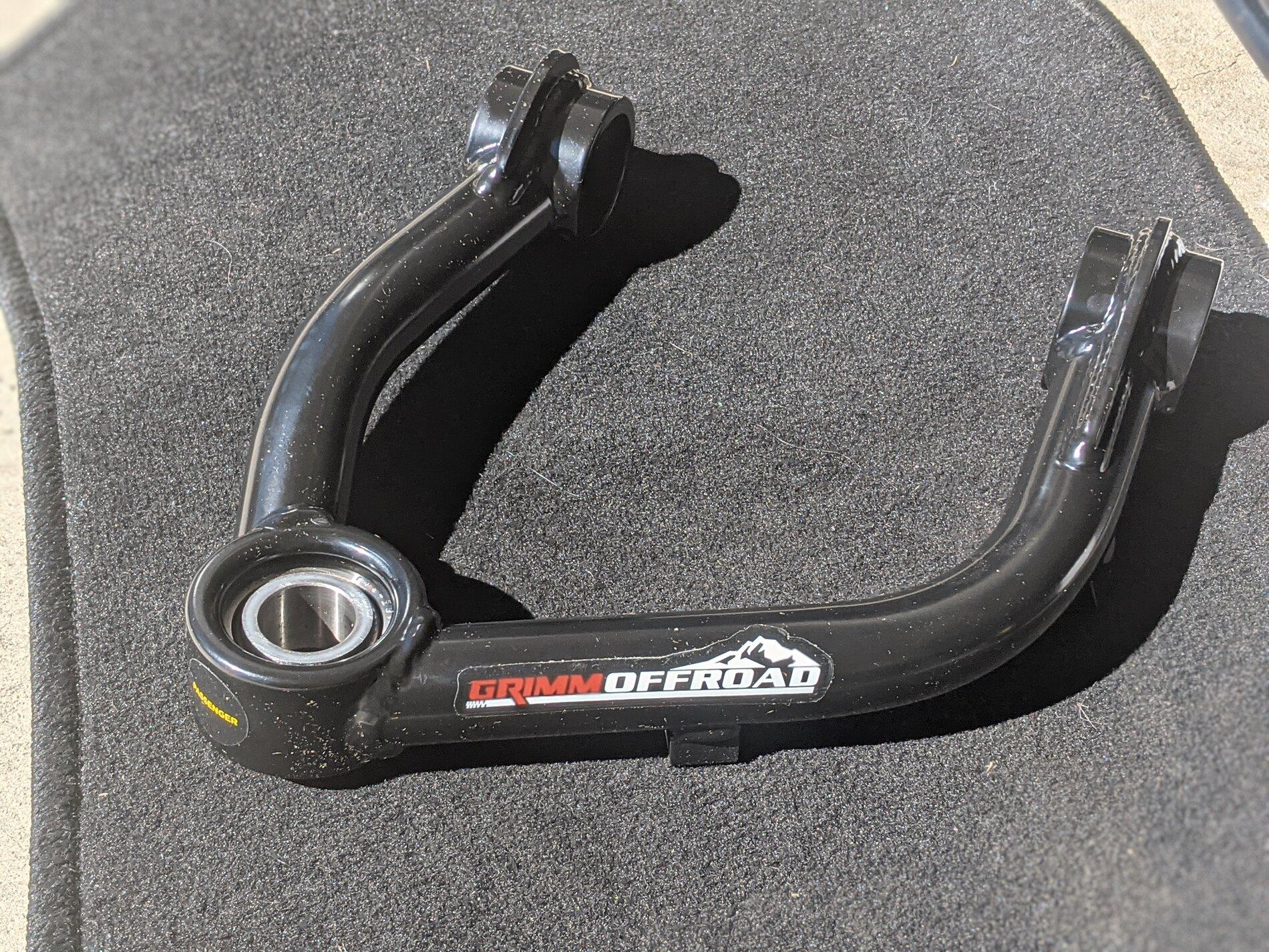

So after months of waiting on parts, Covid shutdowns and all, I finally received everything that I ordered back in November.
The list is as follows:
  • Front - Fox 2.5 Coilovers with DSC Reservoirs
  • Rear - Fox 2.5 Shocks with DSC Reservoirs
  • Old Man Emu Leaf Springs (Medium Weight)
  • Grimm Offroad Upper Control Arms
  • White Knuckle Offroad Rock Sliders
  • Baja S8 20" Lightbar
  • Icon Six Speed 17" X 8.5" Wheels
  • BFGoodrich KO2 285/70R17 Tires
Fox 2.5 DSC's Front and Rear
Grimm UCA's
OME Leaf Springs
Wheels and Tires. Significantly larger than Nitto's that came with the truck.
